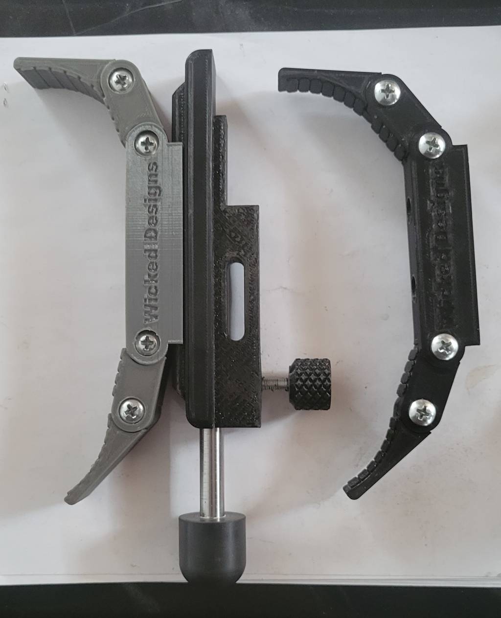

Depends on what filament was used. I do a ton of 3d printing. The vertical stacked layer lines, means the part was printed in the proper orientation to make a strong part. Next would be what the infill amount is. Surface finish looking as it does leads me to believe the person is printing way too fast. That could cause layer to layer adhesion issues and weaker part.
You bring up a topic that i think should be discussed ( another topic like 3D printed parts basics for consumers?) to inform those that don’t know jack about 3D printing and some tips on what to pay attention to, but from a buyers perspective. Might go sideways with 3D printers’ arguing, but the consumer would have some knowledge about the materials and procedures.
got mine on ebay from over the pond nice stuff got it fast aslo
The outside of the part is just a textured applied using the slicing software. It's called fuzzy skin I believe. It's done to add grip or feel. I use that texture on parts I want with extra grip.
A buddy of mine got one of those for his Prophet and loves it.

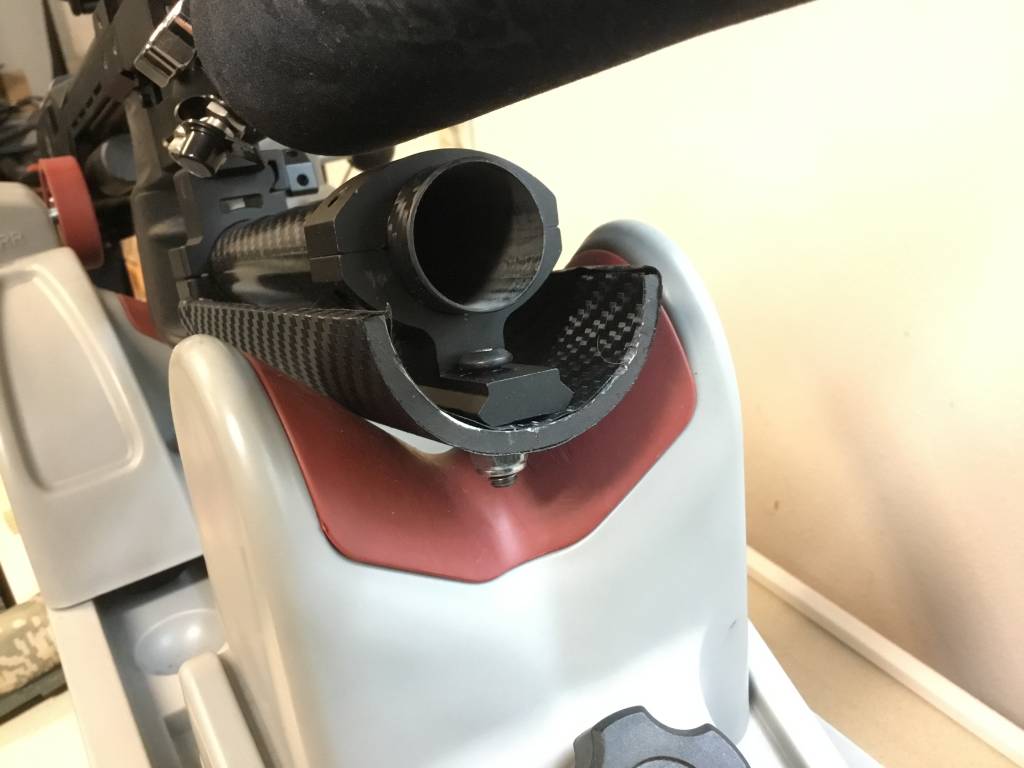

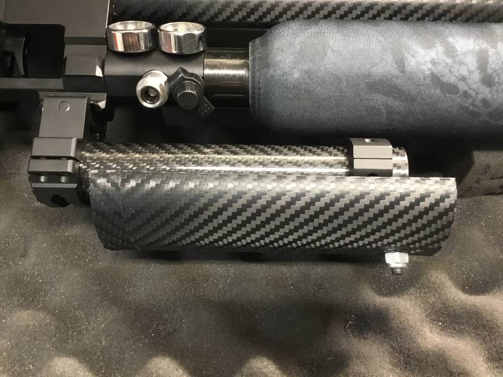

I made this using a piece of 30mm CF tubing, a Leapers mount, a Monsterum mount with a pic rail cap, a piece of 2” PVC cut lengthwise I dressed with faux CF tape.
I tapped the pic rail cap so I could install a bolt through it and the PVC to hold in place with a nyloc nut.
Remove the nut and I can install my bipod to the pic rail cap forward of the existing mount giving a much improved balance point.
With the PVC in place, it makes a great resting point for shooting sticks by not putting an undue weight load on the bottle and it also makes shooting offhand a breeze.
