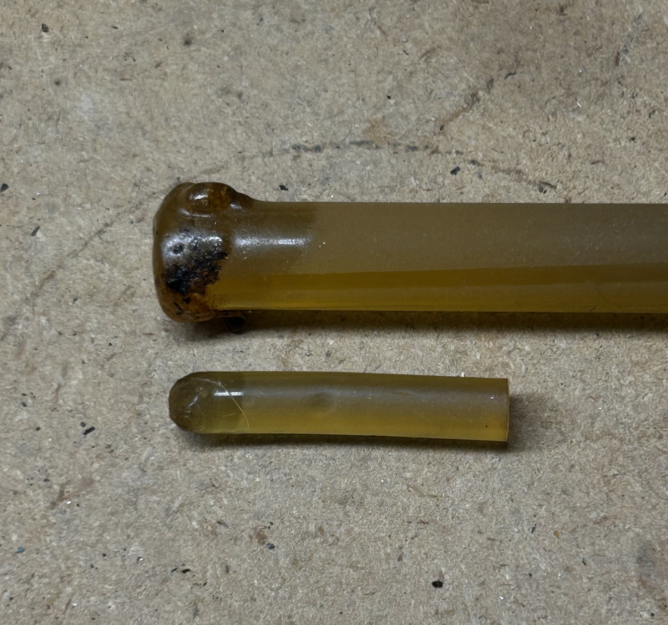

A good metal to metal or metal to carbon solution for a non-permanent bond for the hinge pin to hammer might be point insert "hot melt"..an archery product that's easily removable with low heat but is capable of withstanding repeated impacts.
