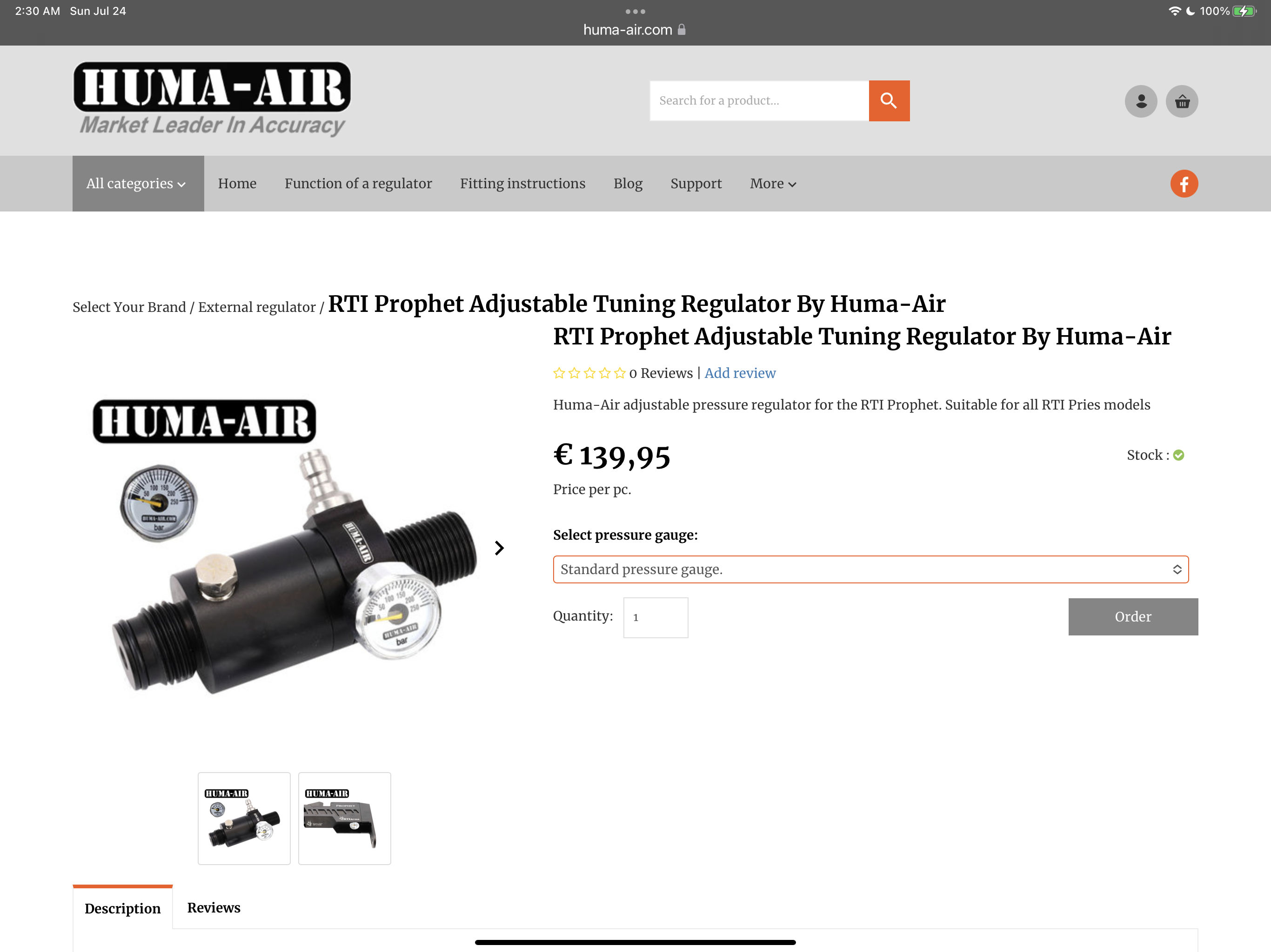

So I pulled my hammer and thought about adding some weight to it since I was using alot of hammer spring to reach my goals. The hammer felt a little light compared to some of my other guns and decided to add some weight. The hammer has a small aluminum spacer in there and I took that out as it does nothing. I had some left over grade 8 screws that had only half the body threaded so I cut off the threads and poor man lathed (loaded screw in the electric drill and ran it over a file) off the hex head to fit inside the hammer. First screw was about 110 grains of weight, the second was shorter and about 83 grains. When I took my butt pad off I noticed a lot of hammer spring preload to reach my velocity goals. I have a Huma bottle reg on with my RTI reg, ala FX impact style. Huma reg is 140 bar, RTI is 127 bar. I have the newest RTI reg guts that are back to the thin washers. This is so I can reach 95% of my max velocity giving me 880 fps with 18 gr pellets.

I’ve done the same with my Priest 2, using door hinge pins I’ve made a couple different weights and will add if I up my reg pressure. I have the coil spring style replacement reg, and it’s worse than the original one it replaced. I think I’ll get the 145 bar fixed reg next. How did you get your new reg? I already received a free replacement, which is crappy, I doubt I can go to that well twice…

I replaced my adjustable reg with a 145 bar fixed reg on my prophet full size awhile back... best thing I ever did. Thinking real hard about changing my compact to a fixed reg also..
