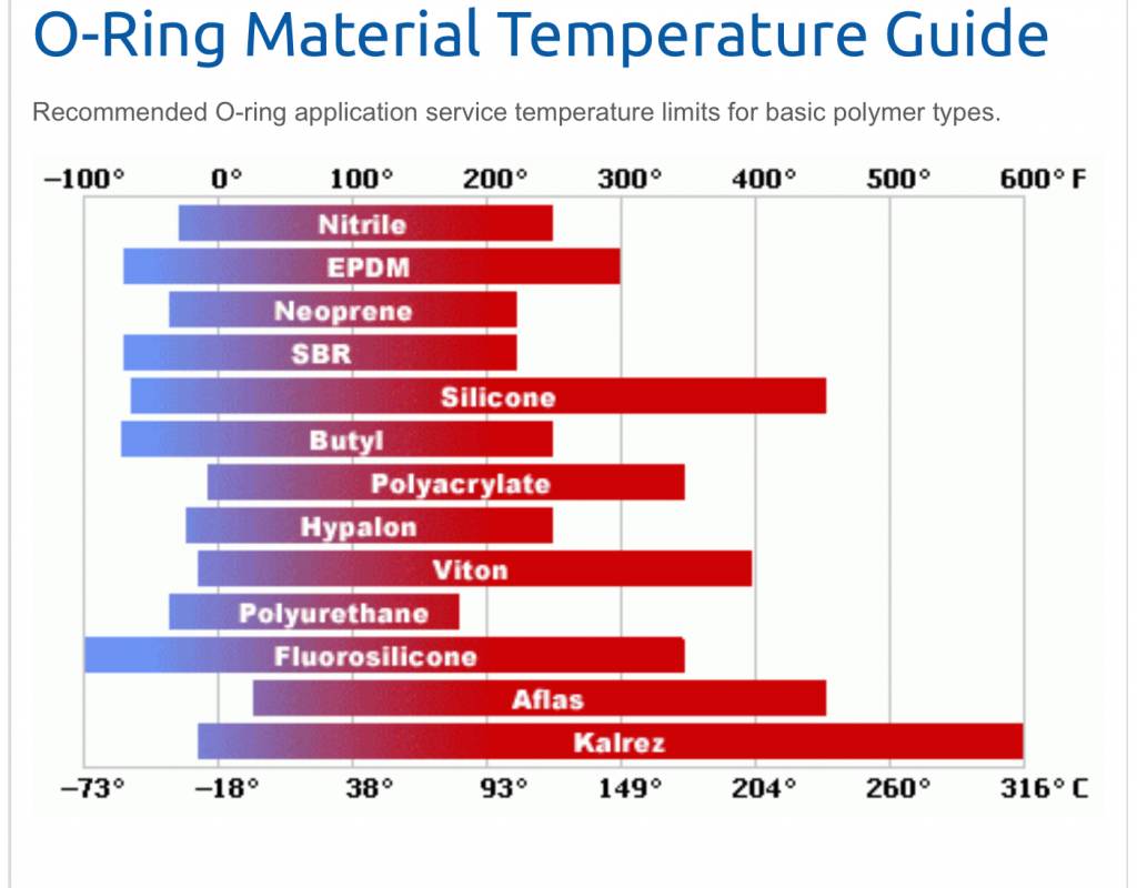

I shoot year round up here in the great white north. Yesterday was 32*F , right at the freezing point. Shot three magazines before going out fo a hunt , had zero issues . This was with the Evanix air speed in .25. Today was 14*F and was using the PP750 ,I put close to 80 shots through the gun and again had zero issues. Here’s a chart I found online. Most orings should do just fine in below freezing temps.
As far as powder burners go again , no problems with the guns . Any changes will be with the optics. That’s why military recommend open sights in freezing temps.
