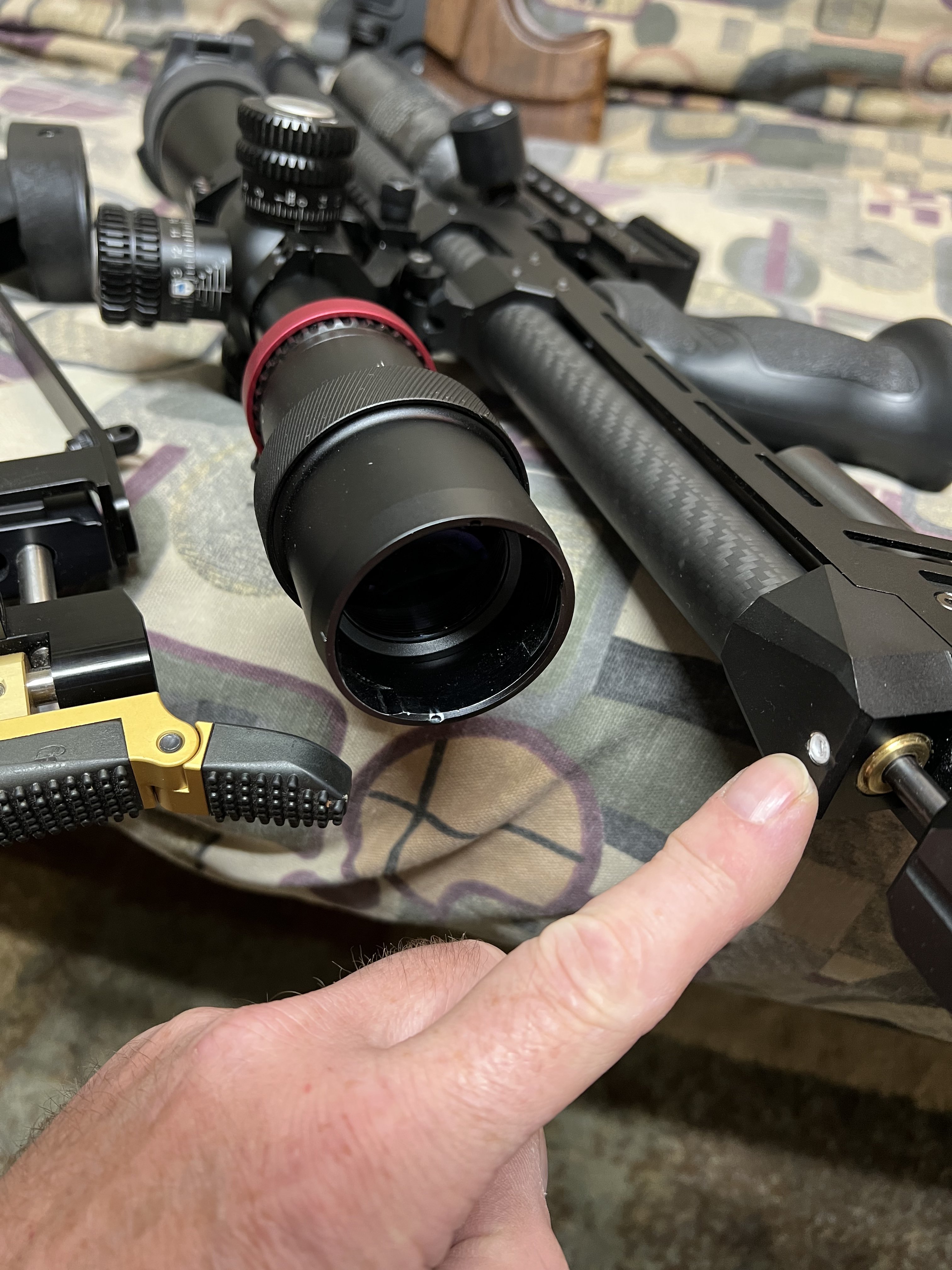

Hey Matthias, I’m dealing with the same thing on my .22 Prophet Performance. If I crank it up to send Monster redesigned at high speed, I get sandblasted in my bottom eyelid. I can’t believe this is normal, probe is pretty loose in the bore, even with a fresh o-ring. I will check the barrel o-rings next, as they are pretty thin and see a huge pressure pulse.
I shoot pretty high pressures when shooting 33.95’s. The tape is necessary.
