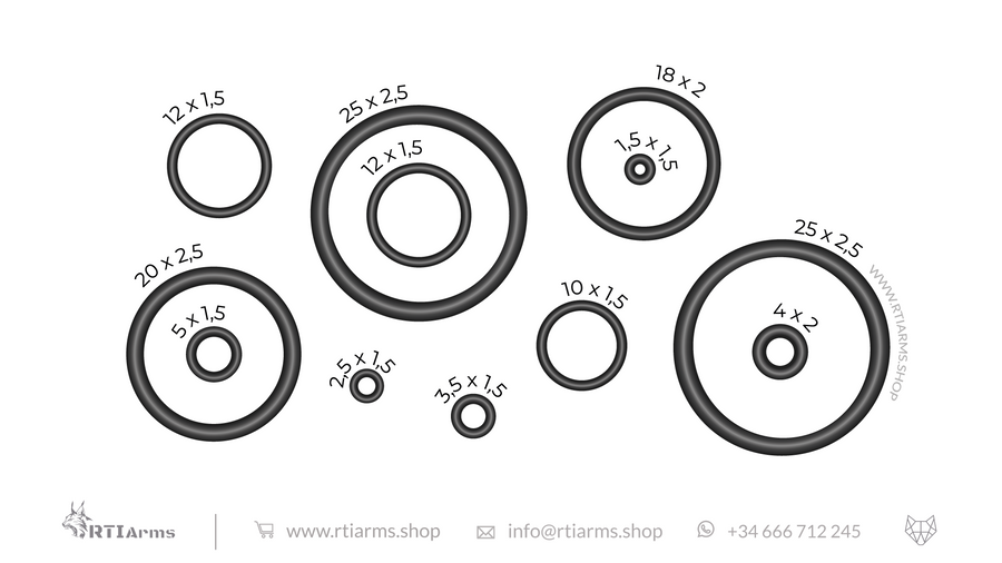

🔸Instead of the Impact's 30 o-rings, the RTI has 7* (seven) o-rings.
*[Correction: 6, and for performance version: 15👍🏼]

We need to depunk the myth that the RTIs have only 7 orings. I made kits based off the schematics and there are way more sizes than 7 when you include the gun and reg together. Now RTI may only list seven in a kit as they feel those are more likely to fail, but there are definately more rings than 7. Some are so close in size that they get difficult to tell apart.

So how MANY are there ????

That doesn't even include the reg orings and the large 25x2.5 is not even used anymore. There are no under gauge orings 3x3 in that kit. They should really update that list to what they use now.
If you have the fixed reg then yes the gun only has 6 different orings. If you have the performance adjustable reg version then you add 5 more sizes and 9 more orings.

That aside. The 7 ring myth, debunked.
