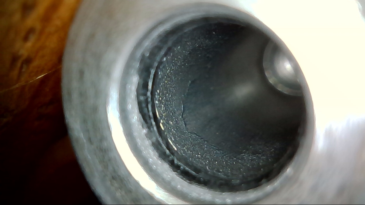

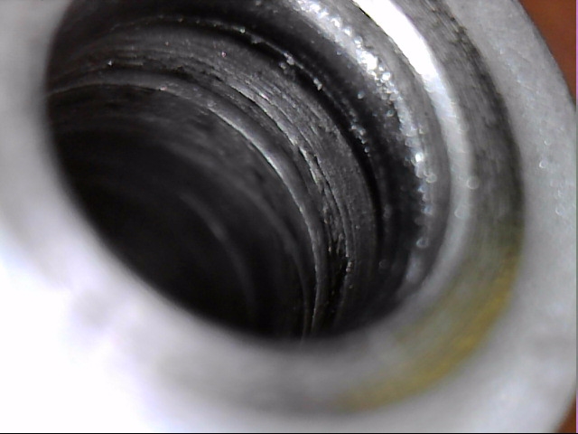

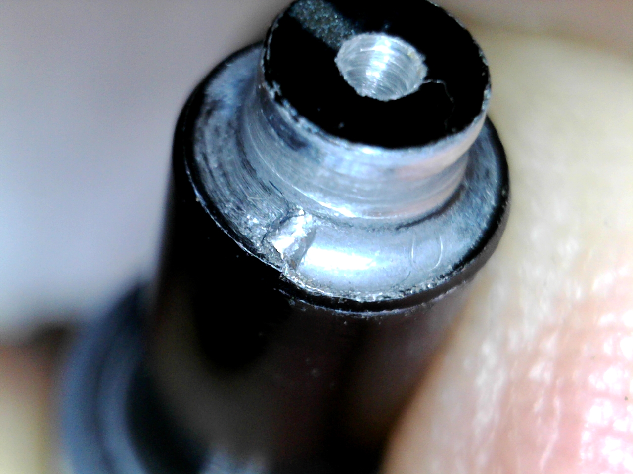

The spring inside the balance tube has sharp ends and eats its way through the back of the aluminum valve. The debris from this accumulates inside the tube and prevents free movement of the valve. Unfortunately the new valve assembly still had a razor sharp spring end against aluminum so it will probably happen again.
My spring did the same damage to the valve. I took the rough edges off the spring and also polish the spring. This helped but the spring still scared a new valve.
