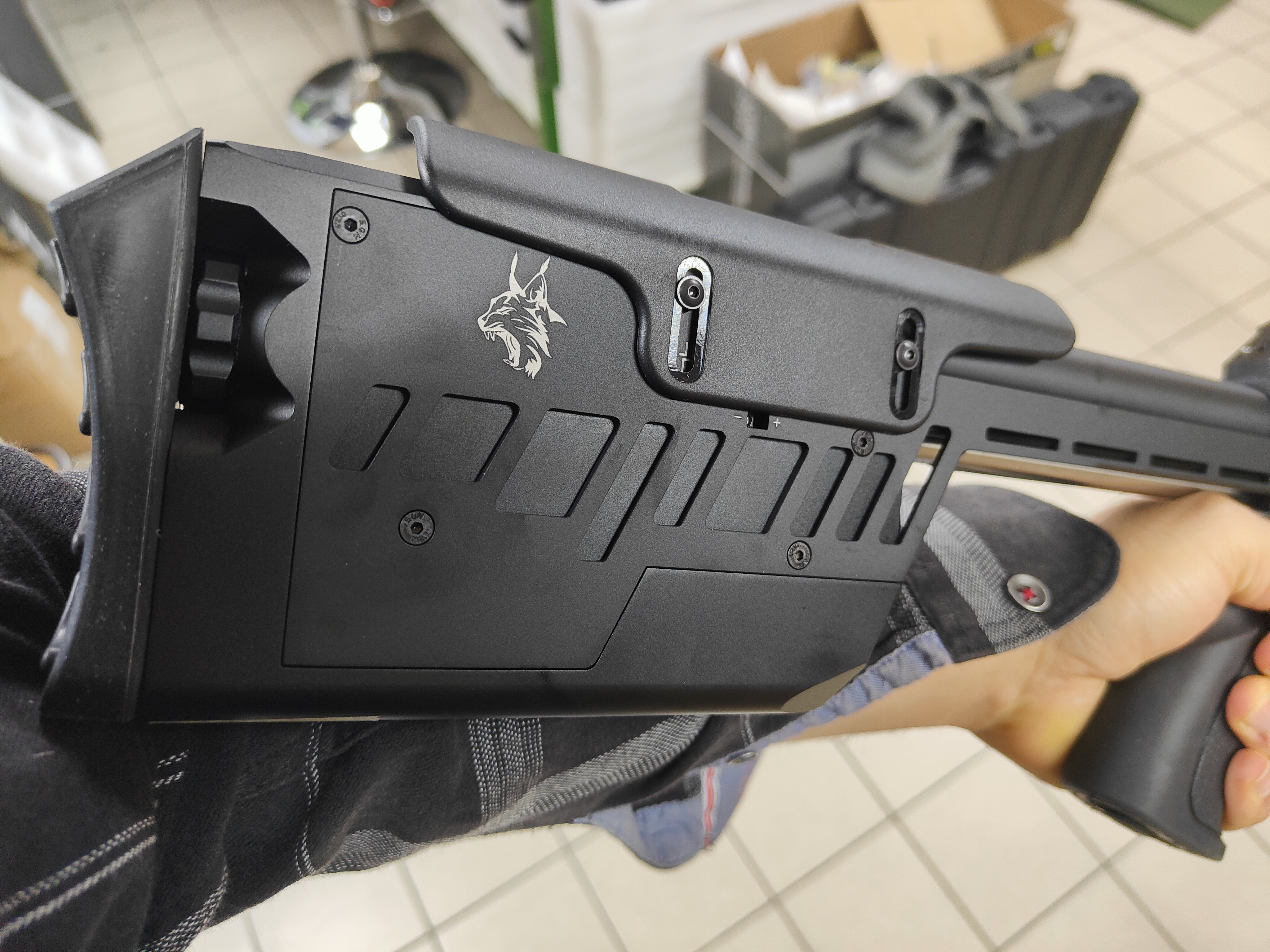

First thing that catches the eye is the adjustable cheek riser

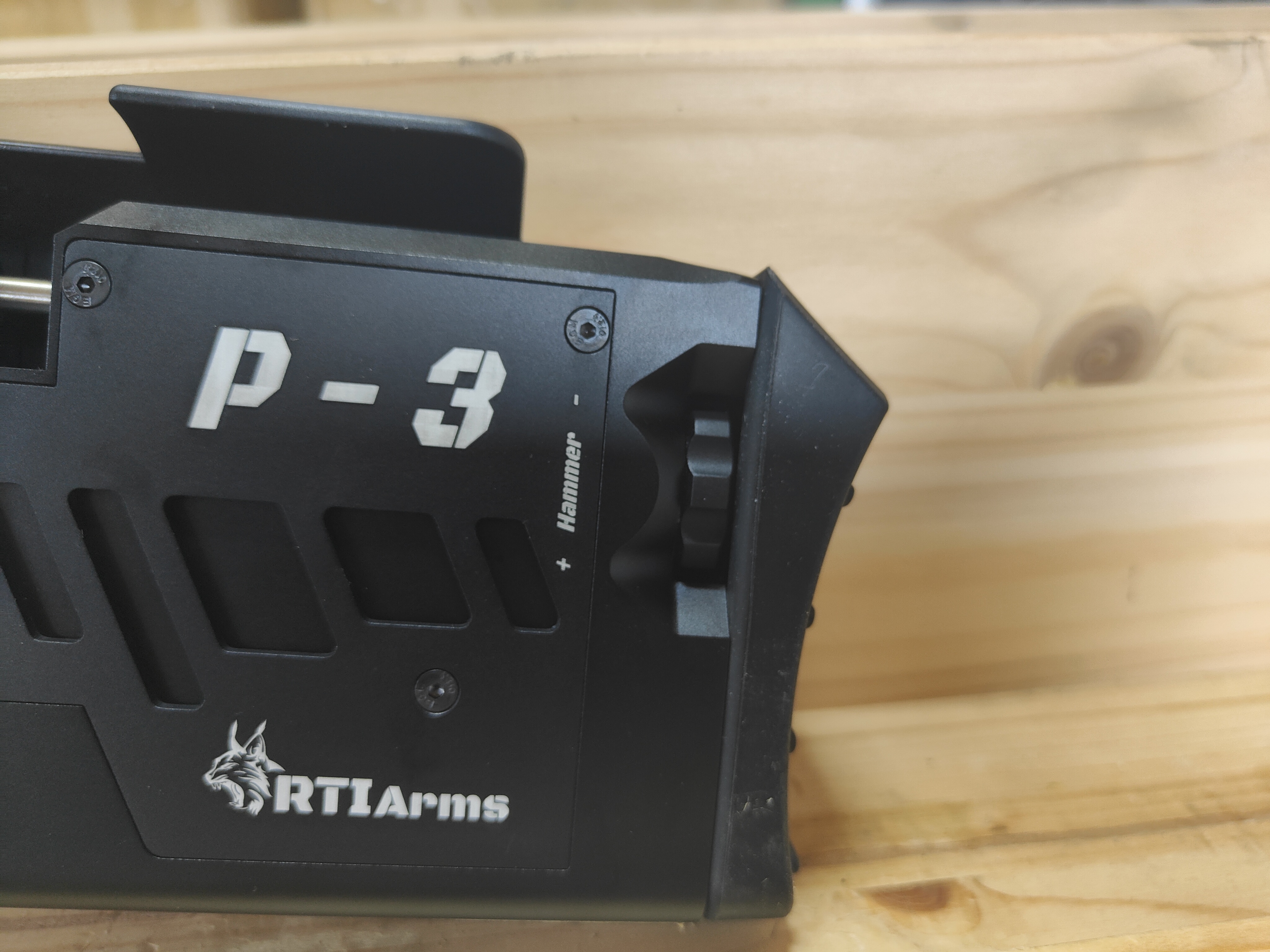

and the hammer spring wheel.
I installed the cheek riser on my Prophet 1 also, but it is not plug'n play.
Cheek riser is quite sturdy, doesn't flex and can be adjusted up and down with a 2mm Allen key.
About the wheel, it works great, with small steps and strong, audible "click". Ccw to increase the tension, cw to decrease it.

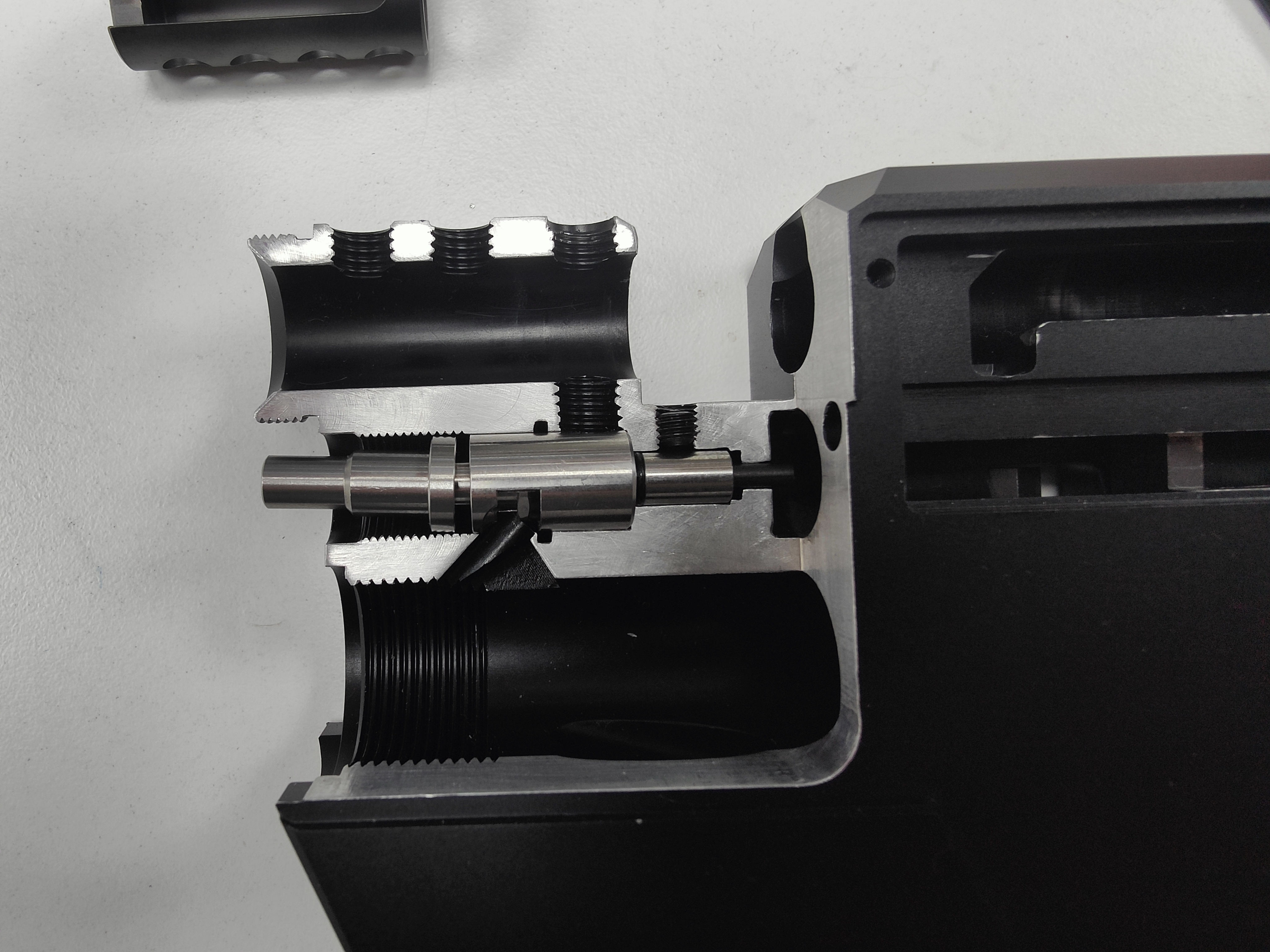

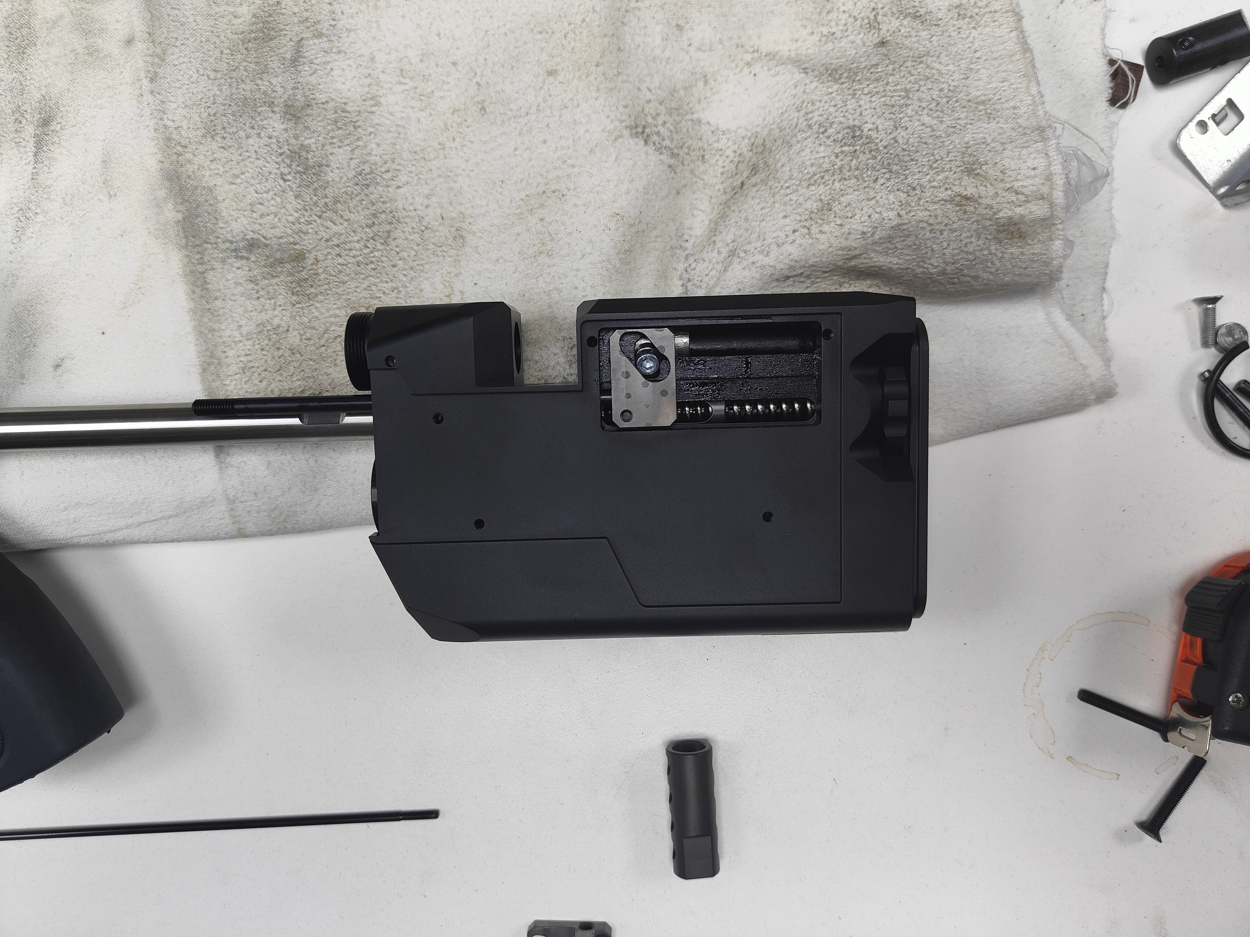

I also had the permission to strip off the gun and look inside.

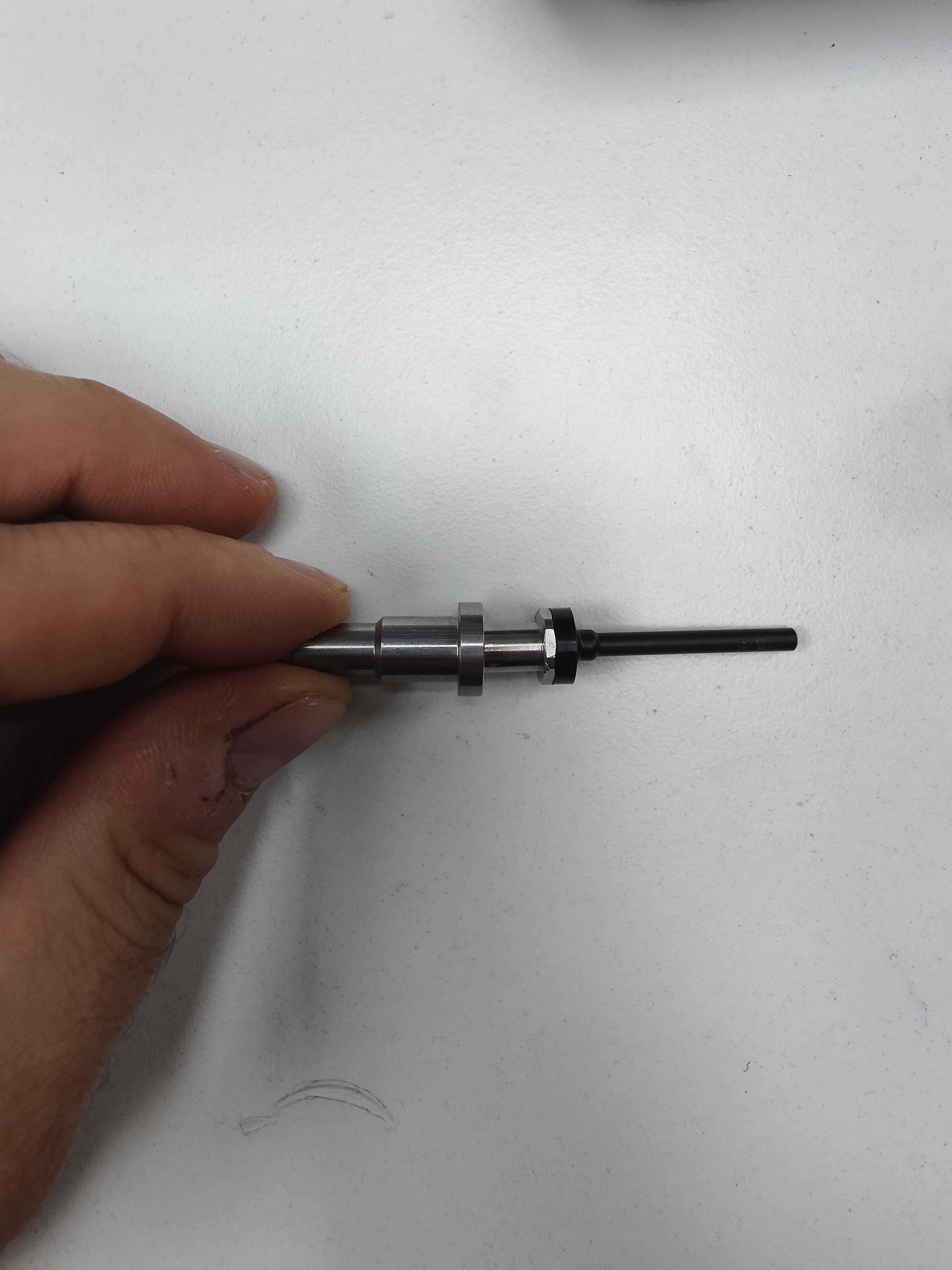

And yes, they worked a lot to improve the (in)famous Prophet 2. New valve (always a balanced one, of course) new valve pin, new valve seat, all stainless steel.
All that will be compatible with the Prophet 2, so good news for the owners that had issues. There is also a not so visible OR that will help contain those small guts of air while shooting (easy to feel them from trigger's setting holes and hammer channel).
Talking about hammer, they completely changed the cocking forces distribution.
Now the spring works way better and easier, not a mind blowing upgrade but solid improvement.

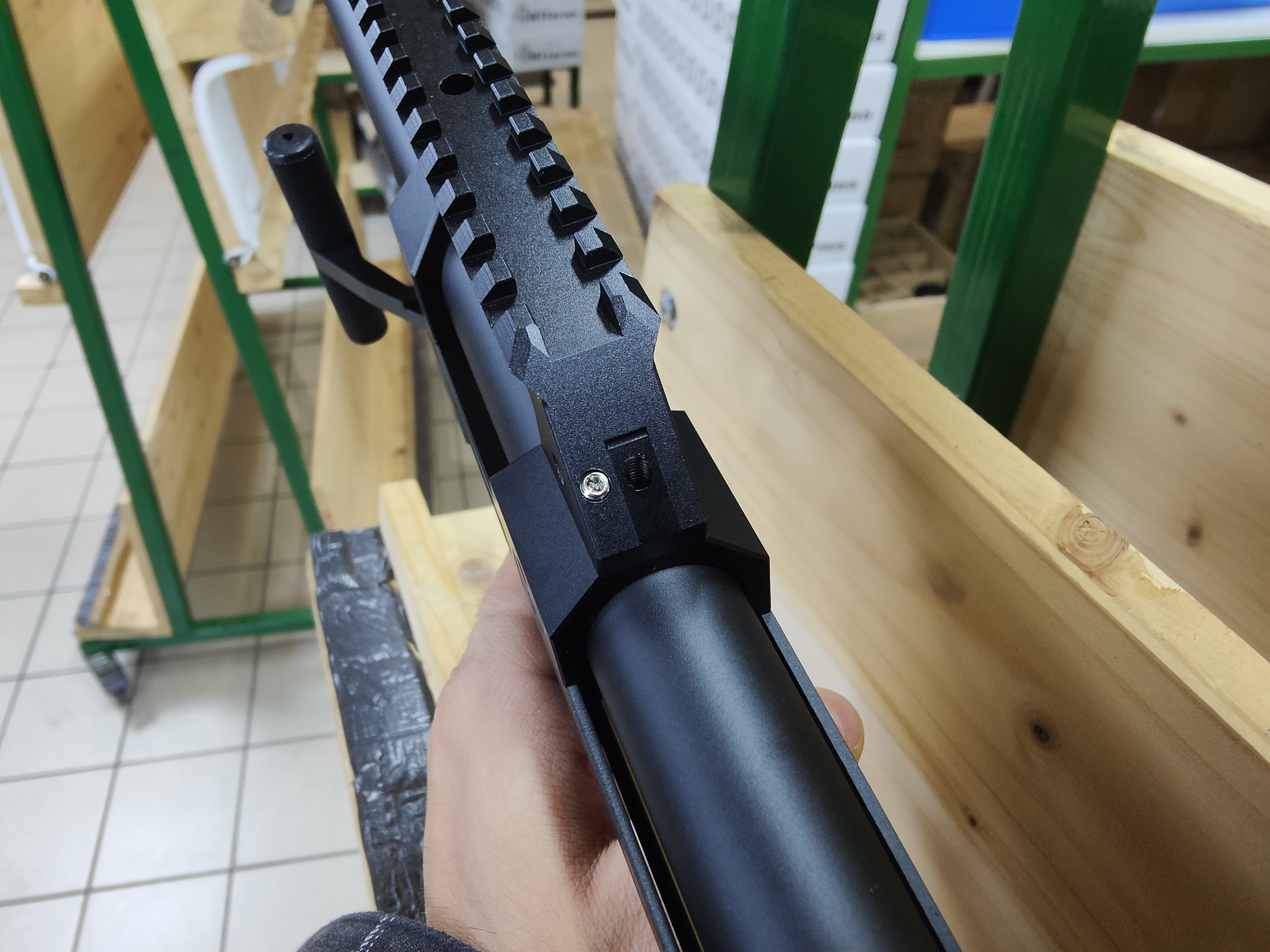

Last, but not least, they installed an adjustable optic rail (vertical only) from 6 to 150 MOA.
