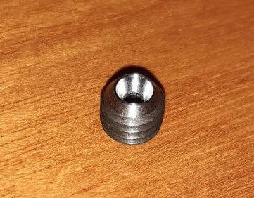

View attachment 335864 Transferport

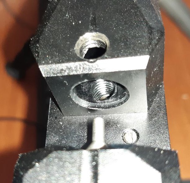

View attachment 335865 Restrictor

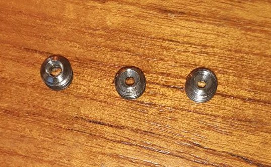

View attachment 335866 View attachment 335889 3mm, 2.5mm, 2mm
I like the 3mm. Can adjust to a lot of power and stil shoot 7.1 gr at 80 bar. The new valve is more for high power. The speed is set with the regulator. Maybe there is a way to adjust the transfortport from the outside if you want more adjustable low power. On the other hand, I like high power. Here are some results.
3mm port, 80 bar, 7.1gr, 970 FPS
3mm port, 80 bar, 10.49gr, 860 FPS
3mm port, 100 bar, 10.49gr, 920 FPS
If you want to shoot .177 light pallets use a 2.5 mm restrictor.
If you want to shoot .177 fast use 3 mm restrictor.
