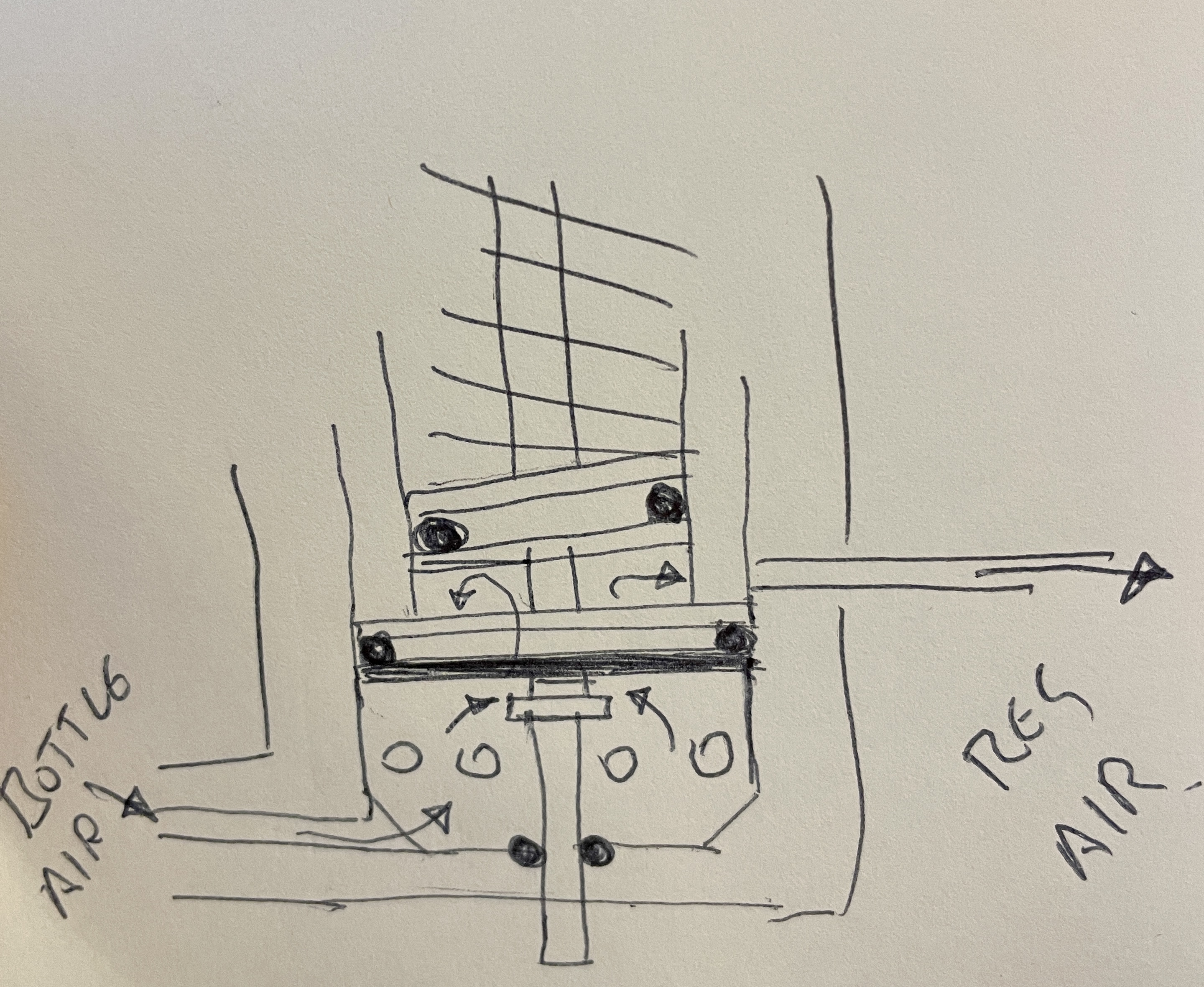

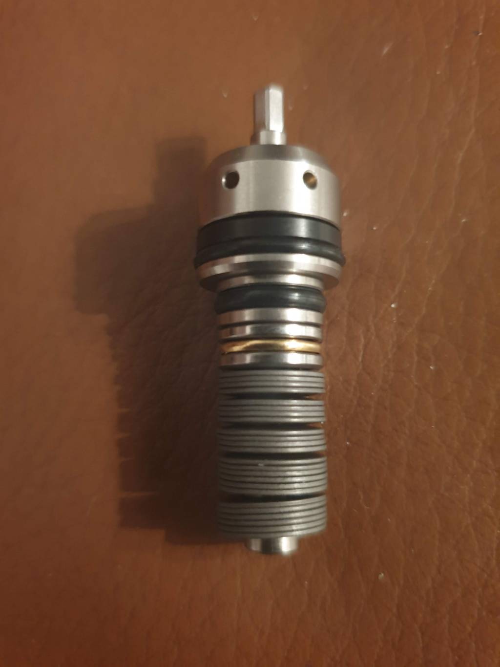

I think the small shoulder on the main shaft pushes against the plastic disk. It gets pushed away by the spring when the pressure in the “middle area” is too low.
I will strip it down again and give more attention to these surfaces. I think if the leak was someplace other than here, it would just keep on increasing until reg = bottle pressure.
Nervoustrig, I’m not sure the assembly will turn, possibly just the adjustment grub screw spins, adding pressure through the springs?

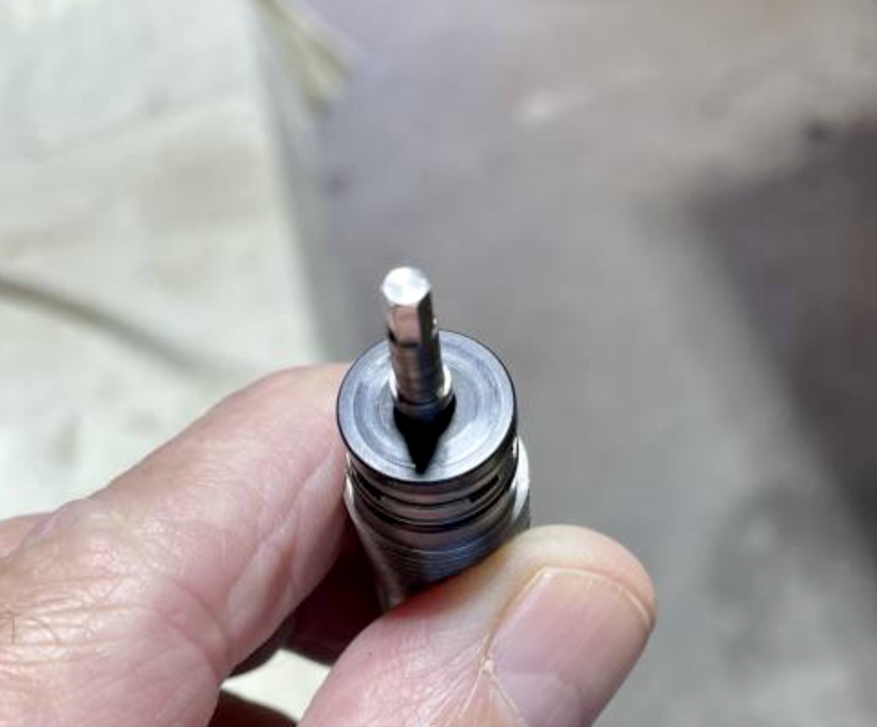

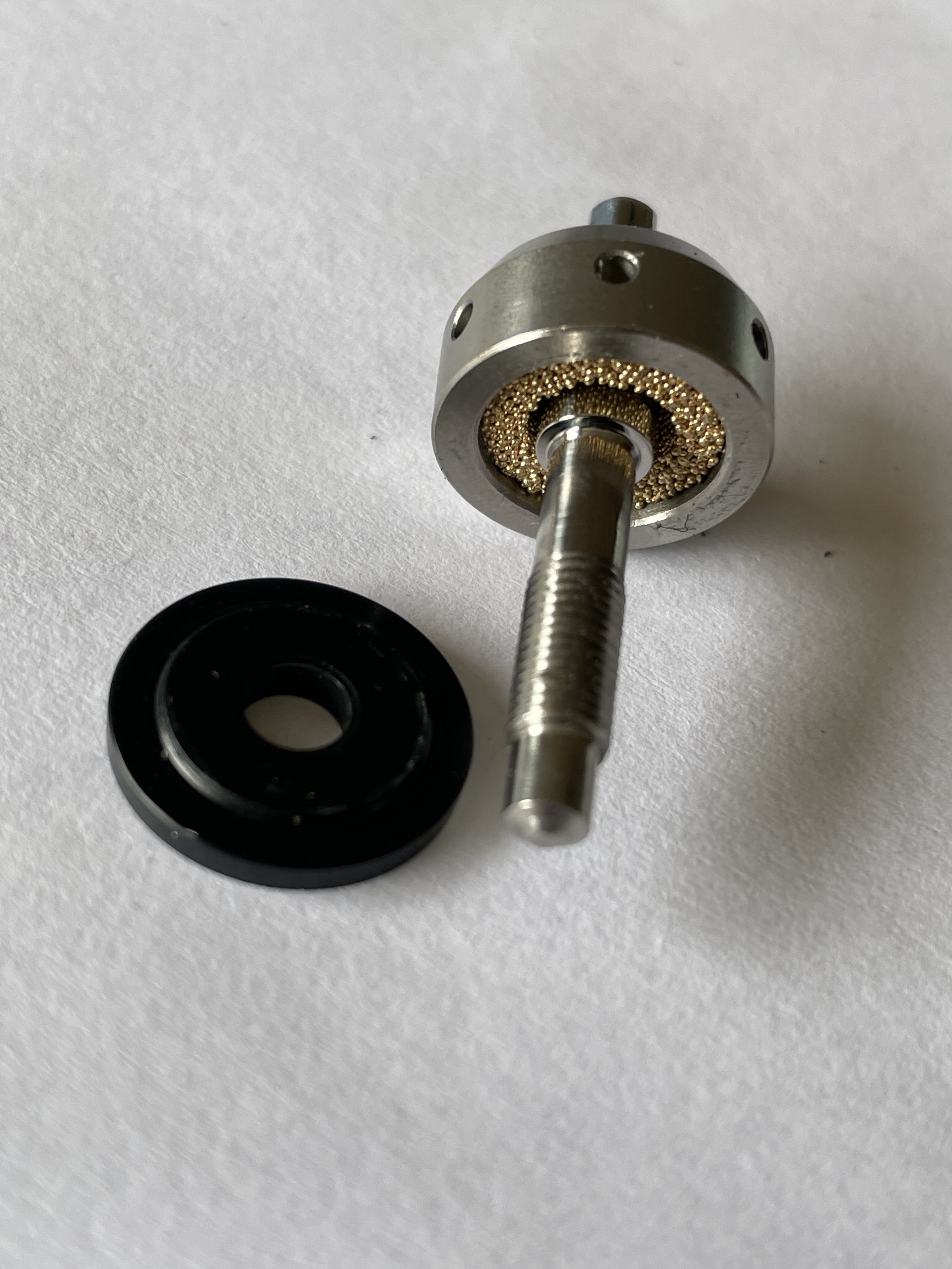

here are a couple pics….View attachment 182188View attachment 182196it looks to me like the seal is only the o ring on the perimeter?
Hey Scotty, after much head scratching I’m convinced the seating surface is the shoulder on the shaft against the plastic disk.

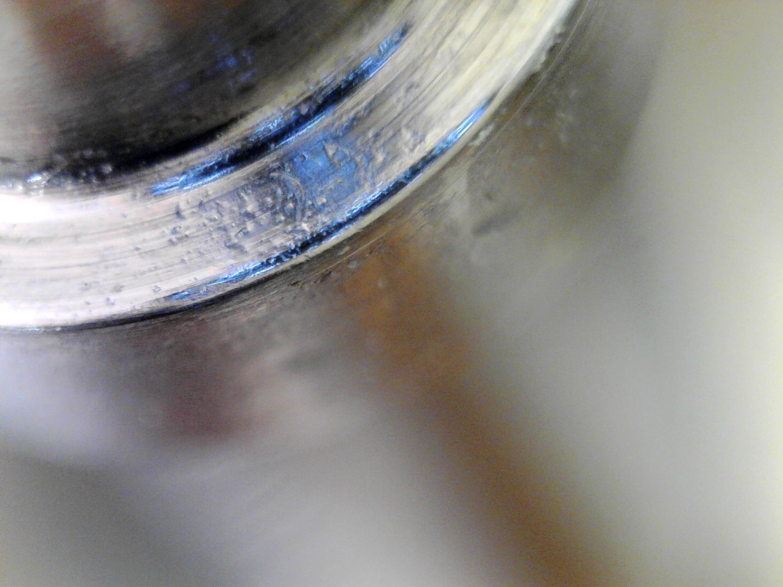

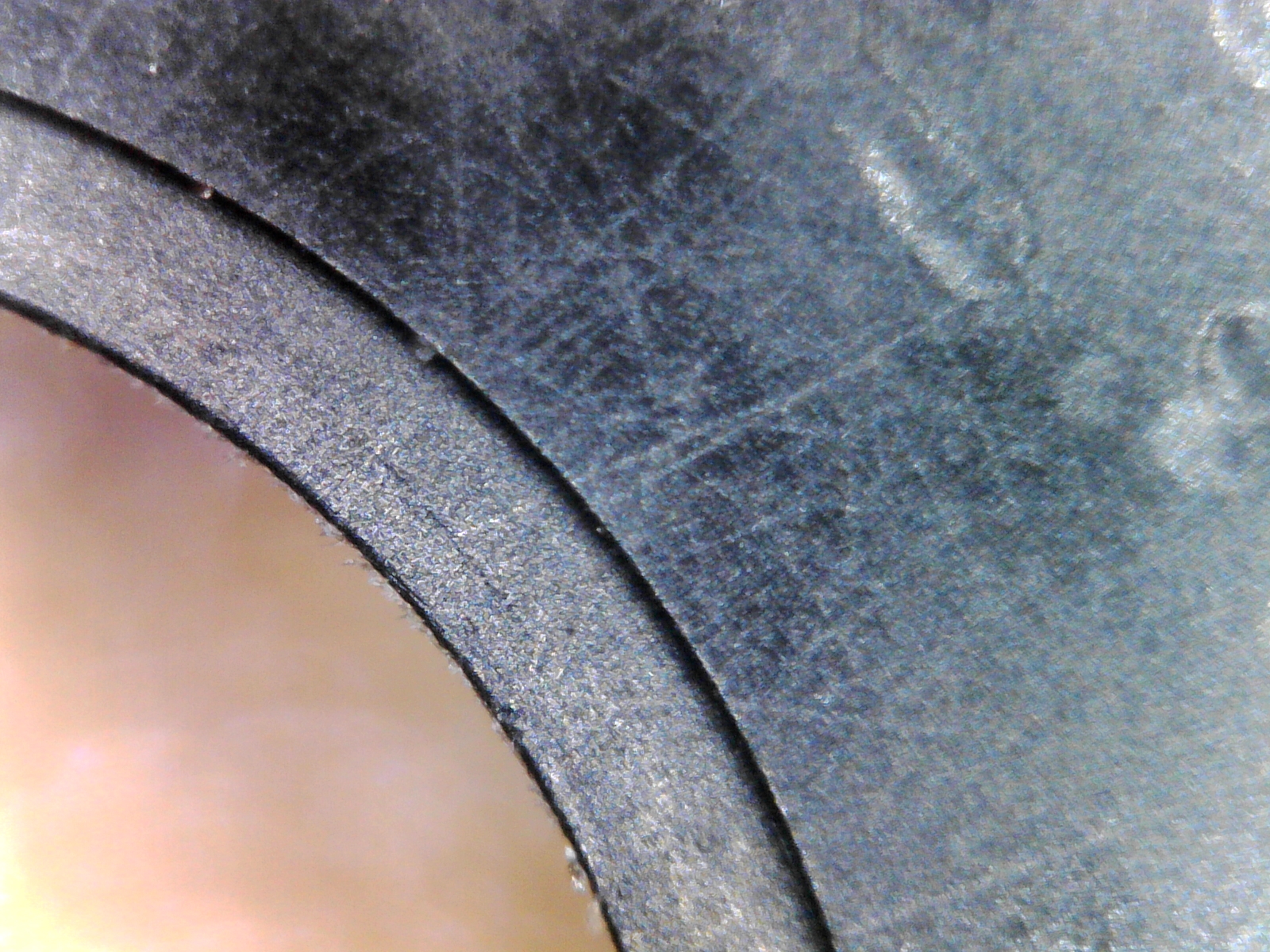

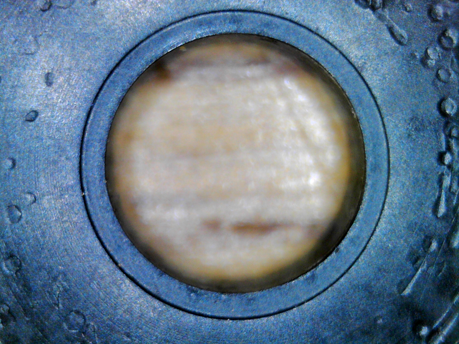

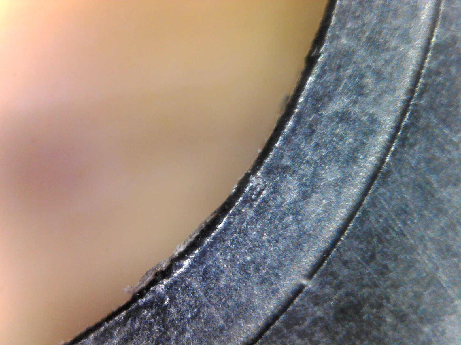

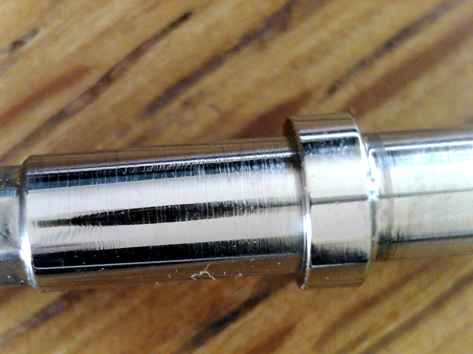

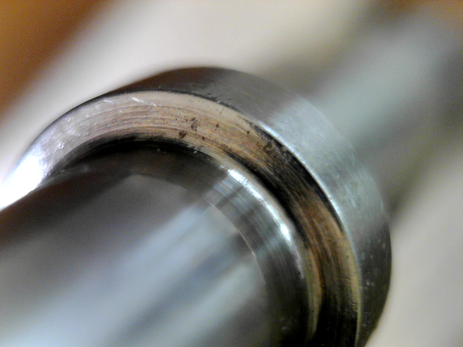

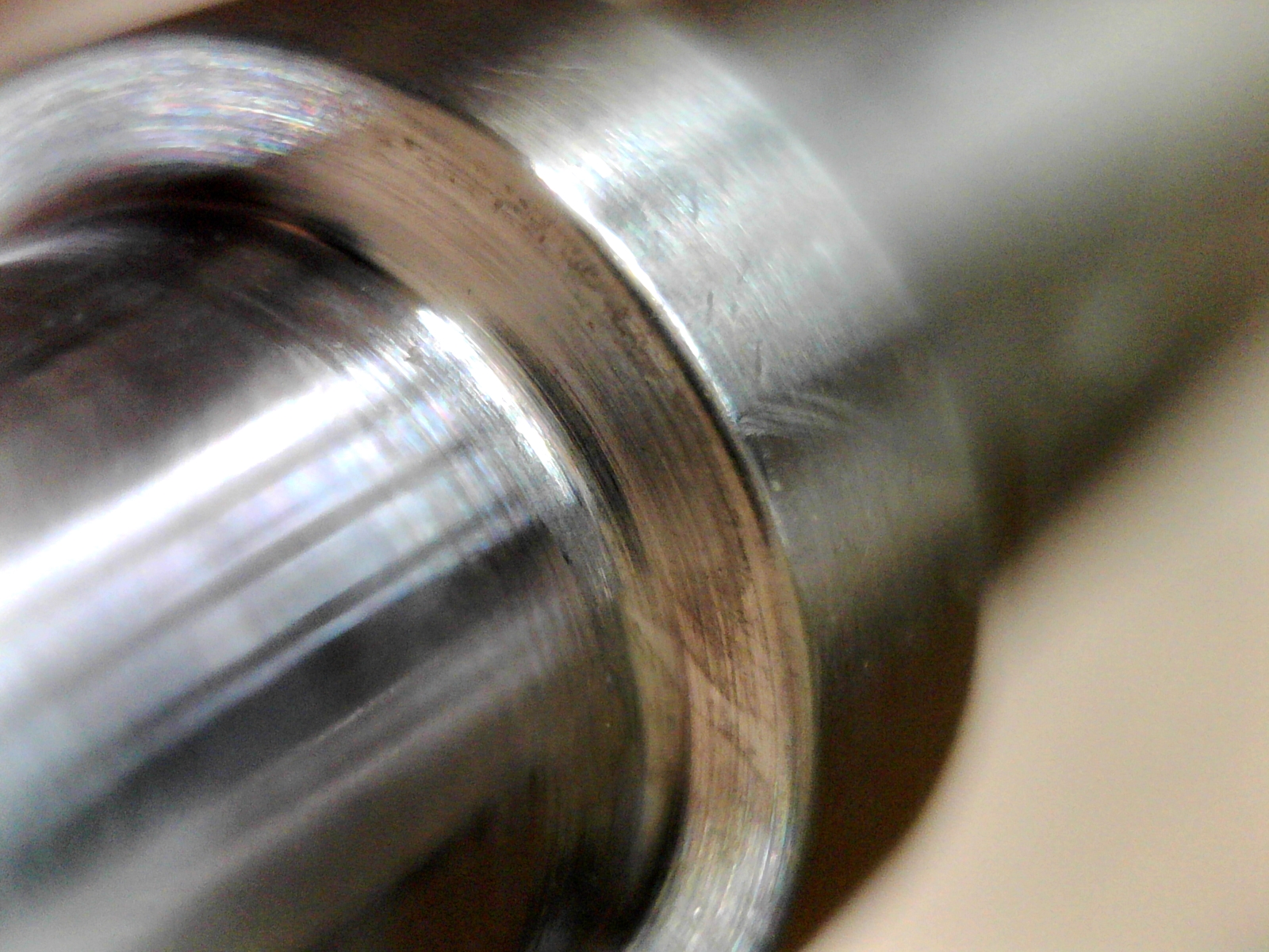

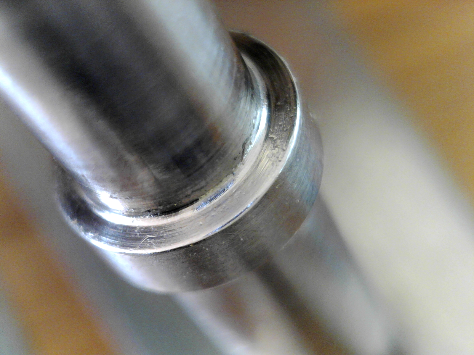

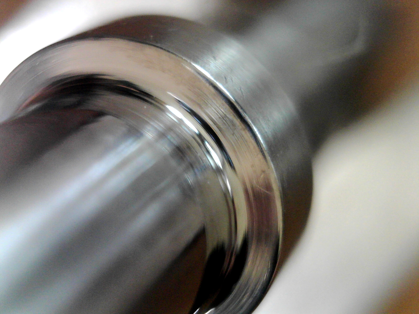

Having figured out how this thing works, I stripped it down again and gave special attention to the two valve surfaces. The plastic disk is recessed where the shaft collar presses. I believe its been pressed in from the force as some of the tiny scratches can be seen in the recessed part. I didn't do anything to the plastic bit this time.
The metal collar part did not look that great under a microscope so I polished it with abrasive jewelers sheets, going increasingly fine. I spun the shaft in a drill and used my fingernail to push the sheets into the corner.
You can see the before & after pics. I also polished the bit of the shaft where the o ring goes.

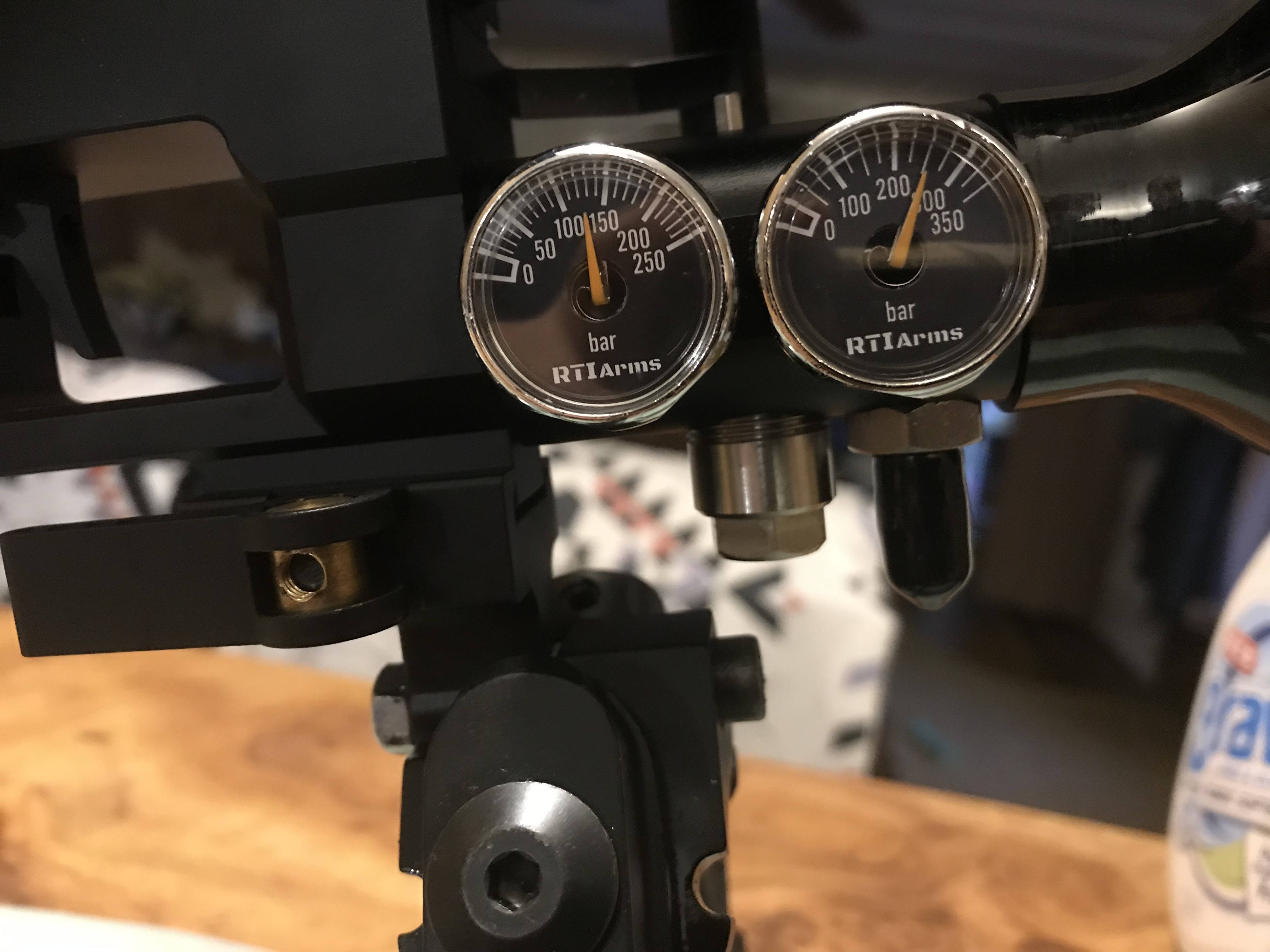

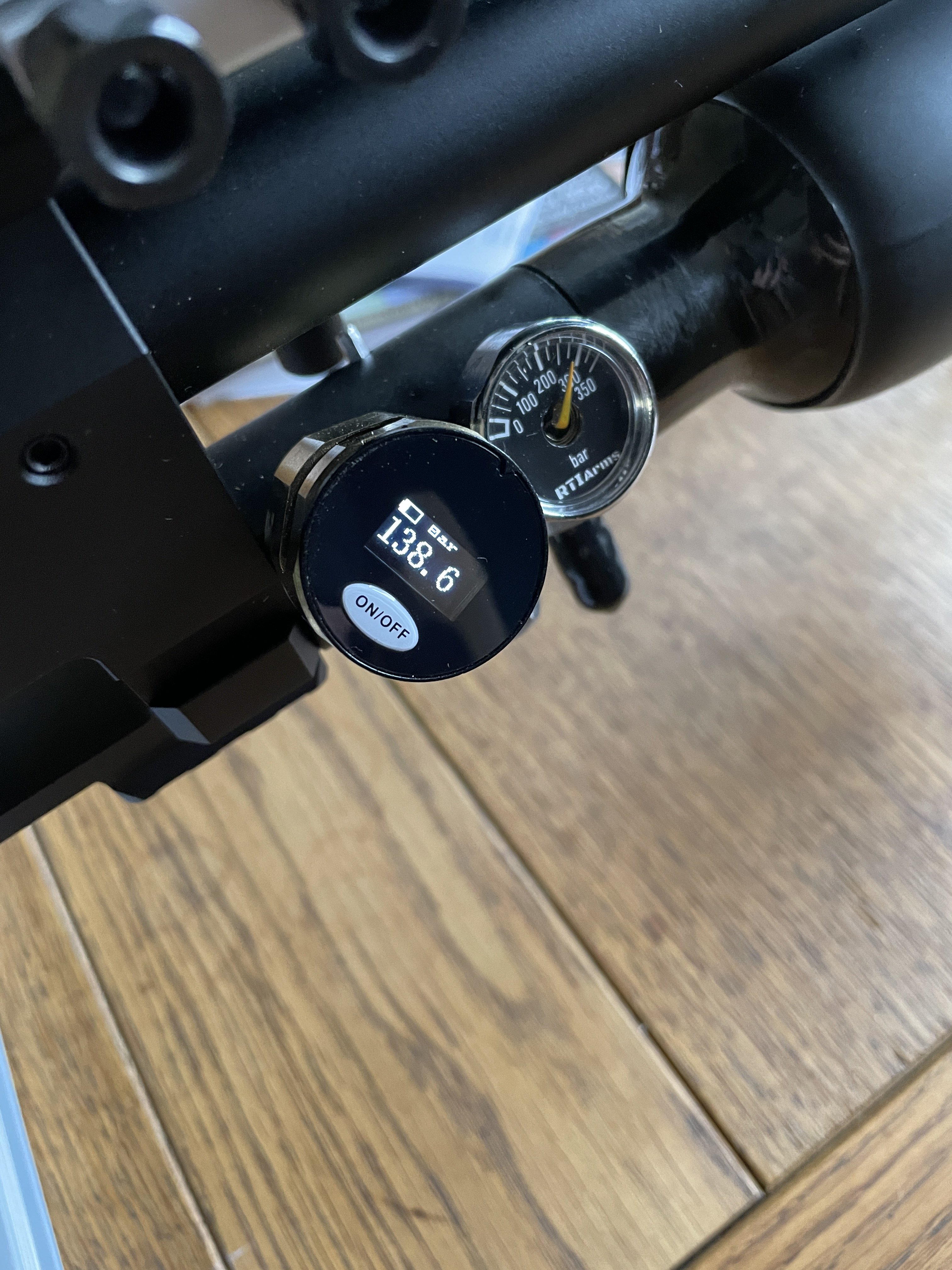

I have a 22 Compact Prophet II Performance Ordered it from RTI , My regulator is set at 130 bar and drops to little below 110 bar after shooting a couple mags, when I fill it back up to 230 bar the regulator goes back up to 130 bar until I shoot the gun again.
So since the gun is pretty new should I adjust the regulator up then down to see if it fix's the creep , I got a Prophet Standerd performance I wondered what everybody was talking about creep? I lucked out on that gun.
