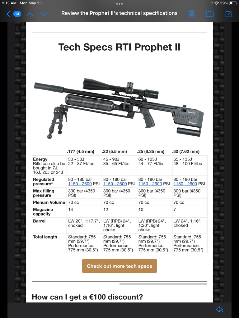

I am thinking about getting a used Prophet in .22 caliber. I would like to shoot pellets and slugs. I'm thinking that it is adjustable enough to tune for both. Are all the different models (barrels) capable of shooting both accurately (pellets under 50yds and slugs for 50-100yds)? I see that the Prophet in .22 has a 20" barrel and choked. The Prophet II in .22 has a 24" barrel and "lightly choked". Is there a Prophet Performance LR with a different barrel? Which barrel/model would you recommend for someone wanting to shoot pellets and slugs?

Thanks for the feedback. Trying to figure out the difference in the Prophet and the Prophet II. I think the Prophet II has a balanced valve and the improved regulator that is externally adjustable. Also, on the "Performance" models is that just a CF bottle and a larger plenum? Or are there other differences in the models?
The RTI RPB 20” and 24” are available in both .22 and .25 as aftermarket parts and are designed to shoot both pellets and slugs. So the used P1 you’re looking at can easily change barrels..much more cost effective than a new P2..unless you just have to have the power the P2 is capable of.
The big difference in the P1 an P2 is the balanced valve..P2 has it.
Most pellets shoot best around the 880-890 and maybe a bit faster in the LW LR RTI barrels. If most of your shooting is with pellets, I’d go with the used P1 and pick up the RPB barrel if the one in the P1 doesn’t work as you’d like.
The RTI line is like adult tinker toys. The are factory parts for just about everything..including upgrading from P1 to P2..
Enjoy!!

I feel the biggest change - from Prophet I to Prophet II- in the Prophet Performance LR .22 is NOT the balanced valve… its the barrel change!
The PP LR .22 v1 has a 1:32 slow twist rate barrel with polygonal rifling. That barrel was designed specifically to shoot pellets (not slugs) at high speeds - to win long range benchrest competitions. The slow twist rate is NOT optimal for slugs.
The PO LR .22 v2 has a new barrel with a much faster 1:16 twist rate. The faster twist rate is better for slugs since slugs are spin stabilized (vs pellets which are drag stabilized).
So whether you have a Prophet Performance v1 or v2 , you will want to have the new v2 barrel on it if you intend to shoot slugs.

Thanks for the information. From everything I've always read slugs don't like "choked" barrels, but pellets do.
What is the PO LR .22 v2? Or is that a type-o for Prophet Performance?
