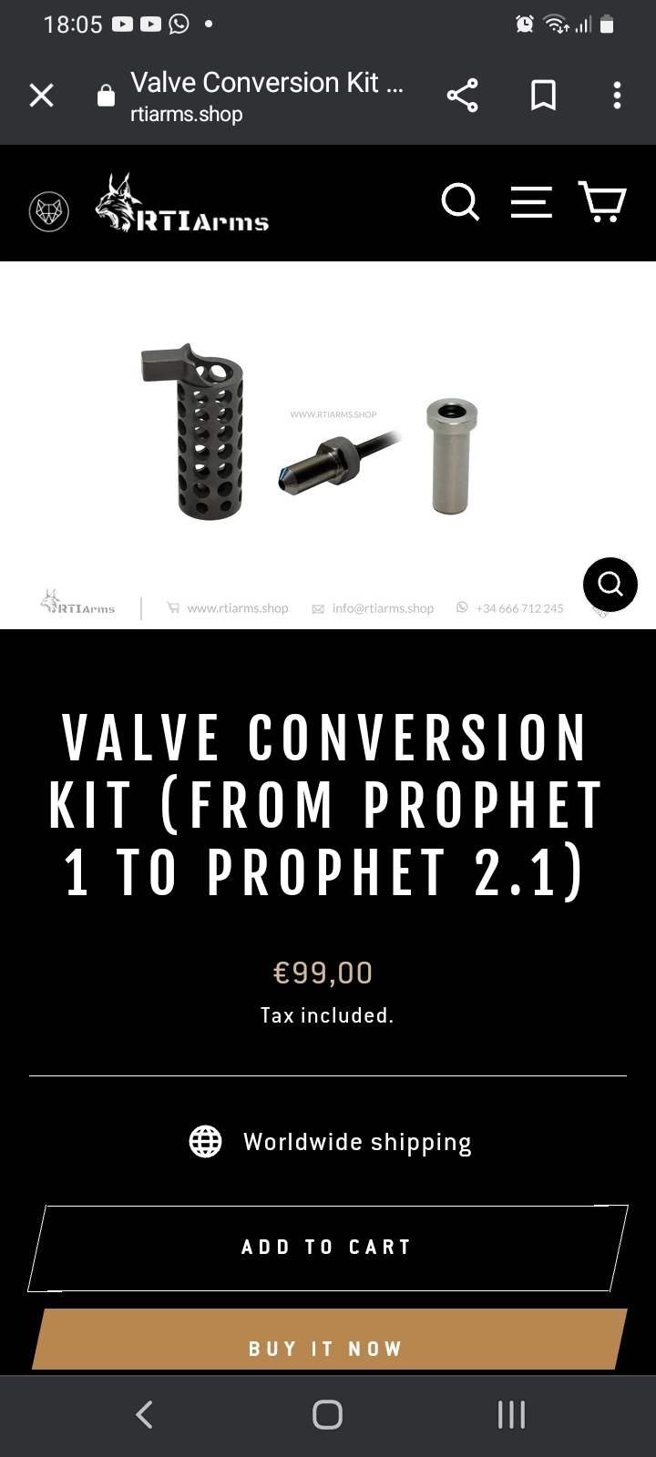

I still couldn't pinpoint the cause of the problem so I ordered a Prophet P2 hammer, valve and valve cylinder waiting for shipment to arrive to test.
Prophet 1, I understood to be the one that you have a problem with.
So you order parts for a Prophet 2?
I'm totally confused but looking forward to your conclusion.
