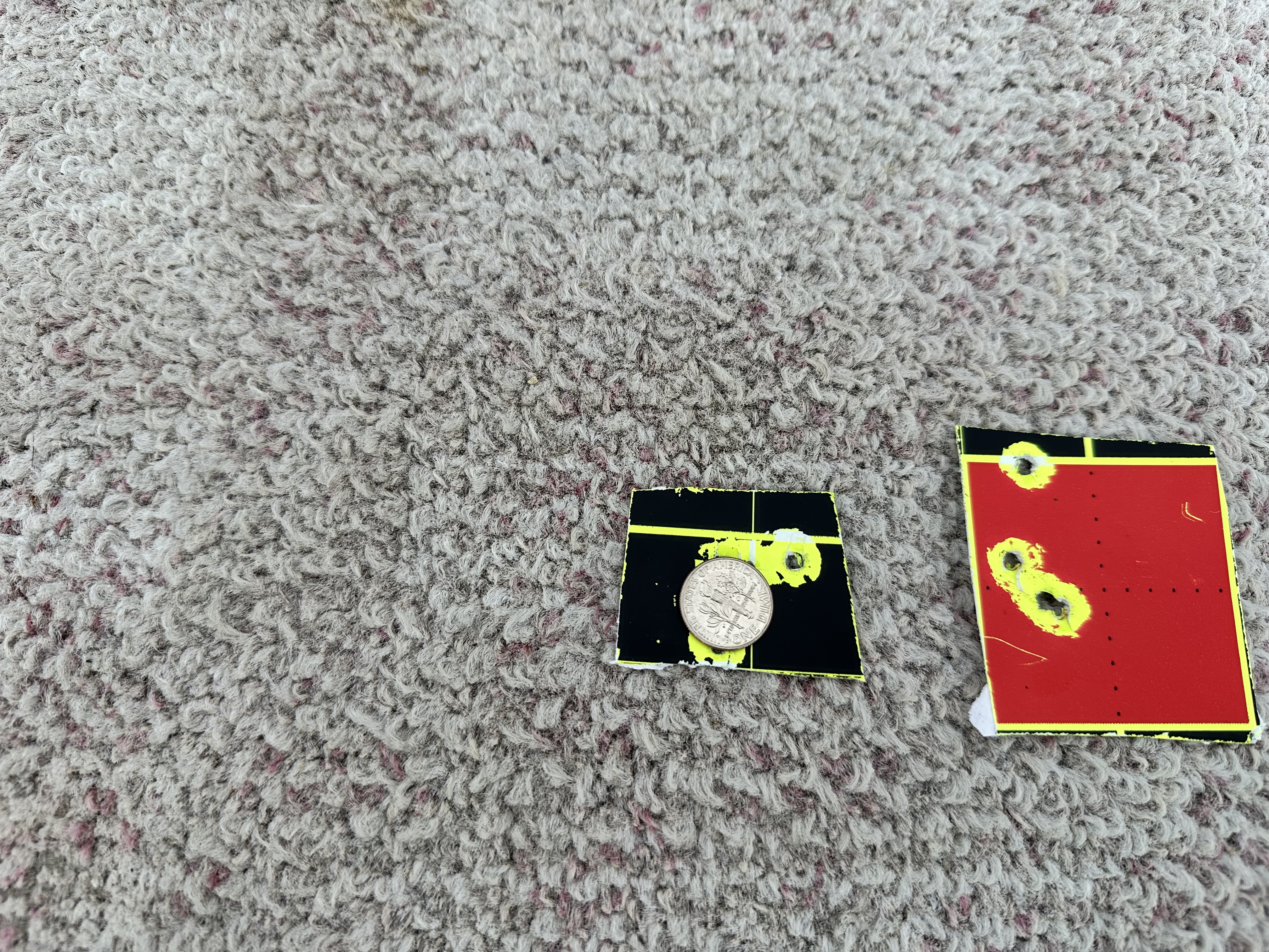

Shooting slugs from full size P3 it’s an amazing pcp accuracy is stellar accuracy is stellar!
