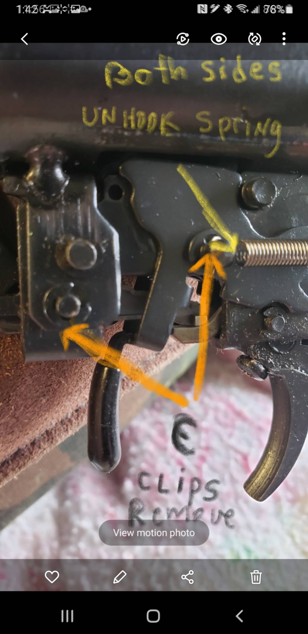

Welcome to affordable air gunning. The Impact Max Elite is a powerful hard hitting and accurate gun and after tuning up the trigger and putting a decent scope on it it will serve you well. The trigger can be tuned-up without removing the trigger assembly from the barrel. I bought my springs at Tacoma Screw Products Inc. tacomascrew.com (1-800-562-8192) I think I paid about $1.50 for each spring and something like $5 for shipping and handling. I used a 154-C for a very light trigger. I already sent my spare springs to 2 other members of this forum so I can't help you with that. I do have some pictures that might be of help.
To access the sear spring you must remove the E clips to the pins I have arrows pointing to and push the pins through and remove them. The one pin has a spring hooked to it on BOTH sides of the trigger assembly. Only unhook the springs where I show the arrows pointing and let the springs connected at their other end. After pushing the pins through you will be able to move the internal parts enough to remove the old sear spring. It will unseat when the pins are pushed out. Cut the new spring to match the length of the old one. I used a small pocket screwdriver to install the new spring by putting the tip of it through the coils allowing me to position it easily without it falling into the trigger assembly. There are small protrusions that each end of the spring must seat on.

In the next picture (below) I have an arrow pointing to the assembled trigger. It must look like the picture when you reassemble. It is easy for it to pivot up into the trigger assembly and after it's put together you will discover the trigger won't work.
Be careful when removing and installing the E clips. They can take flight never to be seen again.

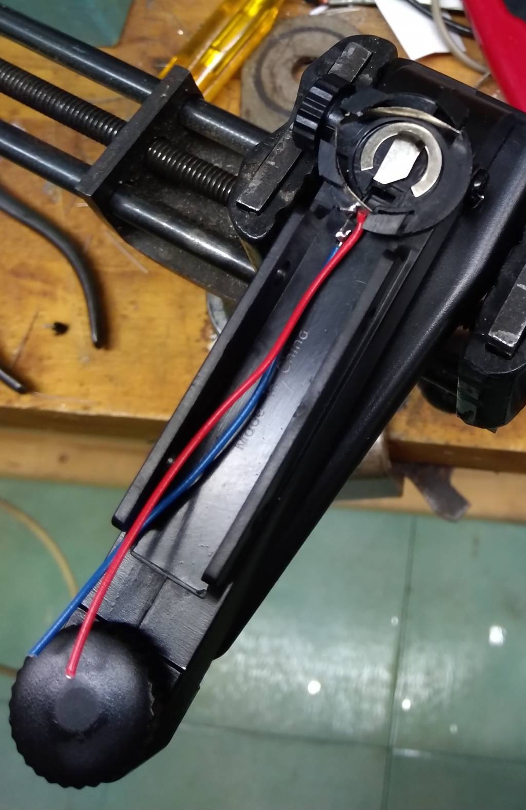

I have a $10 (ebay) red dot reflex sight which I want to put on the barrel in place of the rear fiber optic sight. I find 2 problems w/o considering the recoil.
The lens/reflector itself is pretty good but the reflecting coating is not red selective (spelled cheap ) and too dense so that the view through is too dark. I can see why they would do this w/ a (comparatively) thick (plastic ?) lens to minimize a double image.
The LED is too bright for the lens. Any defect in the pinhole or my eyes scatters the light (coherent ?) from the LED into a mess. One possibility is to put a resistor in series w/ the LED and see how much I can reduce the scatter while still seeing the dot.
Well... It was a lot easier than I might have thought to break into the connection to the led ! I measure the current at 4 milliamps, so the resistance in w/ the led has to be somewhere around 275 ohms. I have tacked in resistors (found laying around) and 150k ohms is perfect for indoors but disappears outdoors. That's a mighty big drop in current !
So that seems to work but, as yet, I don't see any easy way to vary the current up and down. We will see how it goes when I get the indoor range set up.
