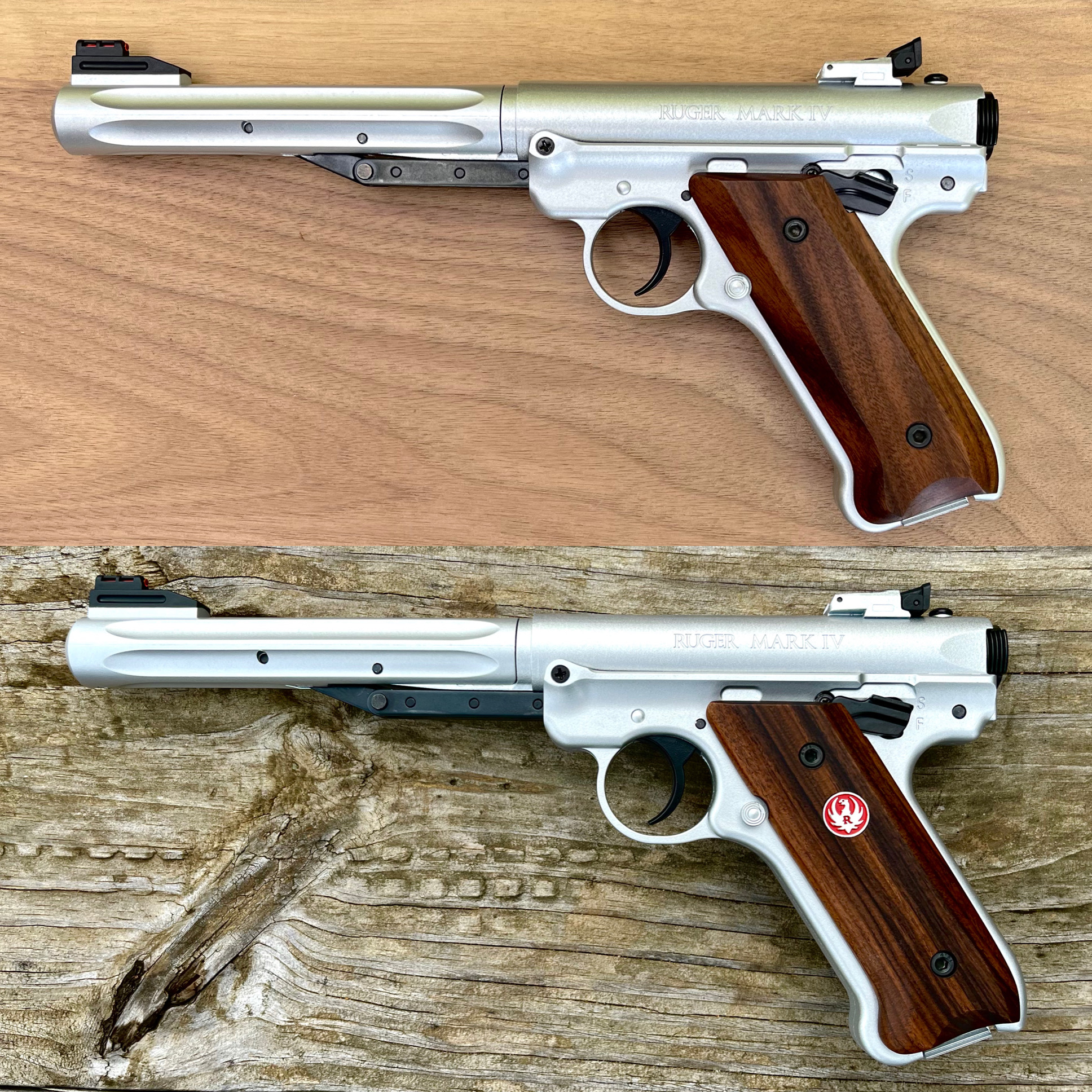

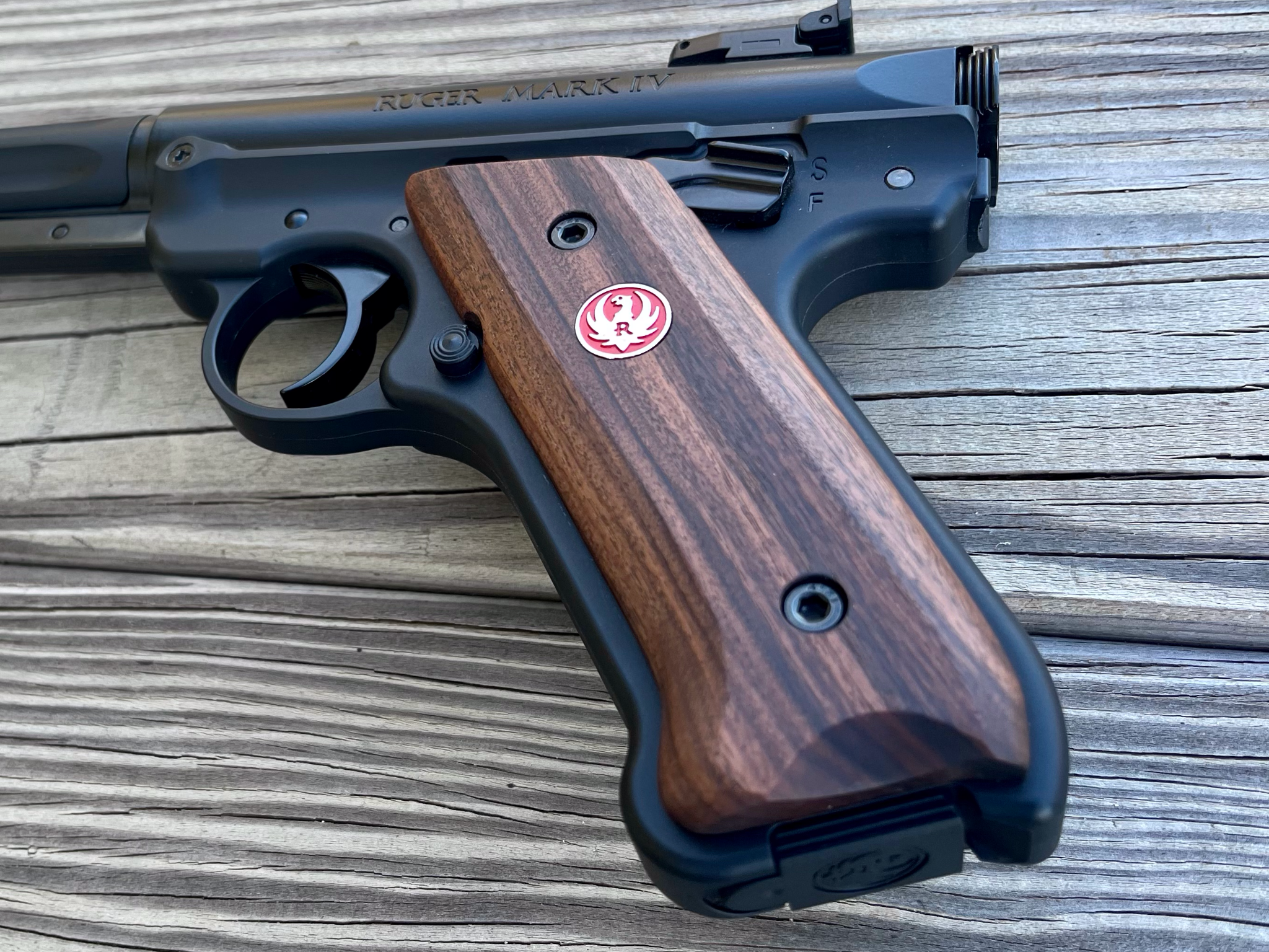

So BOG, are you just removing the two grip screws to get the plastic factory grips off and then just copying the design in wood?
Thx
Ray
Sort of. I fit the wood to the frame first with a slightly oversized cutting. In case of a little movement in the fitting. Then cut and shape the exterior. Next, I grind the bevels like an actual Ruger set of grip panels. They need to be a bit thicker because of the plastic retaining studs on the frame. To allow for the screw to seat. Mine is 1/4 inch thick. The Umarex ones are quite rounded. See picture.

Sort of. I fit the wood to the frame first with a slightly oversized cutting. In case of a little movement in the fitting. Then cut and shape the exterior. Next, I grind the bevels like an actual Ruger set of grip panels. They need to be a bit thicker because of the plastic retaining studs on the frame. To allow for the screw to seat. Mine is 1/4 inch thick. The Umarex ones are quite rounded. See picture.View attachment 411566
Thanks BOG, I've got to scratch around my wood pile and see if I can whip me up some. I really can't believe how much more real it makes the pellet gun look. Thanks for the info sir.
