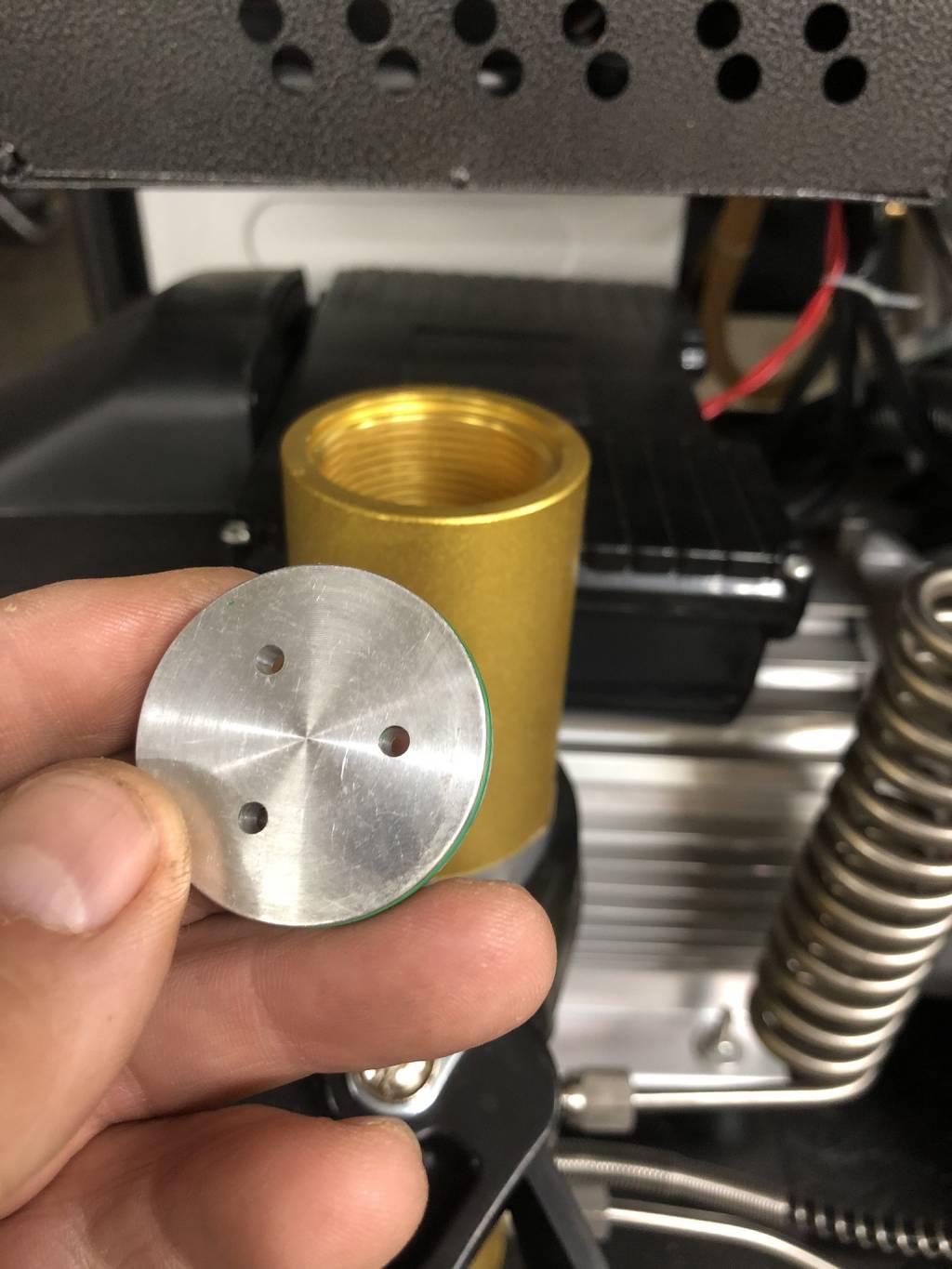

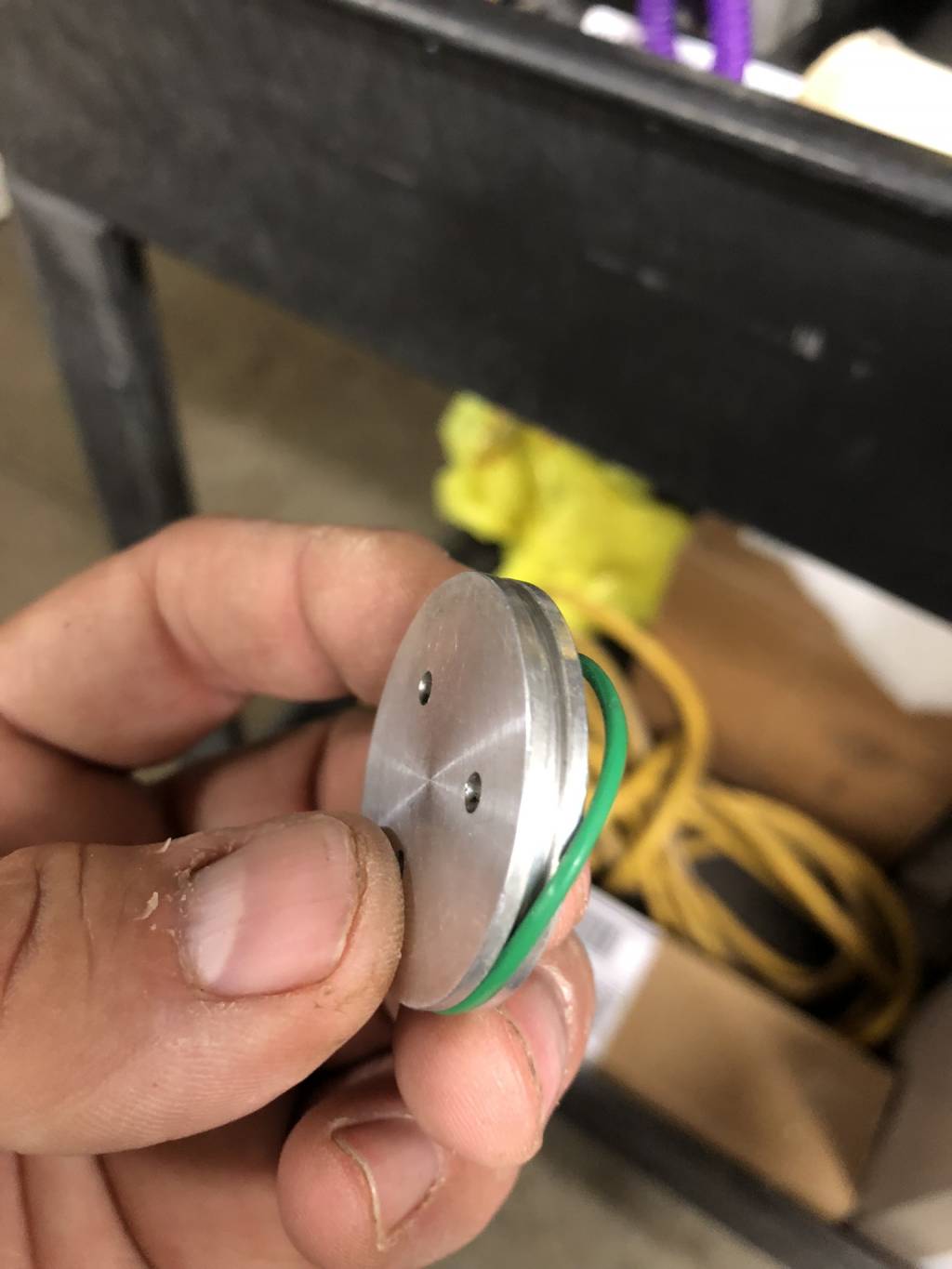

There is a divider plate within that cylinder that sits either on top of the cotton media or below it(can’t remember but I’ll find it in my lightning break down pics.) that’s the dissimilar metal. I believe it is stainless.

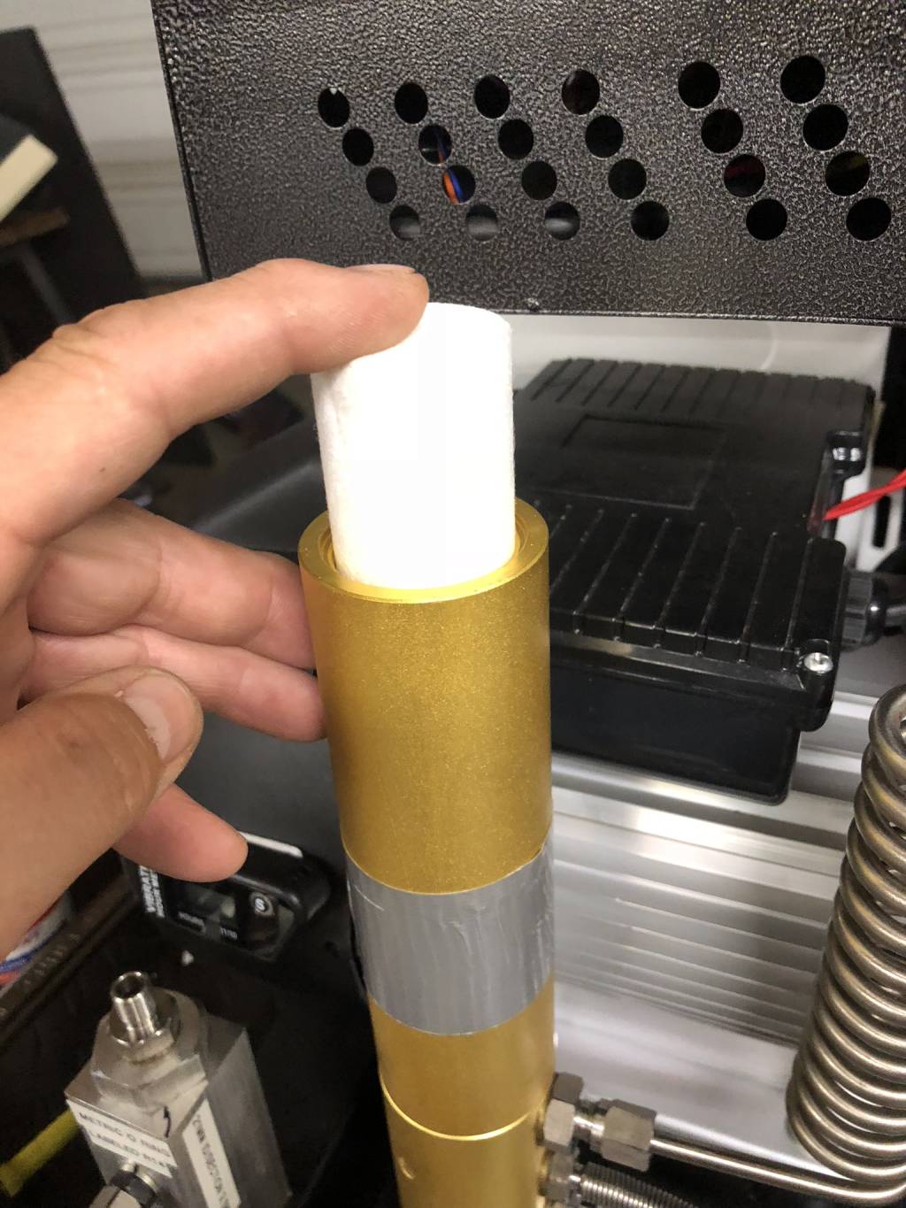

I showed this same contamination in my rebuild thread from three years ago. You’ll have to source a round cylinder brush and clean it the best you can like I did, and use a shop compressor to blow out any bits and pieces you remove of that gunk. Then do a wipe down with isopropyl alcohol to make sure it’s clean inside.
before you insert the cotton media take a sharpie and write the date down on it(unless you’re good about writing things down in a maintenance log book)
that o ring that’s on the divider plate- do not toss or ruin that o ring as it is not in the repair kit. It can be reused, though
