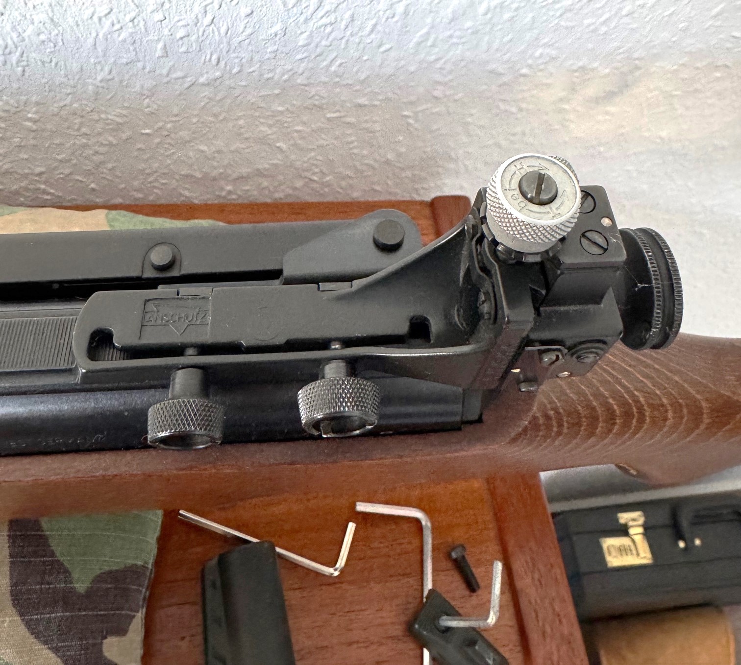

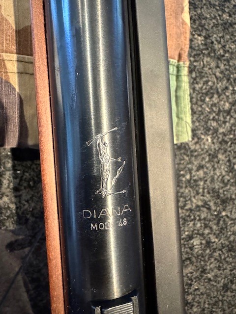

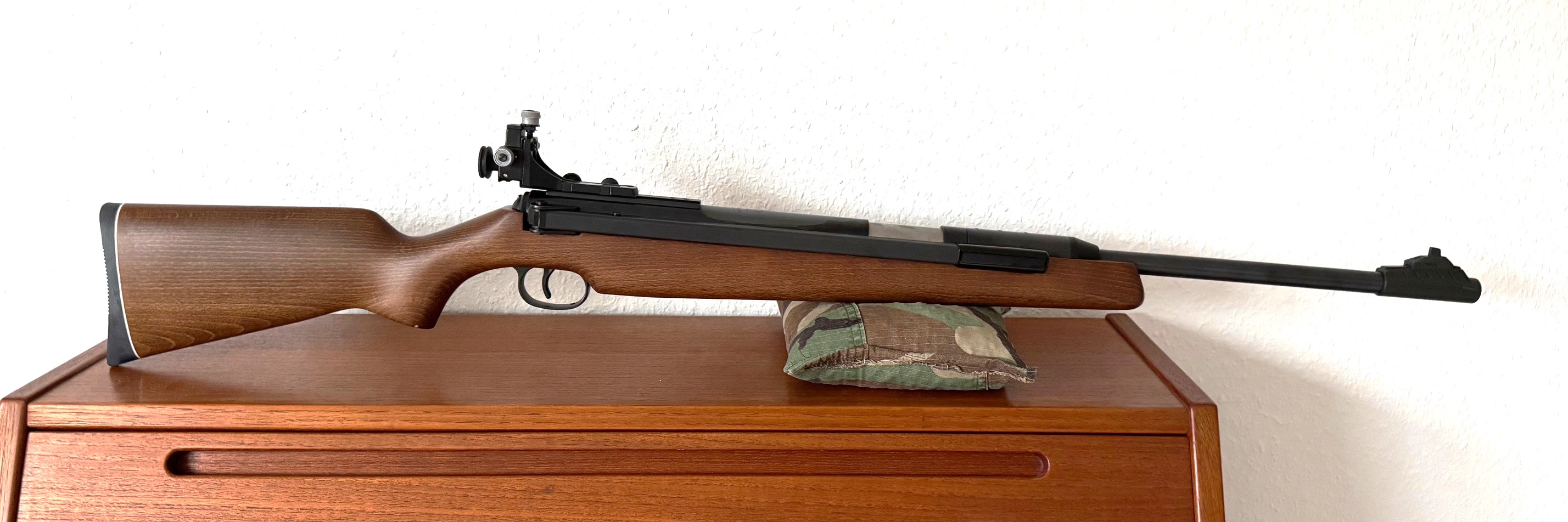

I have had a Diana 48 for several years now I have not had much opportunity to work with. Primarily because of moving and the fact it is not configured the way I want IRT sights. I acquired an Anchuetz rear the fits well and al though I can use it I want something with preferably the ability to accept an M14 front or at worst some globe front sight.
What I didn't know is with the RWS 48 rifles there are variations as to how the front sight mounts, I saw the variations are marked on the receivers. On my Diana there is not variation stamp, T06 or something similar.
So, the front sight mount on my rifle has the two cuts that appears to be the same as I found on the T01 RWS. I saw this thread but I don't see a solution... https://www.pyramydair.com/blog/2010/02/mounting-a-globe-front-sight-on-an-rws-485254/
Anyone come up with a fix?
I have been thinking of one of the clamp type bands as a solution https://www.ant-supplies.uk/rail-base-mounts/diopter-sight-muzzle-adapter-bases.html

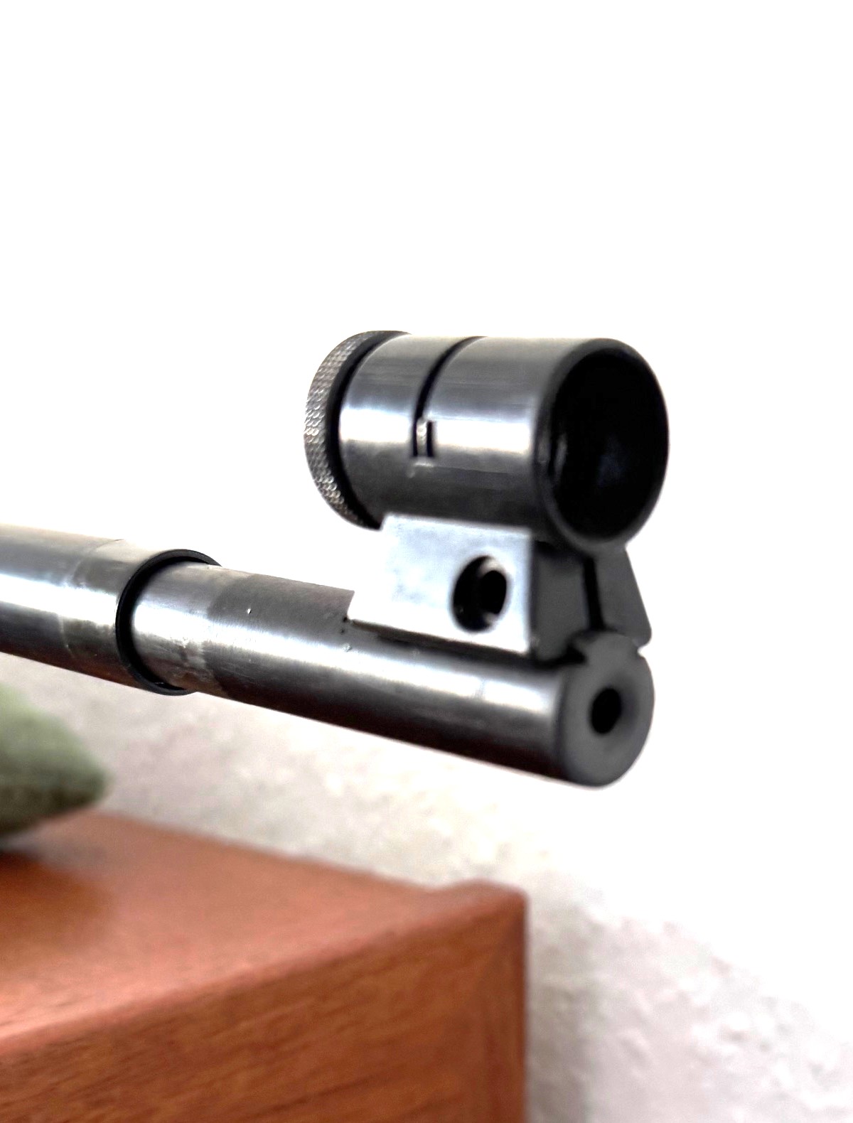

Remove the front sight, there should be a dovetail mount under the front sight, on which you can install a standard Diana front sight with replaceable inserts. If the rifle is a late T05 or T06, then Diana produced special bases for the front sight, which are currently impossible to buy. Diana T05 and T06 rifles do not have a dovetail at the end of the barrel.

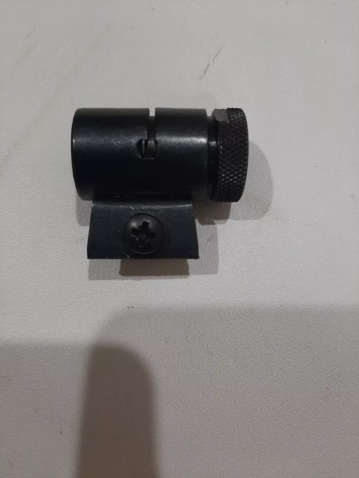

Good luck on finding the Diana globe with or with interchangeable inserts ..
You may ask or find out if the daisy or true glow ones can fit the dovetail ..
Diana/rws part is going to be hard to find maybe best ask the forum if someone has one to give ..
Daisy, Tru glow, or aftermarket your b st bet of it fits anything
Example
https://www.pyramydair.com/product/air-venturi-front-globe-sight-accepts-inserts?a=3190
https://www.champchoice.com/mc-airgun/air-rifle-accessories/daisy-front-globe-assembly-169816

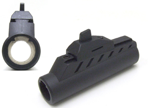

The rifle is not a dovetail sight. It's mounted in a polymer shroud. A dovetail globe sight won't mount on it.

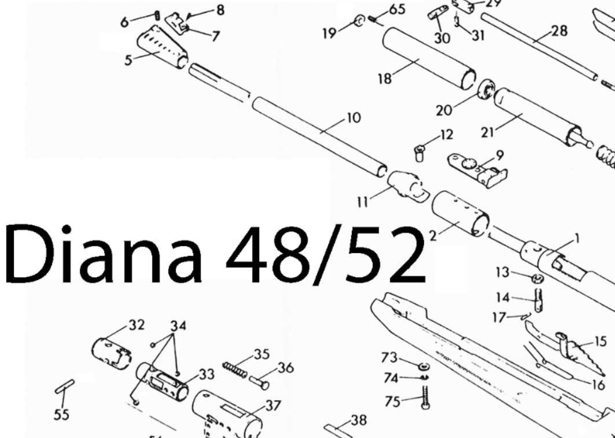

They make 3 different height "korntunnels" for that model. 9mm, 10mm, 11mm height. They come with a fiber optic post and a hood. They mount with a screw into the shroud. Not a dovetail on the barrel.
Go to the Diana website. You will see the part on the schematic. There are part numbers for each height. Blue Line industries are the only distributor and they don't order parts for older rifles. They referred me to Hector Medina and he was able to get them for me from Germany.
I ordered the short and the medium height. It depends on your rear sight height and your desired cheek weld. With the factory rear sight the low works best for me. Your diopter may require a different height.
The T06 designation is the trigger. It's the "newer" model rifle. They have the polymer "korntunnel" and not the hooded dovetail sight with inserts. I found no other options for a front sight. There may be other sights for it. I looked and didn't find.

Don't bother, your barrel does not have a dovetail.I'll repeat myself once again for those who are in the tank. The dovetail on the barrel is only found on old rifles with T01, produced in West Germany.

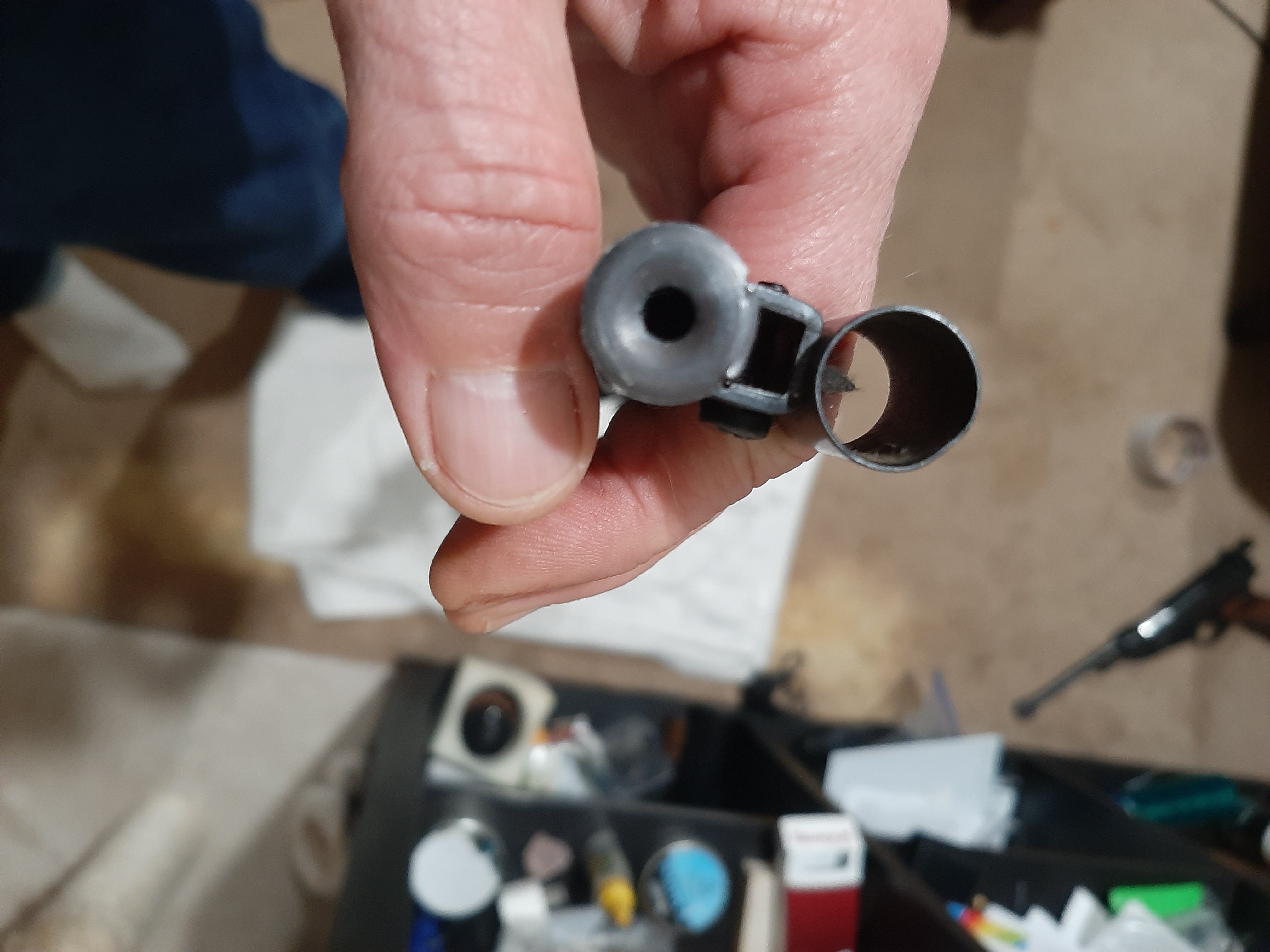

I took the shroud off my 48 and it has a funny wedge not a dovetail.
Ya, found this late but it shows that
Maybe I'm thinking wrong big if you look at China beeman i think there muzzle ends are " wedged" like that under there sights shrouds thing ad well .. hmmm.....
