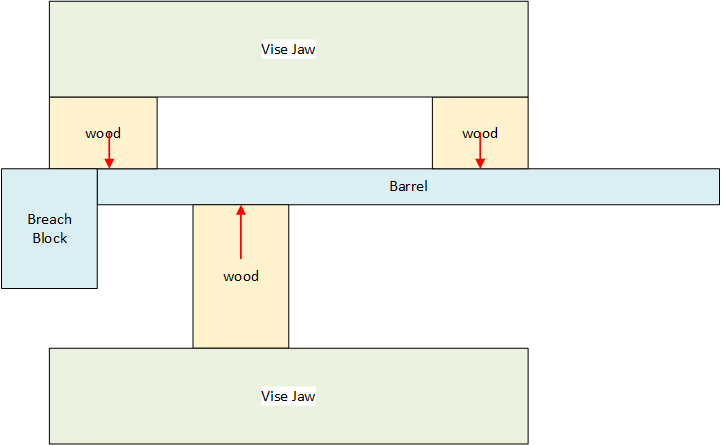

Since that area has already been stressed, I might try to bend the barrel back down by utilizing the remainder of the barrel. There were some posts awhile back that showed how to do this using wood blocking and clamps. It was very simple, but would be effective and non-marring. You could also do this in stages to get the barrel exactly where you want it. You might try searching for those posts.

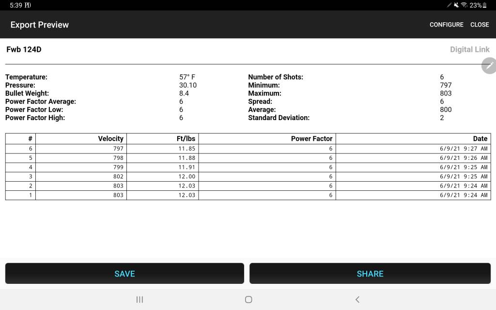

First off, one to two drops of chamber oil is all that's needed. Many will say that chamber oil isn't necessary for springers but I'm of the opinion that if it's recommended by Diana, RWS, Beeman, and Umarex then it should be done. Many people use to much and to often. I have a Feinwerkbau 124D that was shooting at 775 fps with JSB 8.44 gr pellets. I doubt the previous owner lubed the rifles chamber so I'm confident the chamber and seal were dry. I decided to use 2 drops of chamber oil and I cocked and unlocked the rifle but did not fire the rifle. I let it sit overnight to allow some the lube some drying time in order to minimize dieseling. Fired it the following day and it only dieseled twice. After 60 or so shots there is no smoke present in the barrel after firing. NONE ! Just like before applying the chamber oil. NONE ! Here is a 6 shot chronograph I did the other day.
