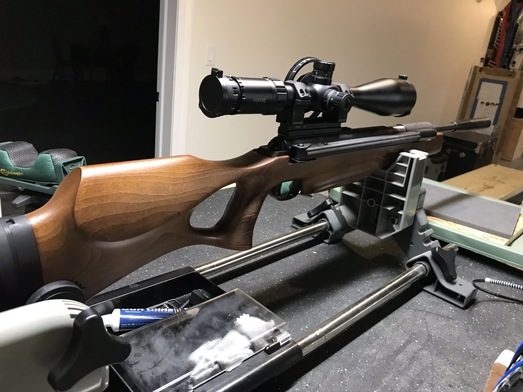

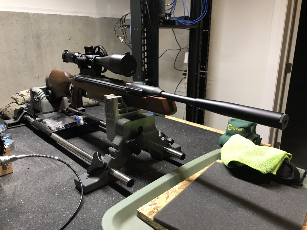

I called the service experts at Hawke and asked them if a Sidewinder 6-24x56 FFP scope would hold up on this rifle. After assuring me that it would, I installed a UTG droop compensating picatinny base, upon which I secured a UTG fixed 30MM ring scope mount, complete with 4 bolts and two recoil stop pins, all sitting on the rifle's 11mm dovetail. I proceeded to sight the rifle in at 18 yards, the length of my indoor basement range. Even with the droop mount in place, I still did not have enough scope adjustment. Two thicknesses of paper-backed aluminum duct tape on the back ring served as the perfect shim and everything was easy to dial in afterwards.
I have been shooting in a basement range for two decades. One observation that I might share is that not once in that time period, has my wife every commented on the noise of any of my rifles. She did comment on the 56, indicating that it was "very loud." It does have a pretty violent sound as the heavy spring drives the piston home.
The rifle is very front-end heavy, but with the configuration of the fore-end and the weight forward, it makes for a very steady bench gun.

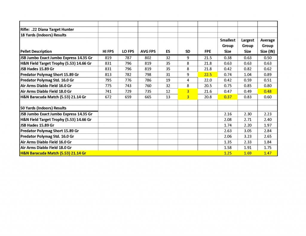

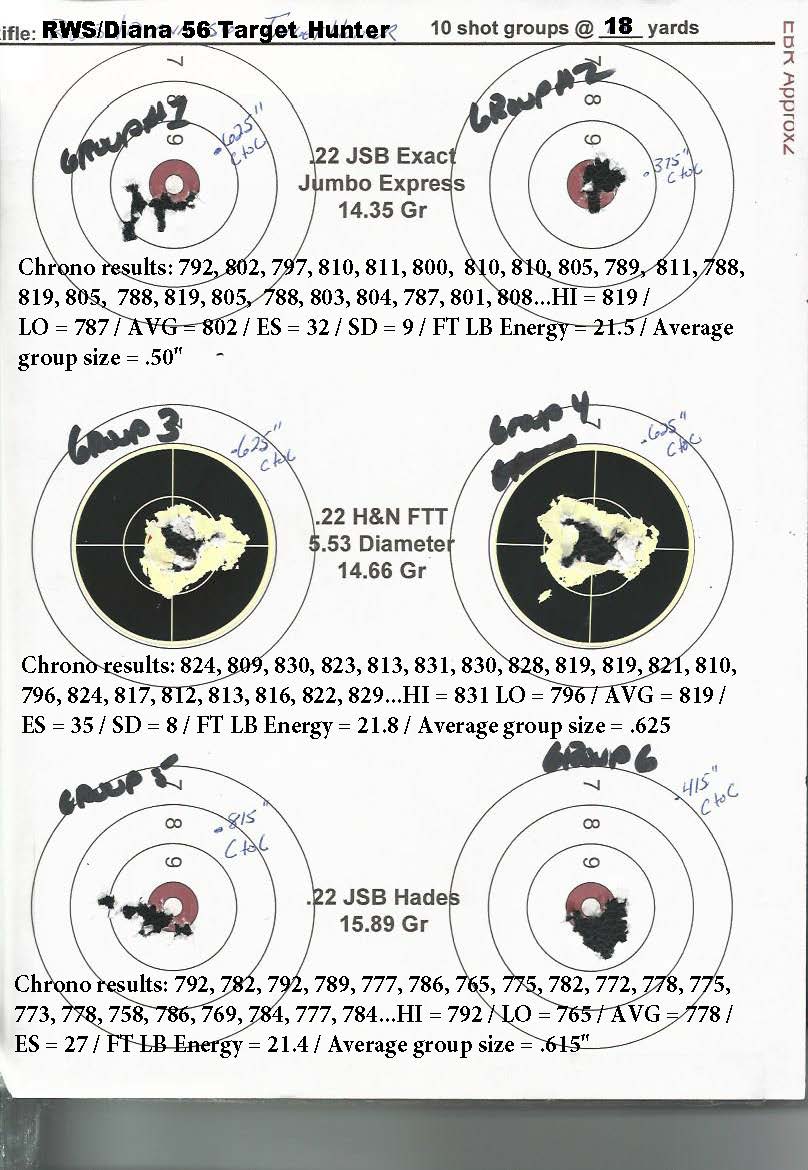

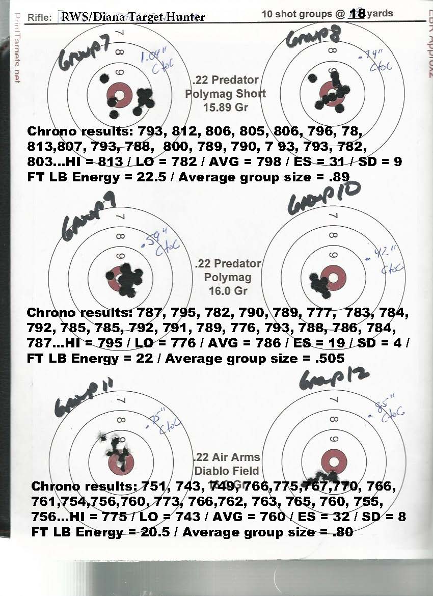

I then set-up my Chrony Pro approximately 1' from the muzzle, and proceeded to shoot two ten shot groups (at 18 yards) with each of eight different pellets, for accuracy and consistency . All 20 shots were recorded across the Chrony.

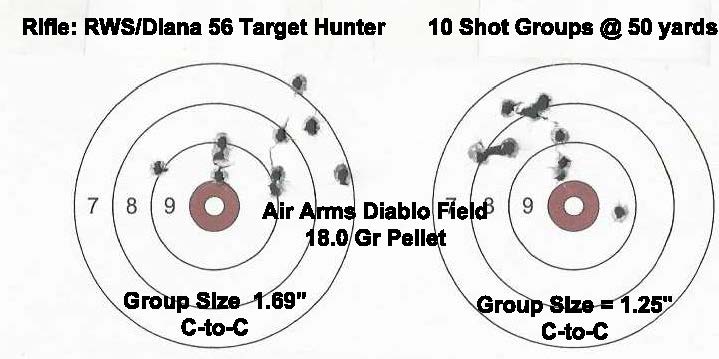

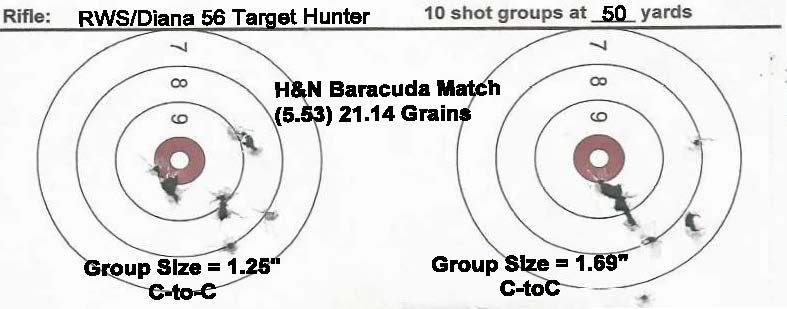

Once this exercise was complete, I moved across town to my indoor range where I have up to 150 yards available. The same exercise was repeated with the same eight different pellets, except at 50 yards and without the chronograph. At both yardages, sandbags were used under the fore-end and the butt pad to be certain that the rifle was adequately stabilized. The temperature in both cases was +/- 65 degrees. There was no wind to affect the outcome and lighting was more than adequate. All pellets were pulled straight from the tins with no special sorting for weight or shape uniformity.
Note that the output was consistently +/- 21.5 ft lb of energy - exactly as advertised by the manufacturer.
Below, you will find photos of the rifle set-up, photos of the groups experienced at both 18 and at 50 yards and the performance summary chart. As you will ascertain, the smallest group achieved at 18 yards was .37" using the H&N Baracuda Match 21.14 grain pellet and the best average 18 yard two shot group size equated to .48" shooting the Air Arms Diablo Field 18.0 grain pellet. The smallest group and the two group best average at 50 yards was achieved shooting the H&N Baracuda Match pellet, resulting in group sizes of 1.25" and 1.47" respectively, with the Air Arms Diablo Field 16.0 grain and 18 grain pellets coming in a very close second and third.
You will also note that the AA 18.0 grain and the H&N Baracuda Match 21.14 grain pellets had a standard deviation across 20 shots of only 3 fps. This is regulated PCP performance territory.

Thanks for your inquiries. I believe the rifle shows much promise towards being very accurate. Already, it produces PCP quality groups at 50 yards with the AA 18 Gr pellets.
To me, the effective range of any air rifle is the maximum distance it will stay inside a 1 1/2” group.

When I get my rifle back from Motorhead, I will provide an update. I concur that the AA 18.16 are the most accurate pellets, at least in my rifles. I will probably settle on the 18 but am awaiting the rifles return for one more round of 50 yard testing. Once concluded, I will pick the best performing pellet and shoot 10 shot groups every 5 yards from 25 on out to where the accuracy begins to exceed a 2” group, and call it quits. I then plot out the poi for each of the groups upon an image of the scope’s reticle, printing it to a card then attached to the rifle and copied to my phone. I find that this gives me pinpoint accuracy at any point within the rifle’s effective range - and much more dependable info than even StrelokPro. There is no substitute for time invested.
