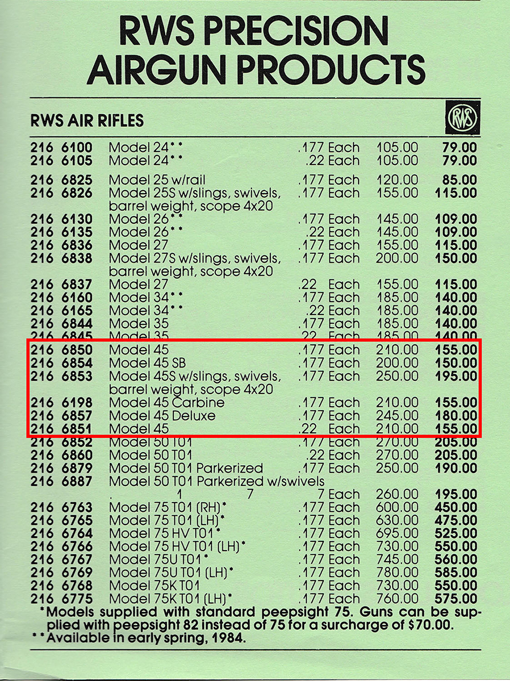

I’m trying to get more models slowly but surely. When Gamos and other Magnum models got popular years back I had a Tim the Tool Man Taylor moment and wanted latestThere was a Carbine version of the RWS(Diana) Model 45.
Both through bolt styleI'm still confused whether we're talkin' the original "through-bolt" 45, or the later 34-based one.
Snippet from a 1984 dealer price list.Thanks! I'm not as familiar with the 45 as some other Diana models but - as Wadcutter said - the simple answer might be that a "carbine" version was offered at some point.
I handled an 82 sight at Findlay one year and you can see the difference, it is one lovely little piece of kit.Notice in the above advert, that the upgrade from the diopter 75 to the Elite 82 is a 70$ surcharge.
That upgrade is like 210$ in 2024 dollars, and may explain why they are so scarce?

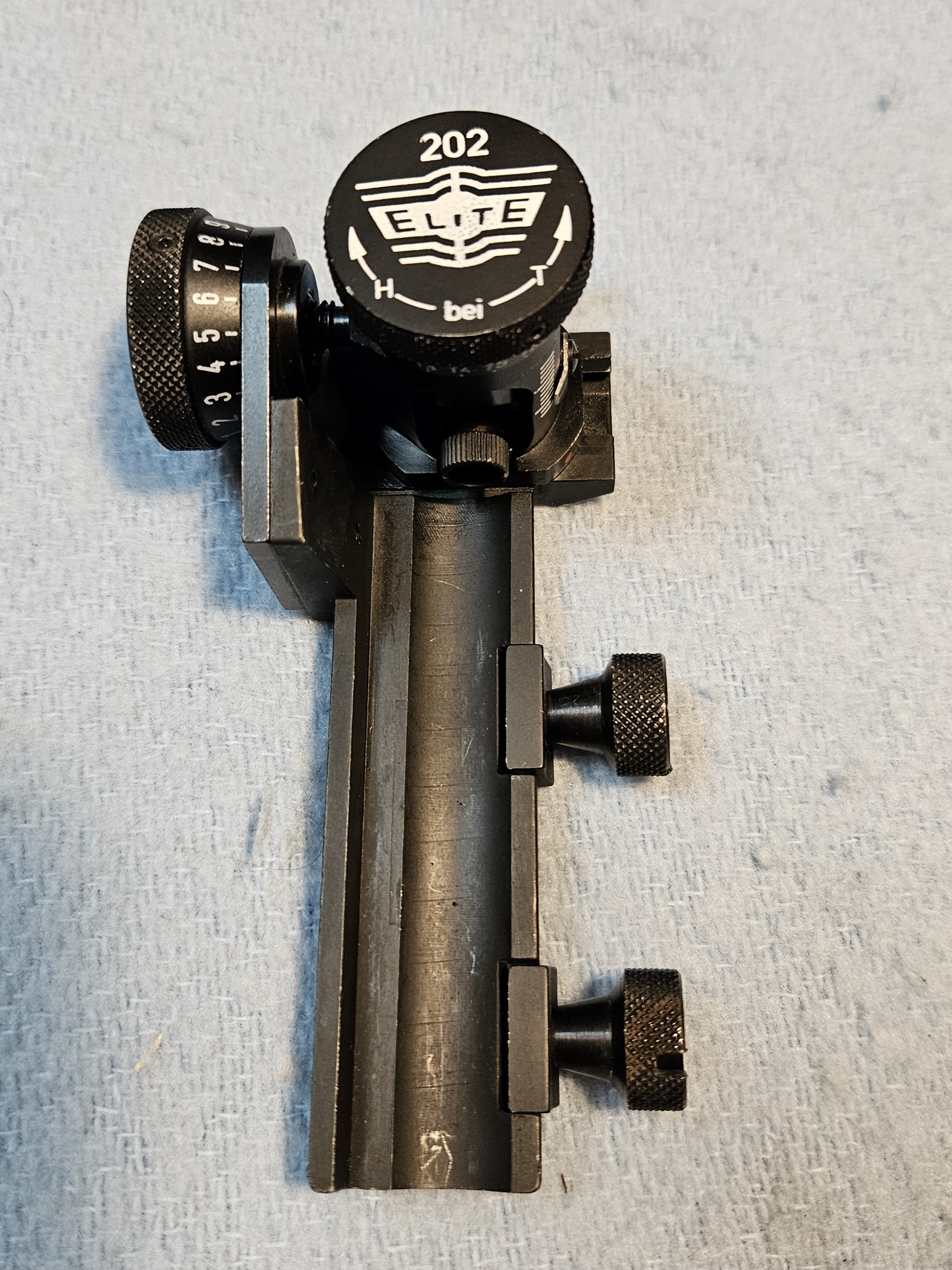

Would love to have one of the 82 sights.I handled an 82 sight at Findlay one year and you can see the difference, it is one lovely little piece of kit.
