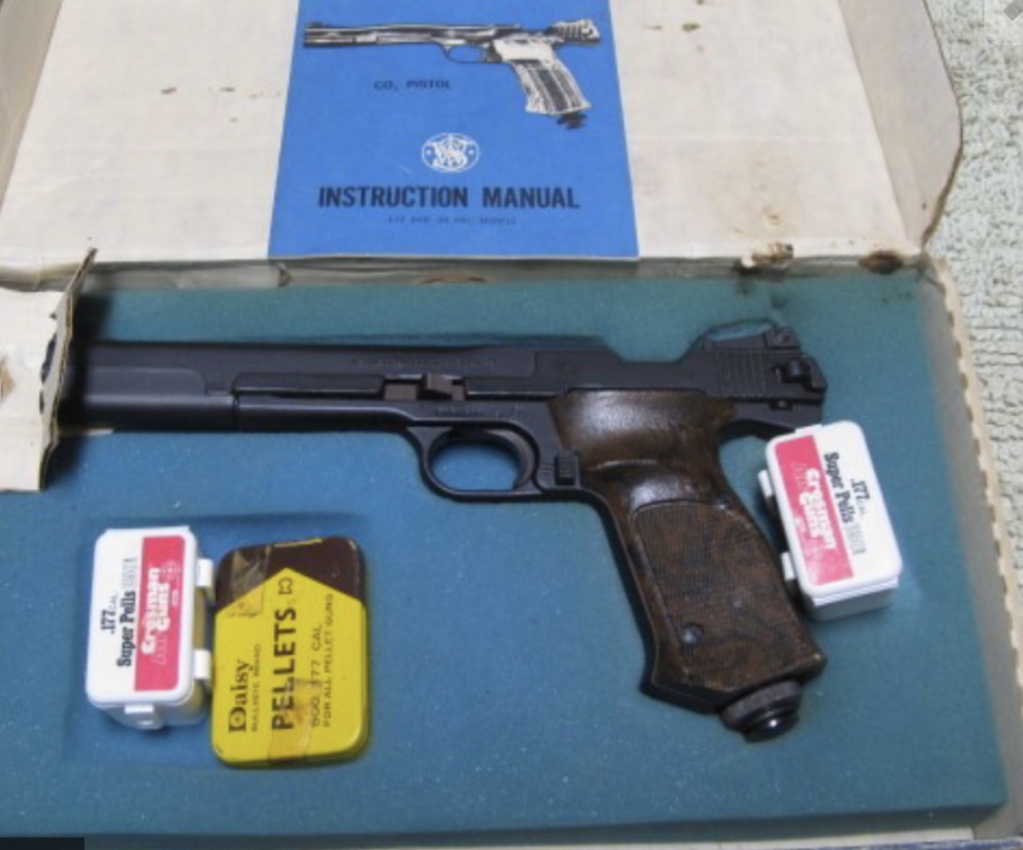

Just bought this 79G. Seller claimed it’s been sitting in storage a while so it will most likely need to be rebuilt.
1565916280_17837117345d55fc78ae6325.06067969_F6E19323-0270-4A12-8A14-357218C8999D.jpeg

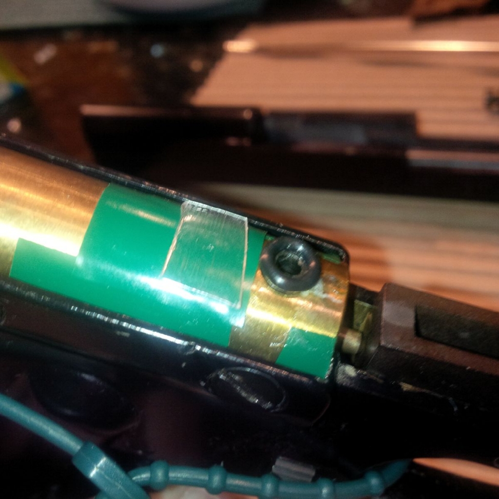

I re-sealed a 45 yo 79G a few months ago using an Ebay kit. The only thing that really needed replacing was the large seal on the piercing cap. The poppet valve was in good shape and still seals after about 50 Co2 cartridges. Initially, I got about 65 shots per cartridge. I have since added a #61 o-ring to the transfer port resulting in about 85 shots per cartridge. (two turns on the stock hammer spring the whole time). The green electrical tape is used as shims between the frame & valve. The plastic shim (.015") elevates the barrel in order to provide better alignment with the loading port and and allow the "snugging" of the barrel screw.
Boscoebrea, does your SW 7XG hold pressure for a few days? Weeks? I ask because the first time I re-sealed mine I noticed that the transfer port didn't have a rubber/polymer seal, but didn't think much about it then. As described above I added an o-ring and shot count went up due to plugging a leak downstream from the valve. Also, post seal installation it was mentioned to place a piece of tissue paper over the breach area and fire the pistol to indicate a leak at the transfer port.
