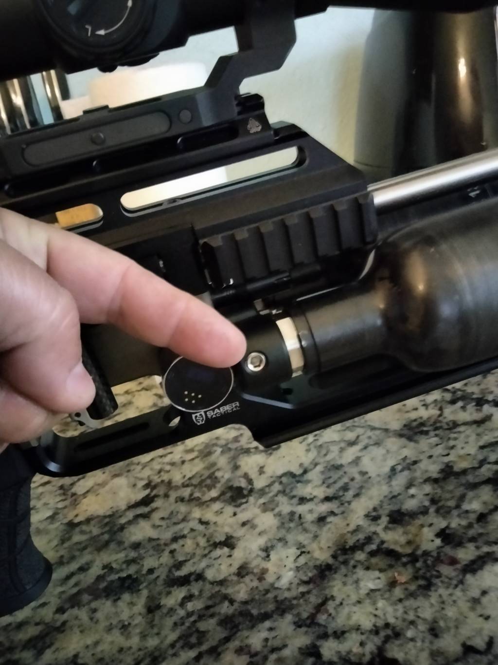

Anyone else have the new style Saber tactical Dual Tank kit leaking real bad where the little Allen screws on each side are at? I've got a FX Impact MKII and it's leaking bad at these 2 screws. If so how did you fix it ? Putty/Teflon tape?
Is there orings under there?
Nope no orings. I just put JB weld on the grub screws and we will see what happens. On a positive note Saber Tactical did reach out to me for a RMA but I told them let me try the JB weld first. I feel like with no o rings there is to much psi for just the screw threads to hold back all that air. I'll put it all back together today and see what happens.
