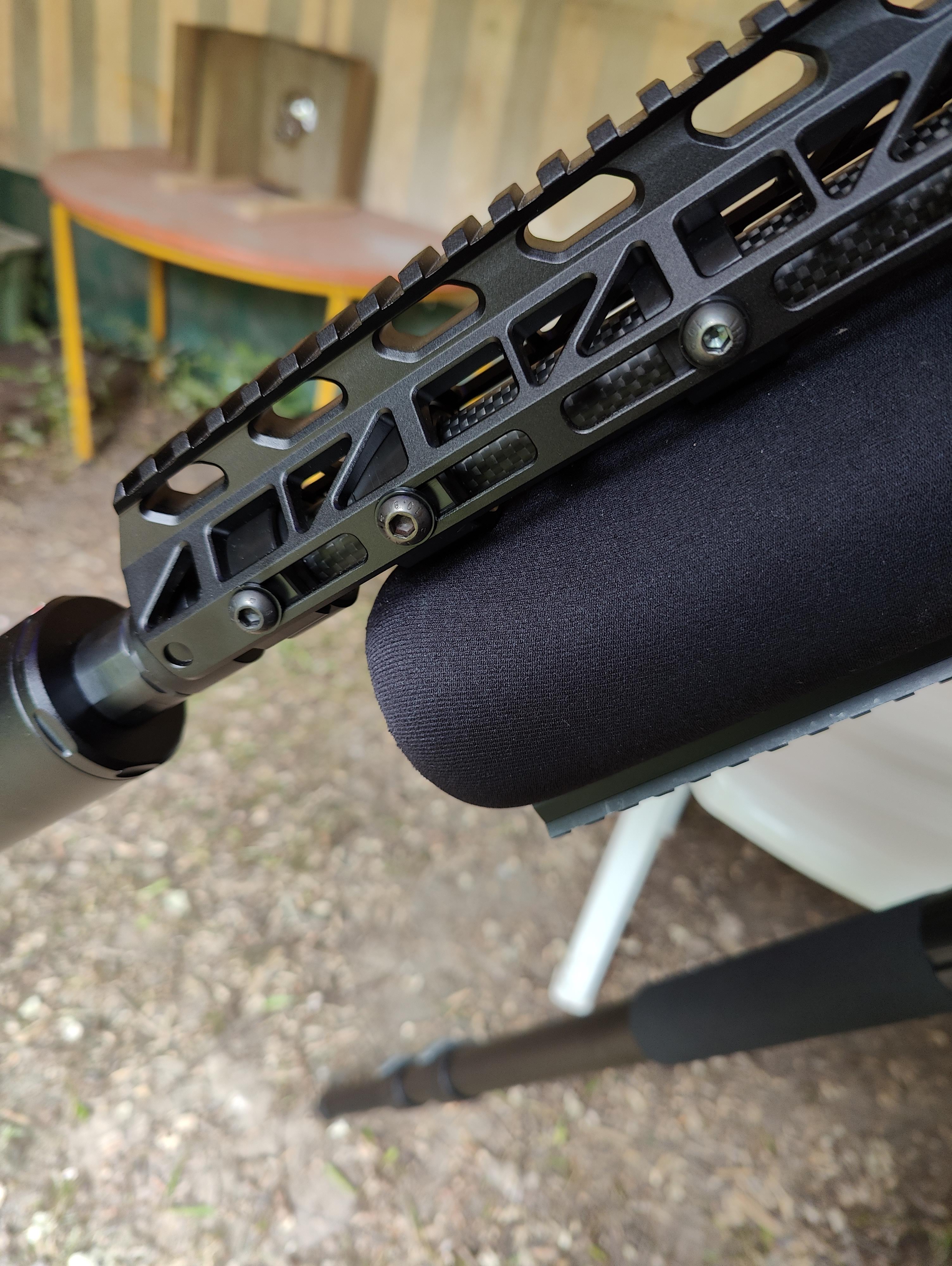

Just if somebody wanted to know what multiple clamps would do on the TRS rail.
I added 2 clamps to my TRS rail and it increased the accuracy.

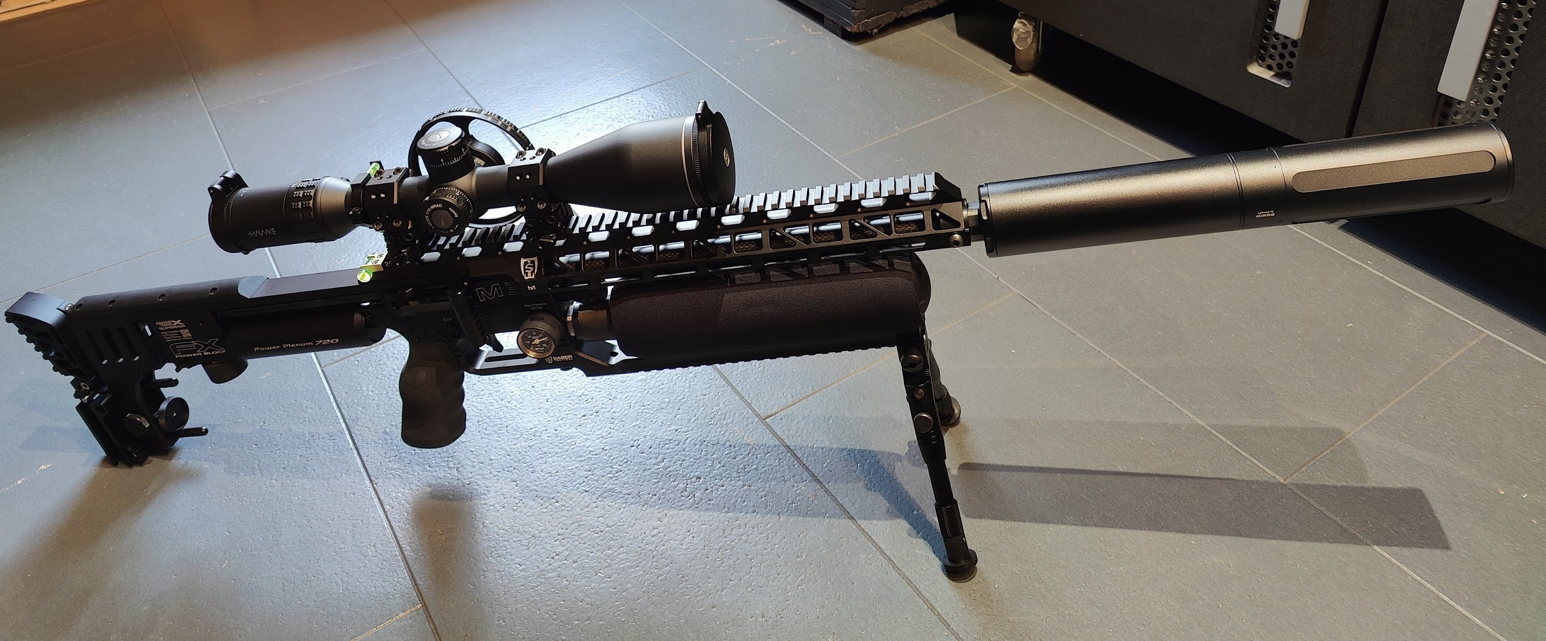

MKIII .25 600mm with barrel tentioner (because of neighbours had to added an extention on a donntfl ronin. (does now about 88-89db with 33.95gr MKII at 887fps.

I had to test somewhat with placement and mostly up front works best up to now.
Works a bit like a barrel tuner with added stifness of the barrel :)
Hi mike, I have the standard superior with CF sleeve. I modded a 700mm tensionner kit to fit my 600. the clamp screws are tightened with the small end of the hex key between my fingers as to not over tighten. But certainly not loose. I tried also adding a CF sleeve between the barrel and the CF tentioning tube but hat gave very bad results as the groups opened up a lot.
