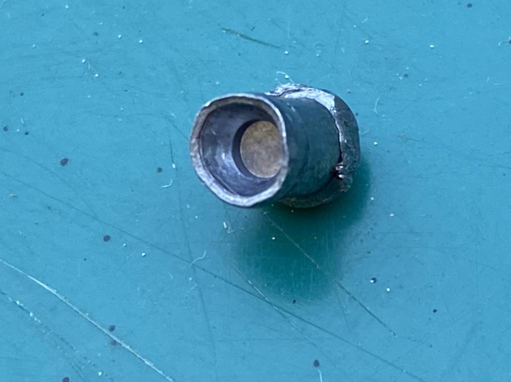

I've taken 2 vital shots recently both at 25 yards and both ran out steam within 10-15 seconds and didn't get more than 10 feet away with easy follow up head shots. Both times I recovered the pellet just under the skin so perfect amount of penetration. POI is right behind the shoulder/front leg. Very happy with current setup because I know a headshot will have pass through but have the option to take safe vital shots. I know the .177 hades WILL pass through vital at around 700FPS at muzzle when target is at 25 yards.

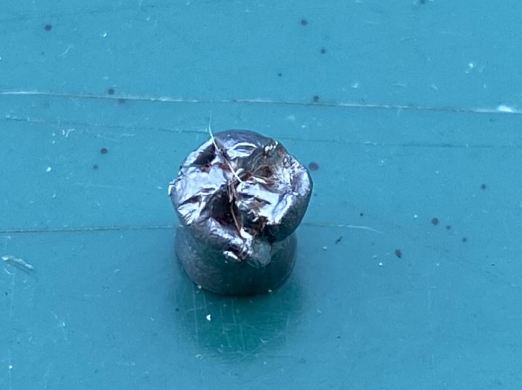

This time the recovered pellet has massive expansion and most likely hit a bone with bent skirt indicating tumbling.
