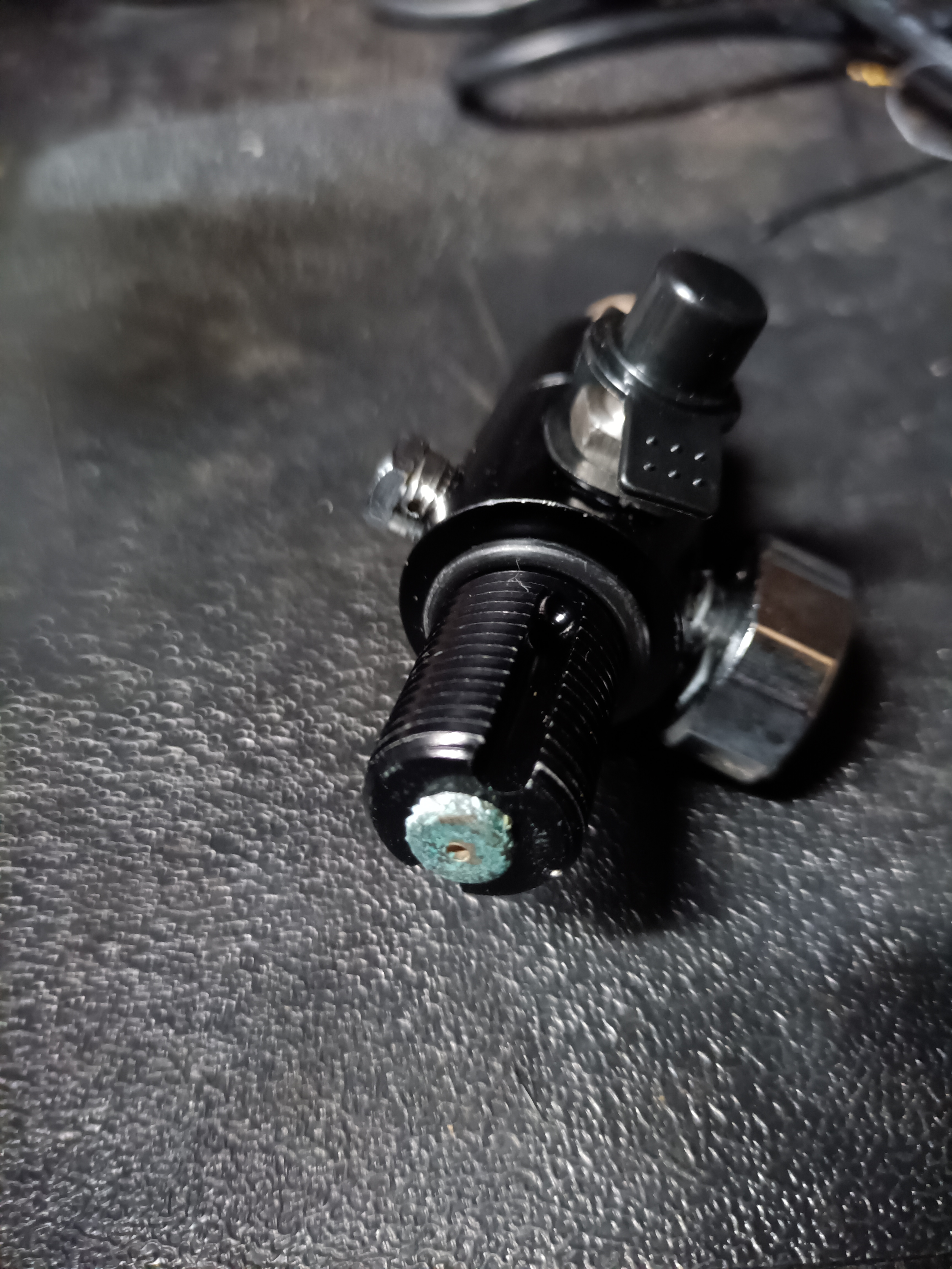

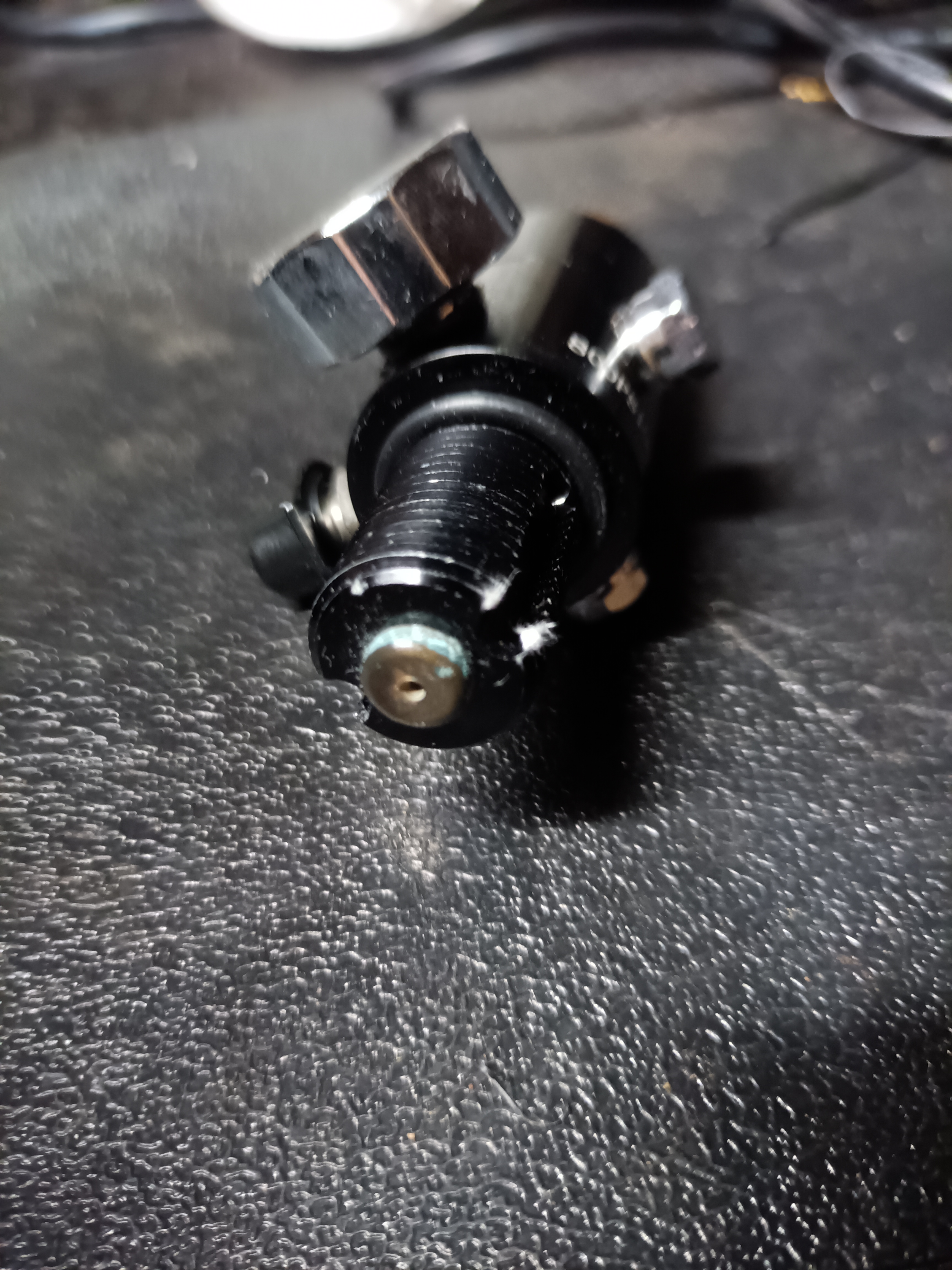

after sorting my pcp parts box today, i found some used regulator, which i had not in use for some months.
It was screwed on an 0,4 aluminium tank and was not used very often then it was attached on a bottle.
I did not seen this rust on the brass inlet hole after screw it from the bottle, the bottle is now in use with an other regulator and this regulator was in the box for a few months now (its dry in the box).
I think my air from my yong heng / Tuxing compressors are not dry enough, so i get moisture inside the tank.
Did you guys think that this is a safety issue? I cleaned the "rust", it goes away relatively good on the lower side and seem not to have penetrated the brass material.
Should i deflate the other bottles which are in use for safety reasons?
I don't know how the other regulators look from the inside, and if there is moisture inside them, but i think there will, because i inflate them all with the same compressors.
Here are some photos of the issue:
Have someone here seen this inside of their bottles?
