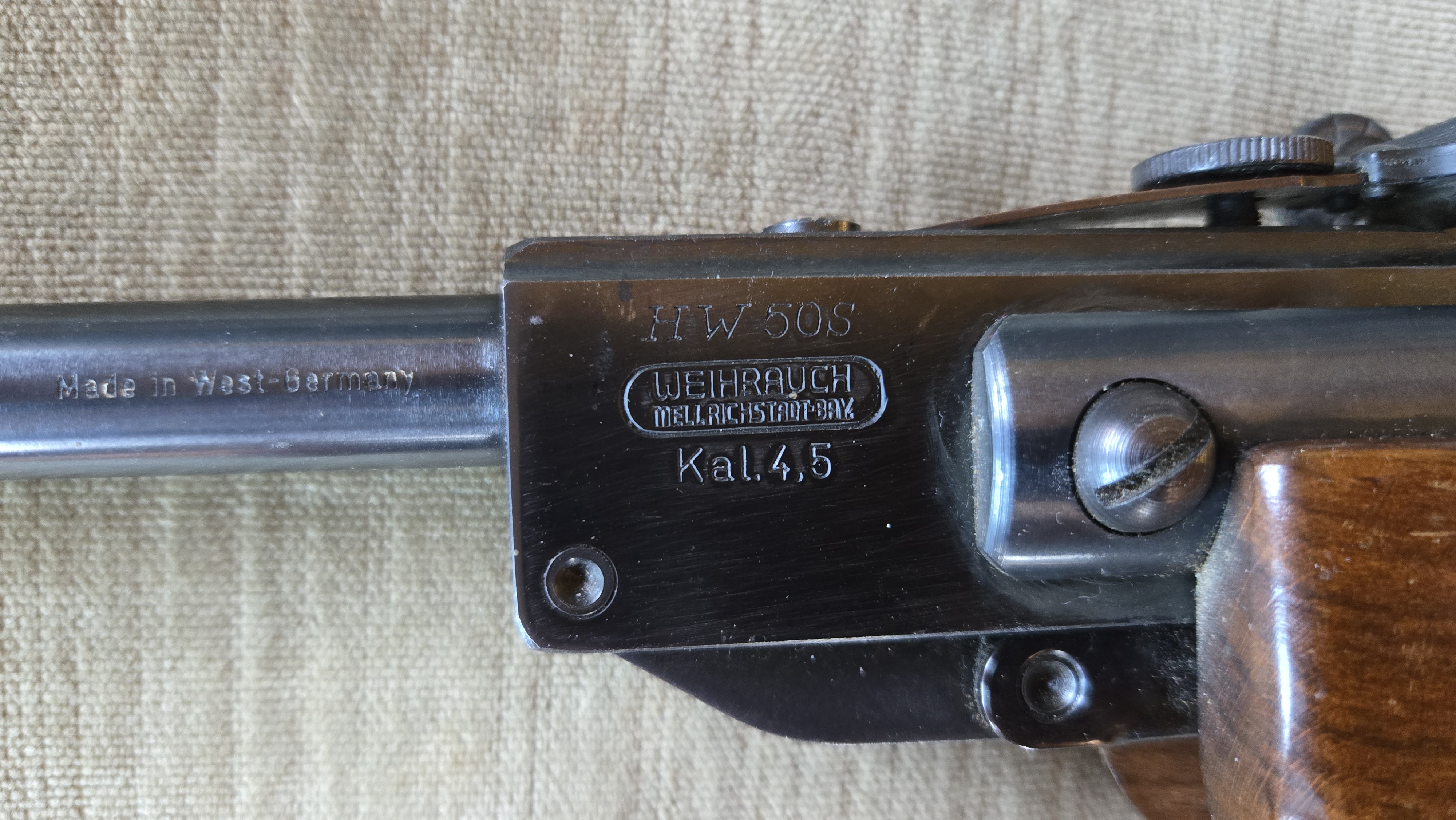

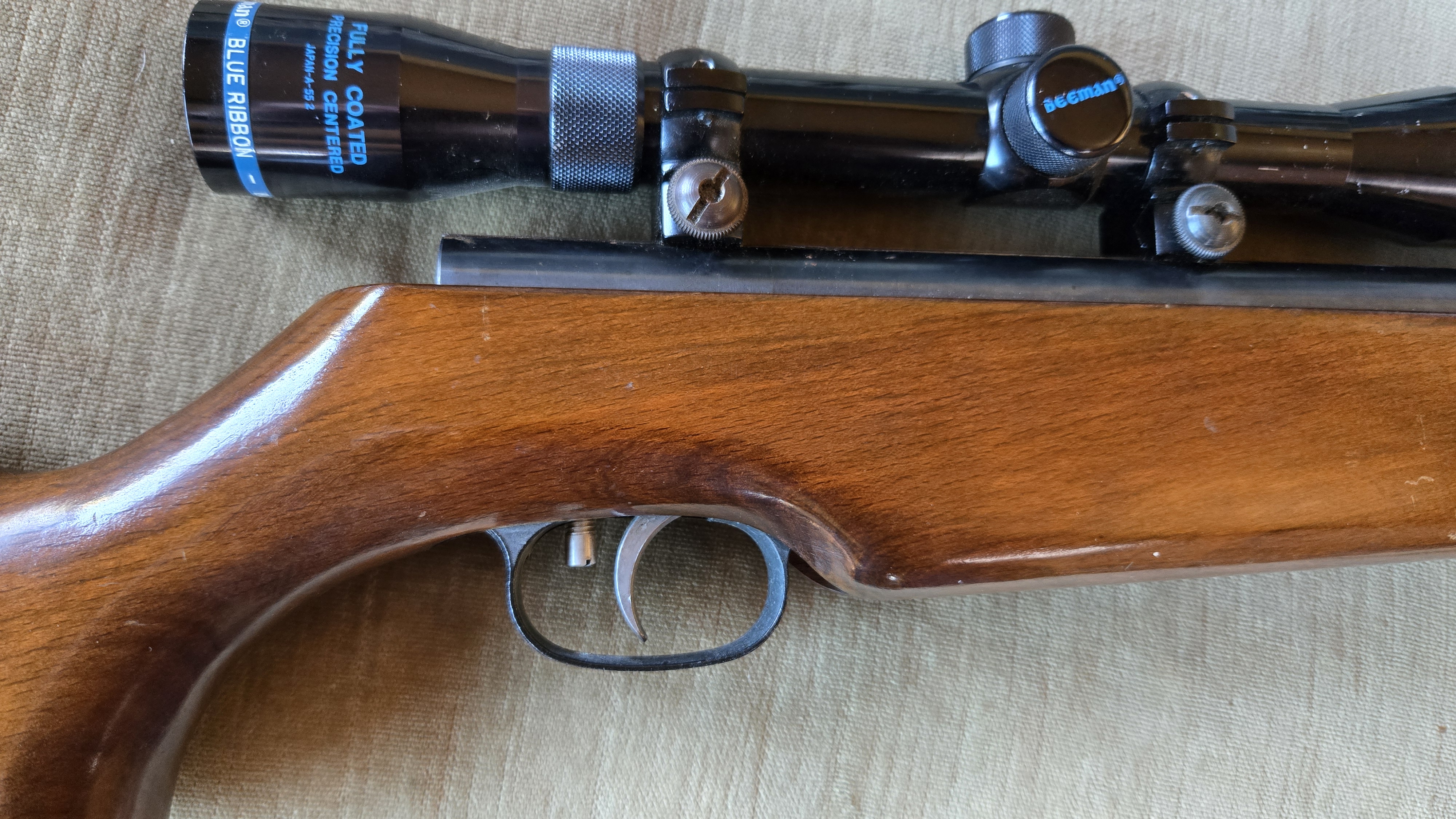

I have inherited a HW 50S (nice gesture from in-laws). Papers with the air gun show a date near 1979-80, made in West Germany. The air gun does not have a safety lever shown in manuals that I have read, videos demonstrating, reviewing this model. I see no visible safety mechanism at back of barrow. After loading pellet and cocking gun, trigger seems to pressure a trigger point, but not firing. Am I missing a safety somewhere else? Do I have a malfunction? Air gun has been sitting unused probably 10 yrs. Thoughts on safety location and other next steps? Thx!

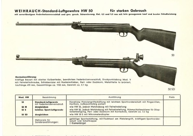

Congrats on a great get - the HW 50 is one of my all-time faves. The stock is actually the factory upgrade "Monte Carlo" one, which Beeman put on all his HW 50's for a couple years before the R8 came out (which was the same action with plastic piston seal, crossbolt safety, and new stock). Specie's pic show the standard slender finger-groove wood seen on most examples.
It does not have a safety and as already described, the thick brown factory grease is probably gumming up the trigger. Especially if the gun was stored standing on its butt, that stuff migrates aft and creates a right mess.

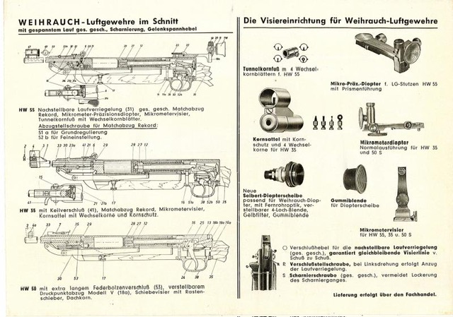

Quick historical note - your gun is the first type of HW 50, which was made from around 1951 to 1998 or so. A lovely, solid design characterized by the thread-off rear section to access the spring and piston. There were MANY options and variations of it over the years - different triggers, with and without safety, leather and plastic seals, many different stocks, etc. There was also a nice target rifle, the HW 55, built around the same basic action.
The popular rifle which is now called the "HW 50" - and probably the subject of the video you mentioned - is quite different. The action is dimensionally similar to the old one (to the point they can interchange stocks), but internally it is different. It has a bigger piston, longer stroke (thus more power), and a different method of dismantling. It was originally called the "HW 99," after the year of its introduction, and that name is still used in the UK.
