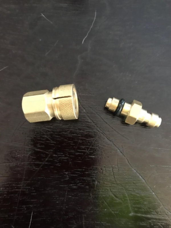

I have a Hatsan Lightning Compressor and three tanks, 2 are small 90 ci Ninja's and the other is a Scott SCBA tank that is still 2 years from end of life (without recertification). I bought a gold filter from ebay and it was the part that failed when the quick connect collar split right around 4300 PSI and it spit the whip with male to male out at my head.

PS - This is the part that broke...

I was using a Stikman fill station on the SCBA tank, and then a male to male connector off the gold air filter. Thats the part that failed and it shot that connector with the stikman whip at my head. I had just about finished closing the tank valve so not sure if it was that or the check valve, but it didn't whip around. I imagine that it would have taken a nice chunk out of my nose had it hit though.

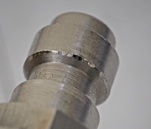

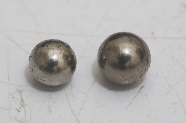

I believe the problem of the OP's brass connector that had the retaining ring cracked open during use is not so much due to poor workmanship but material defects that cannot be detected visually. Are stainless steel connectors a lot safer ? I used to believe so but I started to doubt after I have taken a close examination to my stainless steel connectors recently. The material is actually rather soft as evidenced by dents on the male connector as well as the balls on the female connector. The balls in these stainless connectors are smaller than those in the brass type so the concentration of stress higher. I am not trusting the connectors I have got in hands anymore, brass or stainless. If anyone knows where I can get more quality connectors, I would like to hear it.
dents on the mail connector

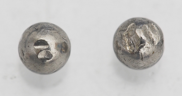

dents on the balls
the ball on the left is from stainless connector, that on the right side is from the brass type :
1538231256_8514777585baf8bd82b1a55.02650773_stainless QD ball ( left ) brass ( right ) low resol.jpg
