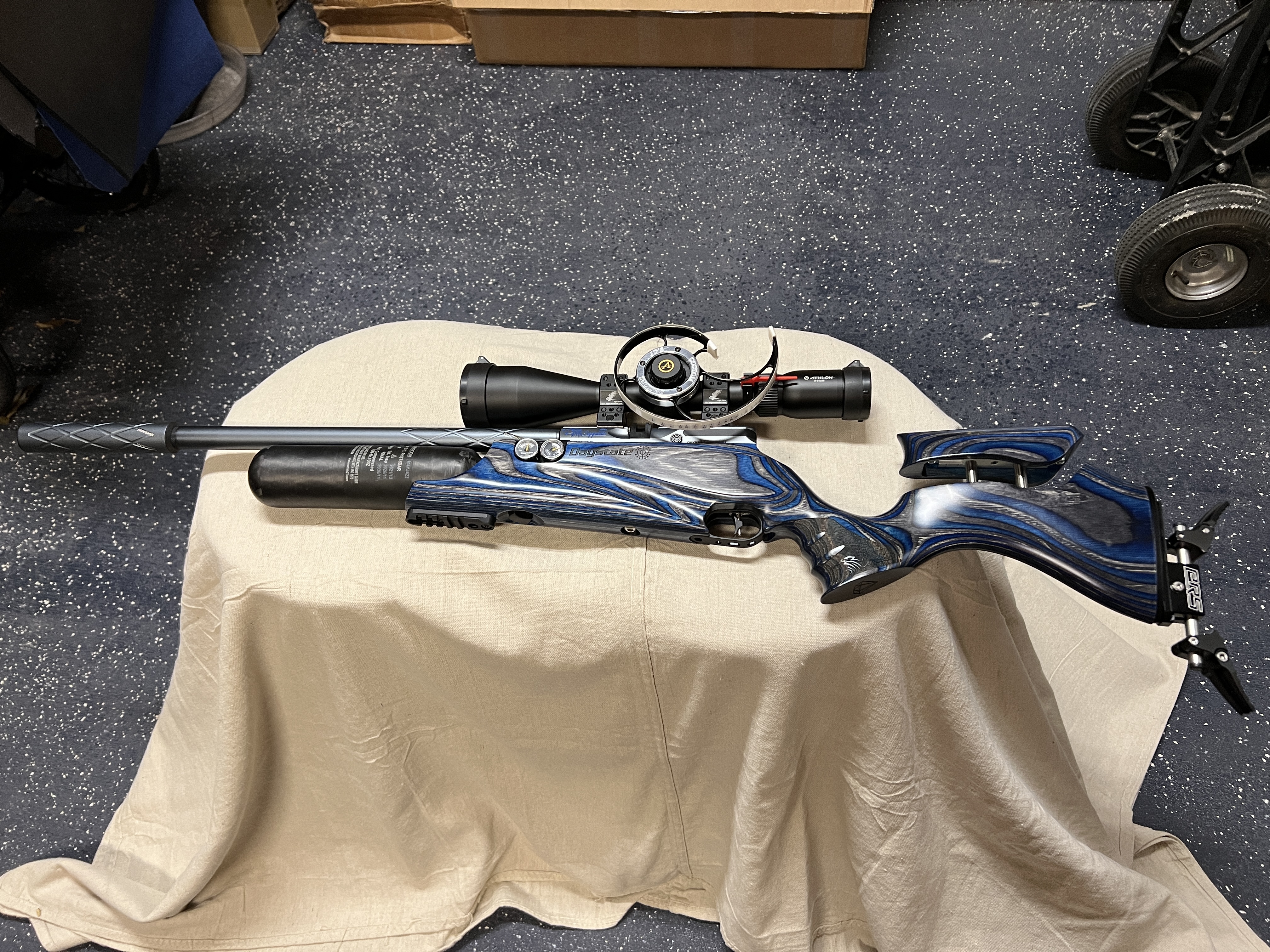

I absolutely 💯 % enjoy my Wolverine .177 Sapphire Edition!!!
The Wolverine with the adjustable cheek comb fits me like a glove.
Thus I decided to make the Wolverine Sapphire Edition my primary HFT rig and topped it off with a Sightron S-Tac 4-20x50.

I also Decided to use the same platform in .25 for my EFT rig. Yep, that hurt the wallet. $$$
Well - Imagine my surprise when the brand spanky new .25 Sapphire was shooting all over the place. WTH?
Long story short 🫥
After checking all fitment and adjustment points it turned out the problem was clipping at the moderator😳
Why? hell if i knew so....
I Returned it to AOA who immediately investigated and discovered that the factory had installed a .22 baffle in the .25 moderator.
Easy fix but shame on DayState’s QA.
I will be very happy to get the .25 Sapphire back this week so I can get it re-scoped and put it through the paces 20-100 yards.
Time to get ready for some serious fun at EFT matches.
Sharing this so anyone who is having POI issues can try removing the moderator and see if the problem goes away.
If one QA problem “got out” it’s likely others did as well.

Wanted to update this thread regarding the .25 wolverine sapphire. AOA never could fix this particular gun and I was unwilling to accept a fix that required they increase the size opening of the moderator. After two separate returns to AOA - i got a full refund. Problem was a lousy shipping container that allowed the gun to ride on its nose and thus tweaked the shroud assembly / no parts equals no fix And altering a premium gun from original OEM specs is stupid. My .177 sapphire continues to be a stellar shooter.

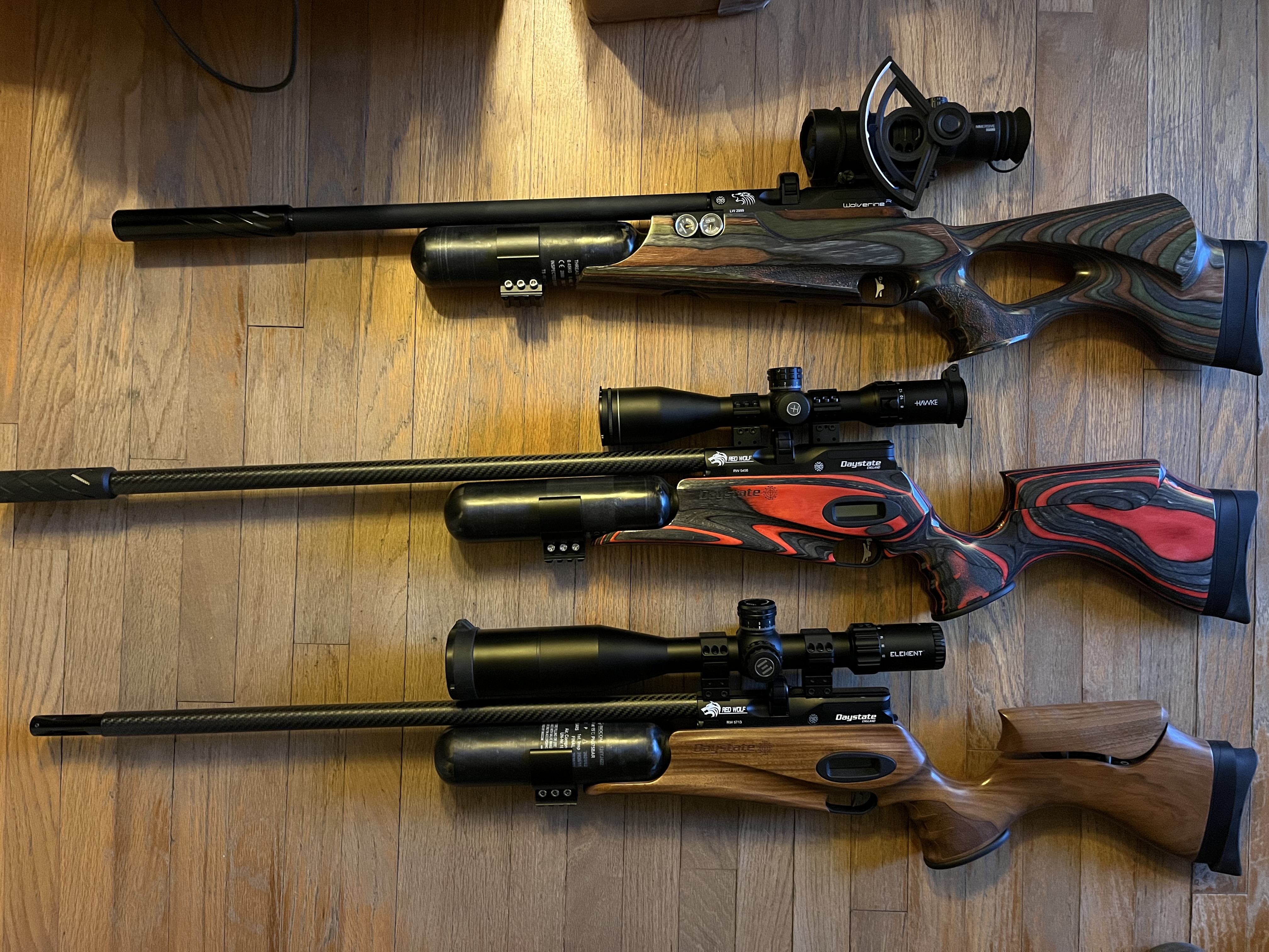

Still enjoying my .177 sapphire but chose a Redwolf in .25 for EFT
Which one is more accurate, the Wolverine or Red Wolf? That midnight Red Wolf looks nice too.
I prefer the Redwolf because it’s quieter, more air efficient, higher shot count. But you have a battery to contend with and it’s slightly heavier. Accuracy is about the same. They are both perfect in their own ways.
