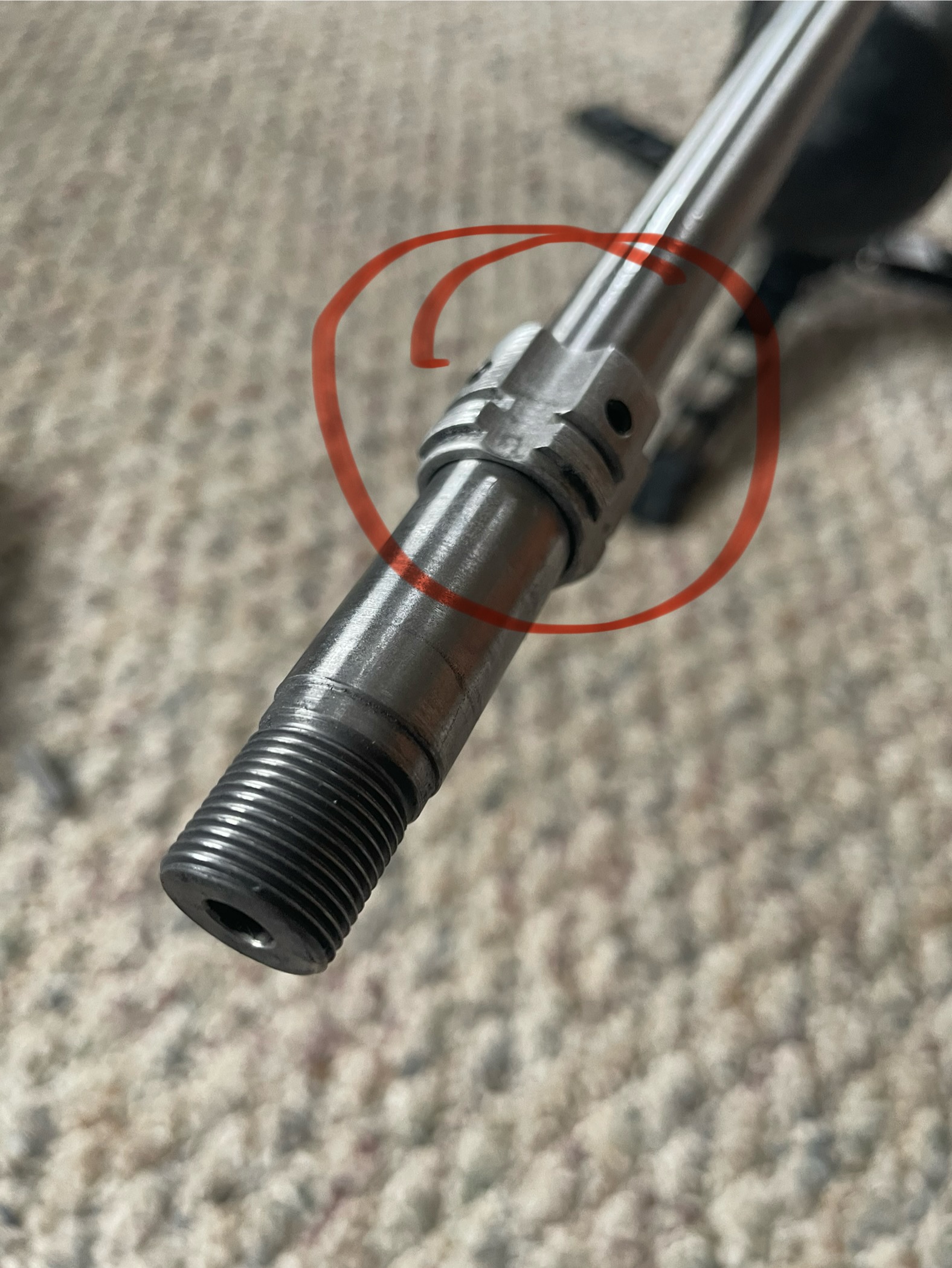

No. The likely cause is the front shroud support. It has an o-ring on it and its really freaking tight in the shroud.
In my picture below, I show the front shroud support. Note that I took the o-ring off mine. The barrel and shroud are stiff enough that the o-ring caused me more problems keeping the shroud straight than it solved.
If your o-ring is twisted or broken, just screw the shroud back on without the o-ring - you will see the tight tolerance.
And remember to tighten the grub screws in the breech end shroud support. If you have been shipping the air rifle around for service, even more reason that screws may need tightening.
-Ed

i suspect that the grub holes for the shroud supports were not lined up in the grub hole spots before someone tightened them, thus causing barrel / shroud deflection ?
I’m reasonably certain that the reason you’re getting shroud deflection as you pull the shroud back is because the o-ring on the muzzle barrel support has come off and is wedged between shroud and barrel - causing the deflection.
This is exactly what I experienced. Its also the reason I got rid of that o-ring - I got tired of replacing it.
It is a very tight tolerance to slide the shroud, especially the threads on the shroud, across that o-ring. You can lube that o-ring and slide the shroud on, but the next time you take the shroud off the o-ring will come off and do what you are experiencing.
If you screw the shroud on without the o-ring and push the shroud down, you will see very little “play” before you hear the shroud contact the top of the barrel support.
For this reason, I feel the o-ring is unnecessary. I WANT my barrel to free float within the shroud. I don’t want it pinned against the inside of the shroud via rubber - which will expand and contract via temperature changes. If you screw the shroud on tight, it is stiff enough to keep barrel centered. My accuracy improved when I deleted this o-ring. I’m a target shooter, so I have scores that showed the improvement.
In summary, its up to you if you want to keep that o-ring. I use a Huma Mod 30 moderator and experience no clipping without the o-ring.
Now back to your current situation. If the shroud is unscrewed from the threads and its not pulling straight back on the barrel, you are just fighting against a rubber o-ring. You should be able to twist and move shroud in any direction as you pull (left, right, up or down towards air bottle) because its just rubber that is offering the resistance.
-Ed
-Ed
