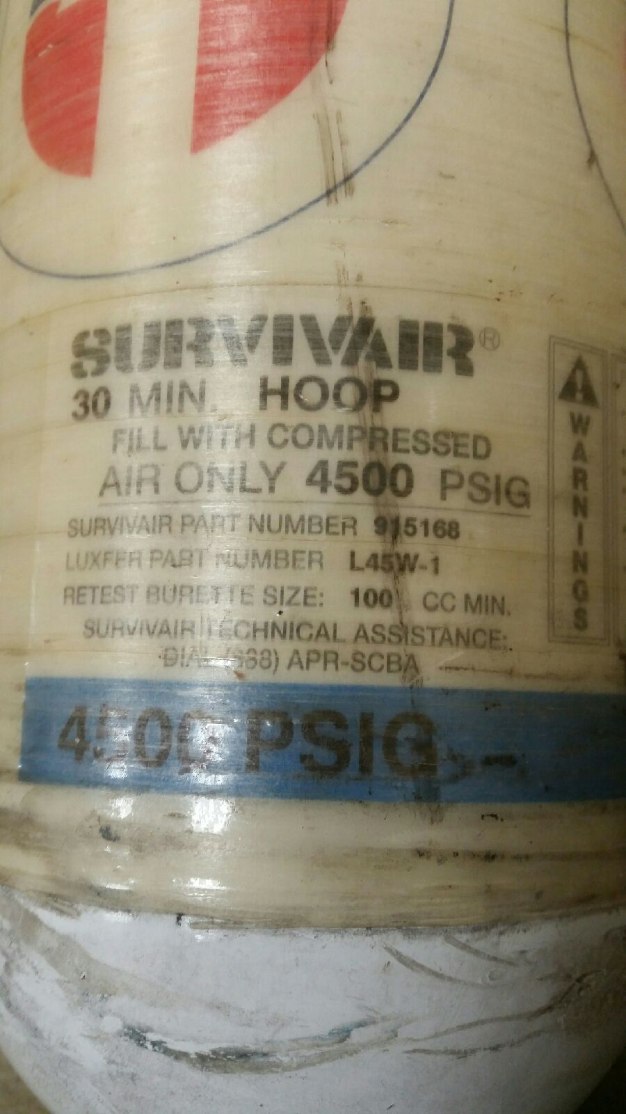

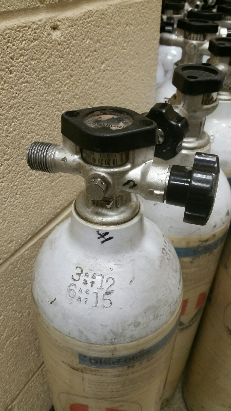

I'm new to pcp and still learning. That said, I have a friend who is a volunteer at our local Firehouse and can get used SCBA bottles. What it's necessary for me to use one of these to fill a rifle? see attached photo. Thanks in advance.
you would only need a fill station. (and any probes specifically for your guns if they do not have a foster fitting on them)
if you want a cheap one...this one....
https://www.ebay.com/itm/6000PSI-CGA347-Paintball-PCP-SCBA-Fill-Station-Charging-Adapter-With-24-Hose/283365964074?epid=10015847425&hash=item41f9ed792a:g:M0UAAOSwkAxcWJ5s
and a more expensive one but good quality is the stikman....
https://www.ebay.com/itm/STIKMAN-SCBA-PCP-Fill-System/323720604238?hash=item4b5f406a4e:g:1FcAAOSwIr5cMV~y&frcectupt=true
i have had the cheap one for a while now,
and it does a fine job of filling my guns.
