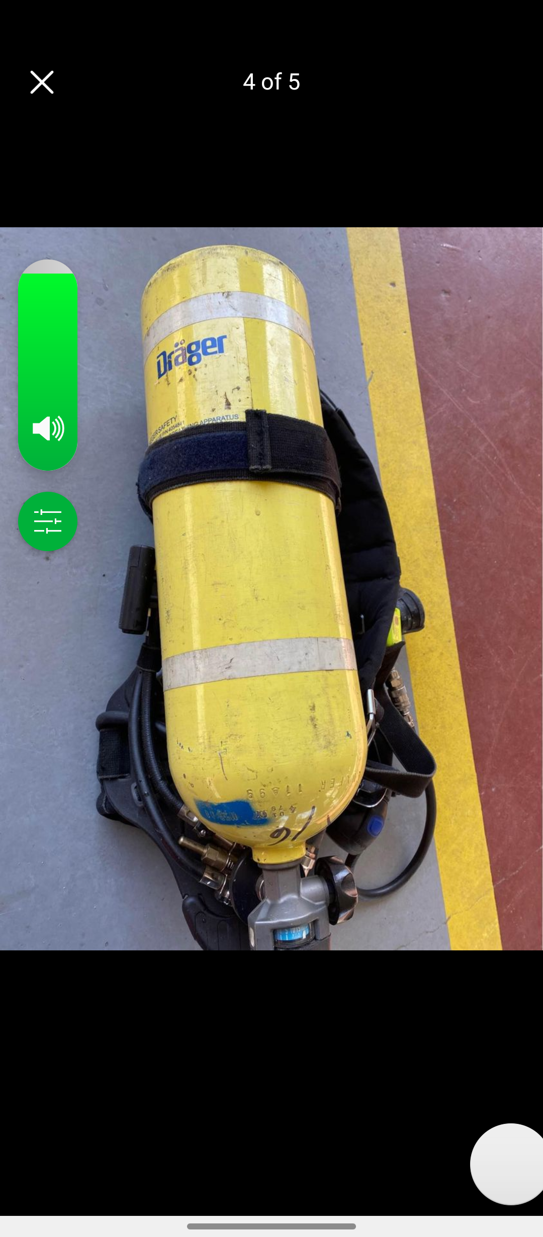

I found this used just curious if this is using a fosters connector? What if anything would have to be done to the SCBA bottle to make it work for a PCP filling station.

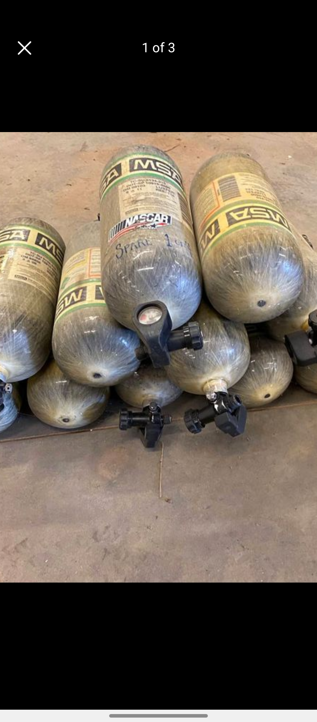

Would something like this work?

What you see on the end appears to be a dedicated CGA 347 for a breathing air unit. You need something like this to go to you 8mm foster. Amazon Link You also want to check the condition inside and out, see it you can make out dates of MFG and last hydro if you can. And make sure it's 4500 psi instead of 2216 psi.

I would be surprised if that was a 4500 psi tank. You want to get the carbon fiber 4500 or higher PSI per the other posts. If I am reading the date right, 11 * 99, it is also 23+ years old which means if it is aluminum, it can't be recertified / hydro tested even if you wanted to. I wouldn't use a 23 year old aluminum tank at all even if it were given to me. If it is steel, which is very unlikely for an SCBA tank (TOO HEAVY), there is no expiration date, they just needs to be hydro tested. My local welding shop has oxygen and acetylene bottles with swastikas on them dated 1942 and they are still good and hydro'd within a year or two. Many newer carbon fiber SCBA tanks are engineered to be used for 30 years. The government set the use range for carbon fiber tanks to 15, though they feds are allowing recertification of CF tanks older than 15.

That looks like an aluminum tank and is likely 3000 psi.. You can look for 4500 psi scba tank on ebay.. usually 45 or 60 minutes tanks.. All of those I mention should work with the Amazon link I gave you. As for shots per fill etc.. All these things are variable for the type and pressure / output / caliber etc etc of the pcp you are using so it's impossible to calculate without that information. On second look.. That appears to be a 2216 scba tank = almost worthless as even the puniest pcp's need 2900 psi to give enough shots to be worth it.
