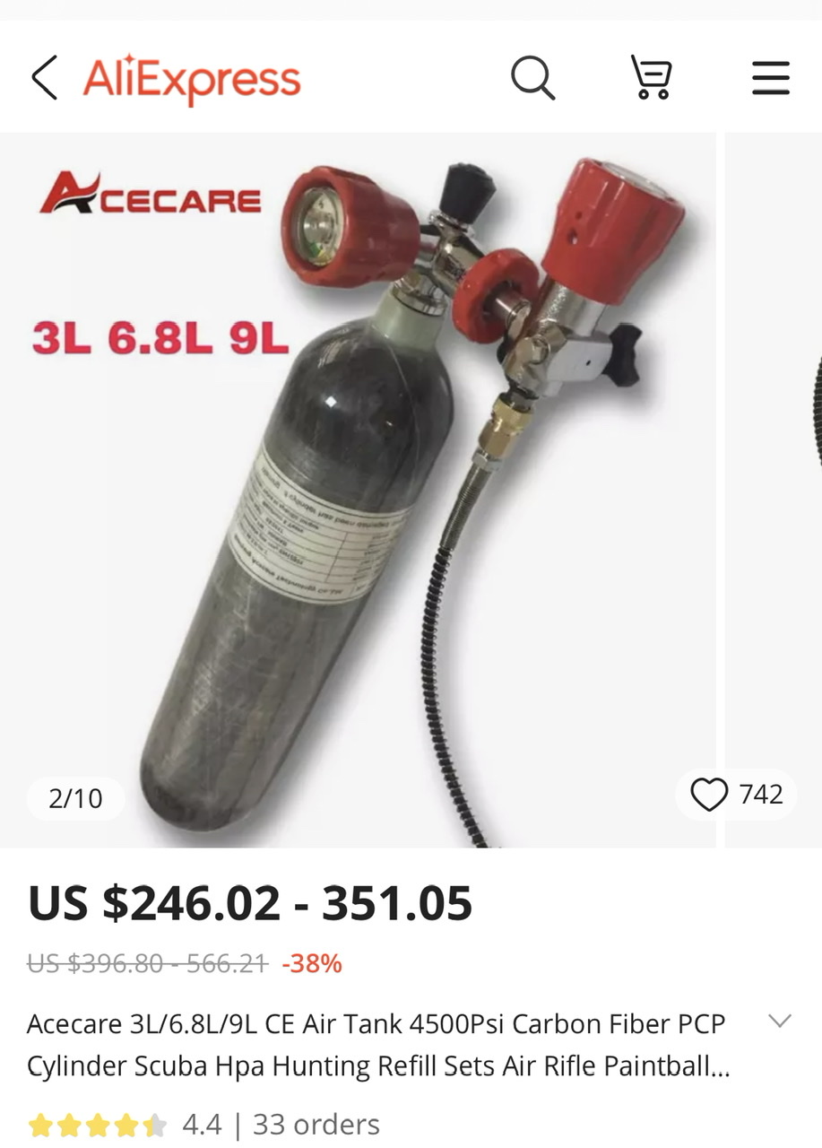

I need to purchase a tank to fill my guns in the field. I’m looking for a tank that I could carry with me for a 300cc tank and 4500 max fill pressure on the gun but adjustable to shoot down to 3000 psi or maybe lower for simple plinking with lighter projectiles which is fine with me. Maybe tether with a long fill hose if possible. what size/type tank is pushing it a bit? still possible to be carried in a backpack. 3 L, 6.8 L 9L? Being compact and light is of secondary importance I am guessing 6.8 L is what I am looking for but am not confident

well, 3L is about 5X20" and maybe 20lbs ajd goes quite a ways on fills .. im pretty fit and wouldnt want to hike more than a few hundred yards with it .. in a vehicle yeah its perfect size if you dont want to load up a big pile of gear .. bigger than that i wouldnt want to carry around at all, just to a site if i needed more air than tje 3L .. i have a '500cc' bottle i can use for several fills and that works for me for most sitiations i get imto headed to the weeds and whatnot ..
The 3L is 4.5 inches in diameter and 18 inches long and weighs under 5 lbs. So it is a bit taller than my 100ci buddy bottle and less than a pound heavier.
You also need to remember the valve system will add three or four inches to the height of the bottle. Still my guess is it will be fine in a backpack and not overly heavy if you are wanting to take it on a hike.
The 6.8 is near 8in by 24 inches with out the valve and weighs in at 8.5lb probly just under 10lb with your valve and hose. So it will still fit in some packs and it still is not overly heavy.

Ok this is all helpful. I’m leaning towards the larger tank for the reasons you said. Any ballpark for how many refills (more or less) I might get taking a 300cc tank from 3000 psi to say 4000 psi, if it’s a 3L 4500 psi tank?

The refill calculator has me thinking a 3L / 183 cubic inch tank would definitely do it, giving me 15 - 28 fills depending on how full I want to fill the gun.
I wonder if the Acecare gauge and fill adapter would screw onto the inexpensive used scba tanks that people have been getting from eBay vendors?
