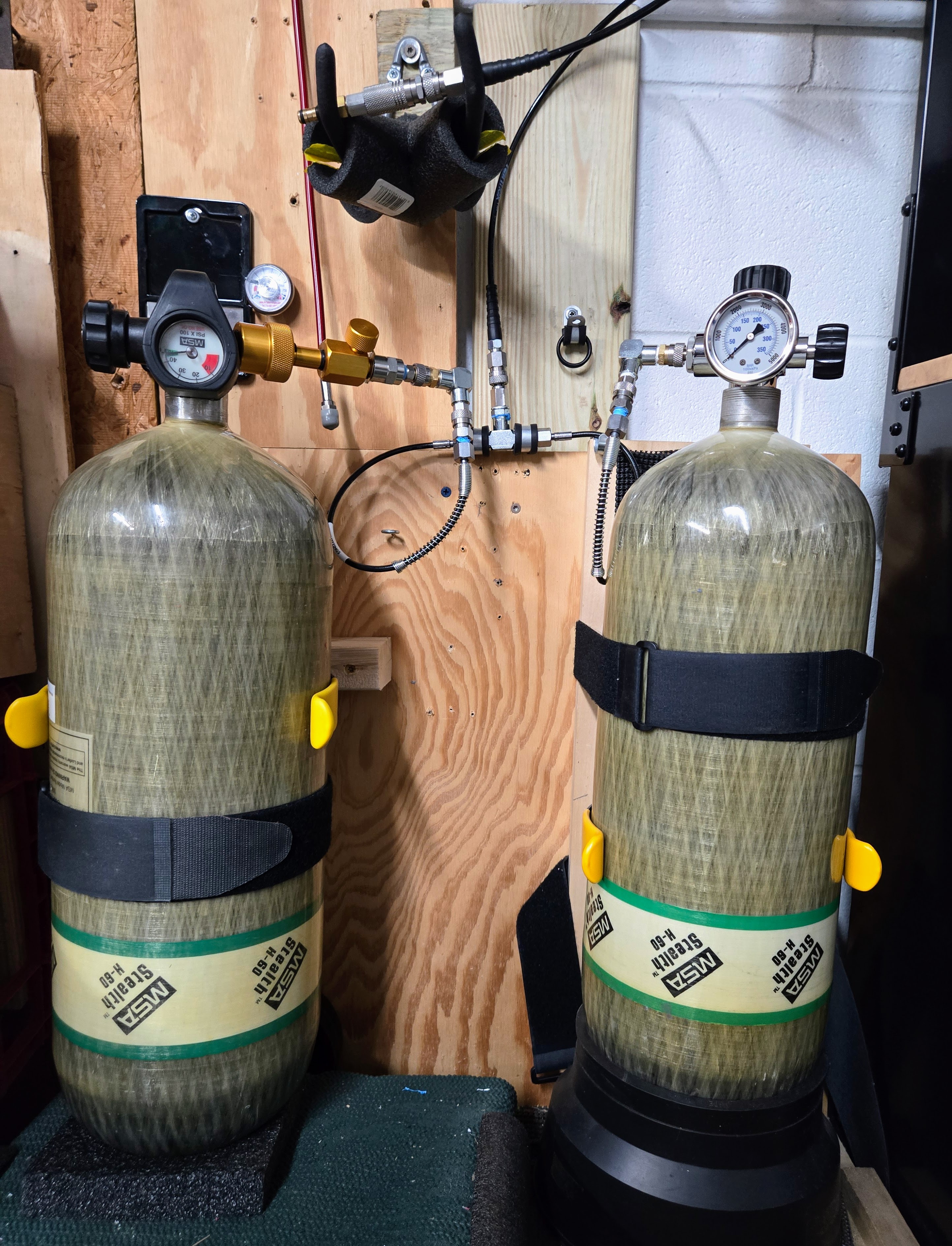

The industry thrives on various misconceptions and dangers . It compels folks to be wary of the many dangers with high pressure air. And there are , for instance some off shore fittings and hoses are not up to the tasks of 4500 psi . I worry more about a fitting or hose failing than my tanks. In fact , I use 21 year old tanks for my fill setup and have every confidence in their safety and construction. If I was in the business of selling new tanks every several years.........No , I couldn't look someone straight in the face and say "WOW , that's a time bomb just waiting to take you out".............
These are choices we must all make and accept responsibility. I know I'm on a rant here , but , I think that there are more reasonable options available.
My tanks................... DOB 2003

Those tanks look pristine. If I knew where they came from, and that they had been fed dry air their whole life, I would have no issues using them either . . .

My tank is an expired fireman's tank, a Scott. It has no visible damage to the carbon fiber and I use it with confidence. I am very convinced that it will leak if it ever fails. I see zero risk it will explode.
