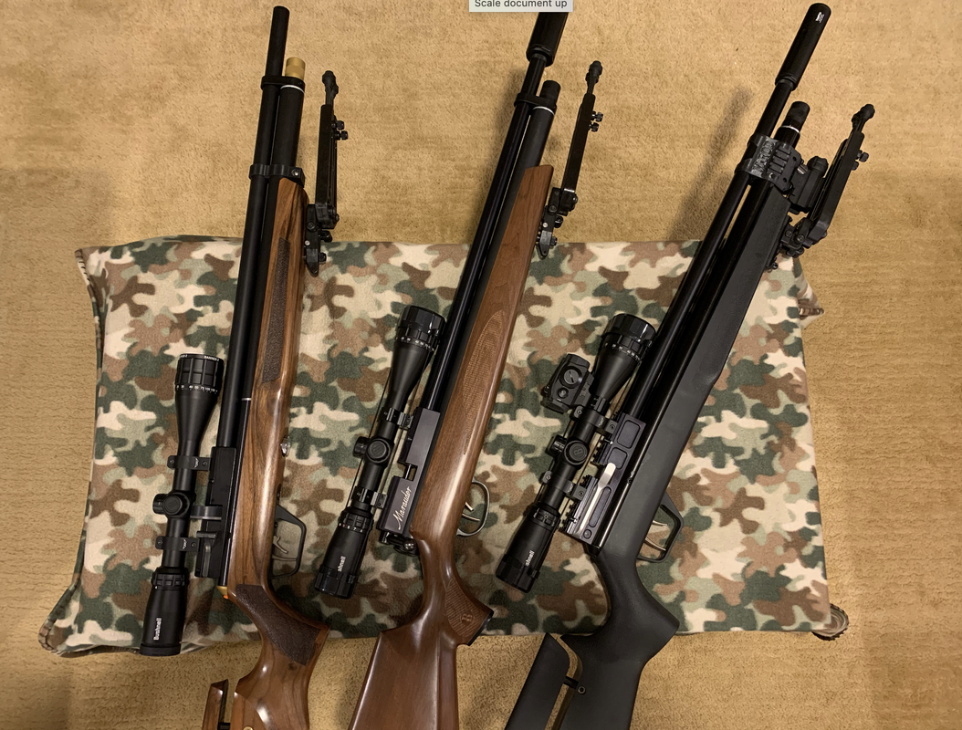

What he is referring to, I think, is side lever repeater vs a bolt repeater. The Marauder is a bolt action rifle. Many new, but not all, and many are very high dollar guns, are bolt action. But side lever is the coming thing. I hate to show this picture, but here goes, two side lever Marauders and one bolt. Left to right, Gen 2, unregulated, side lever, as equipped is 8.5 pounds. Next up is a Gen 1, bolt action, regulated, "special" valve, as equipped 9.4 pounds. And then my Gen 2 Super Light with side lever, regulated, 60 fpe, as equipped 8.6 pounds (light, red dot, scope, bipod and suppressor). It would not be easy to duplicate my Super Light and very expensive to do so. An aluminum tube and the synthetic (SynRod) stock knock down about two pounds give or take.
