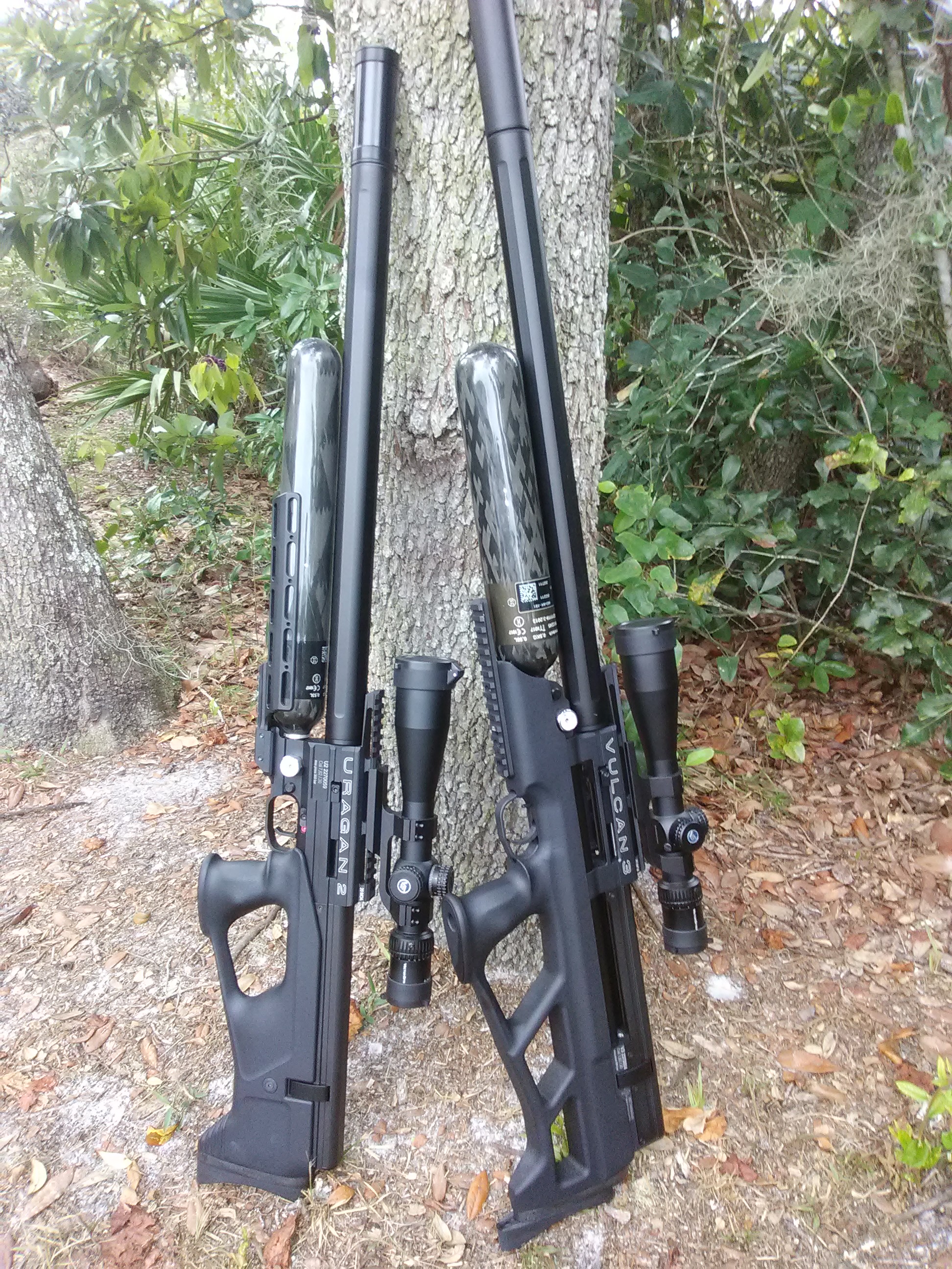

I've got 6 Vector Veyron 6-24x44s (30mm tubes) here's pic on AGT Uragan .25. AGT required cantilever mounts, Wildcat, Vet and your Vet 2 are clamp on with provided mounts. Flip covers and sunshade filter included. WM
Reactions: ocdairgunner
