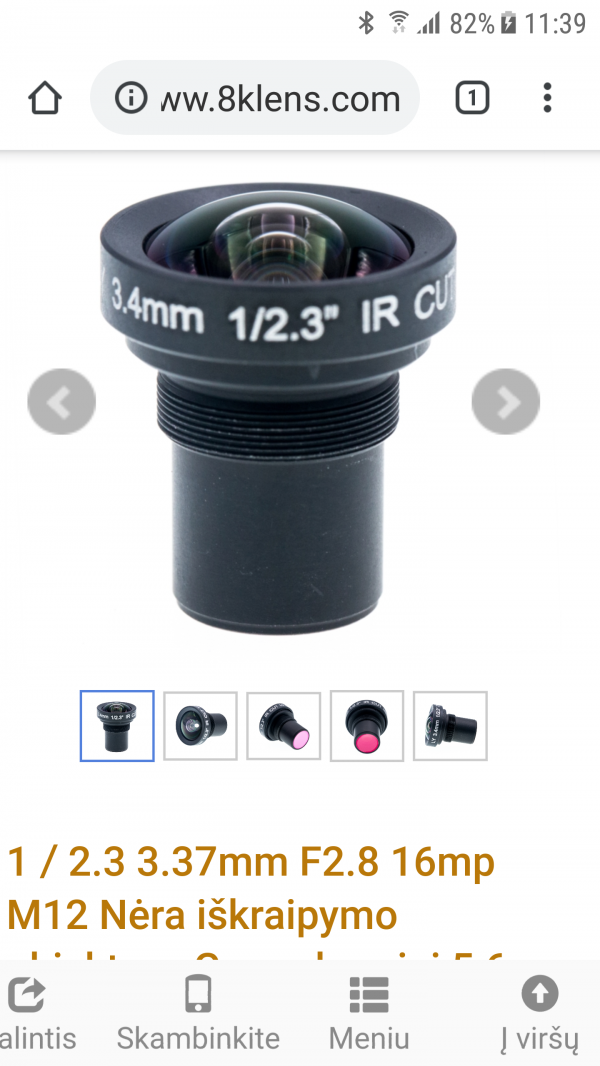

All of that was a preface to say, about 3.5 weeks ago I ordered two 16 Megapixel 3.4mm 4K High Resolution No distortion Lenses and will be testing them out on my Hero6 (5,6 and 7 all use the same lens) from China. I just received the order yesterday and I need to test the lenses out for clarity and distortion before I can recommend them to anyone else. They were not cheap as they were over $80 USD each but they may fit the bill. I will follow up. In the meantime, I will send you the company I ordered them from in a PM and if you want to risk it, you can order one for yourself.
Replacement lens warning:
A word of caution to any of you that are looking to score a replacement lens for your GoPro, because I have so many years of experience with this GoPro Scope camera setup, I have proven results that support the recommendations that I make for lens selection. Only use a lens between 3.4mm to 6mm in a scope camera configuration because if you use a lens stronger than 6mm, the image of the reticle will be so large in the frame that you will lose all of the scopes round picture framing. You will essentially end up with just the center of the crosshairs with an extremely narrow field of view. The only time you might get away with using a 6mm or larger is if you capture in 4K. This is because the image is extremely small in the frame due to the high resolution and the extra magnification of the lens will make the image look larger. The downside is because you are at a high resolution you will be at a low frame rate and will not see the pellet in flight.

I have been asking them on the regular about offering an assorted amount of SKU's so that existing and new customers have the ability to adapt to other uses. I think once the initial fit out stuff is complete, they may go that route. Lens options are a bit more complex as the market is at the mercy of the few lens producers that manufacturer direct replacement non distortion lenses. Companies like Rage Cam and BackBone are always an option but they both require a proprietary modification or kit changes to the actual camera. Simply unscrew stock and screw in replacement options are needed.
I have purchased a few from China and will be sharing my results soon.
