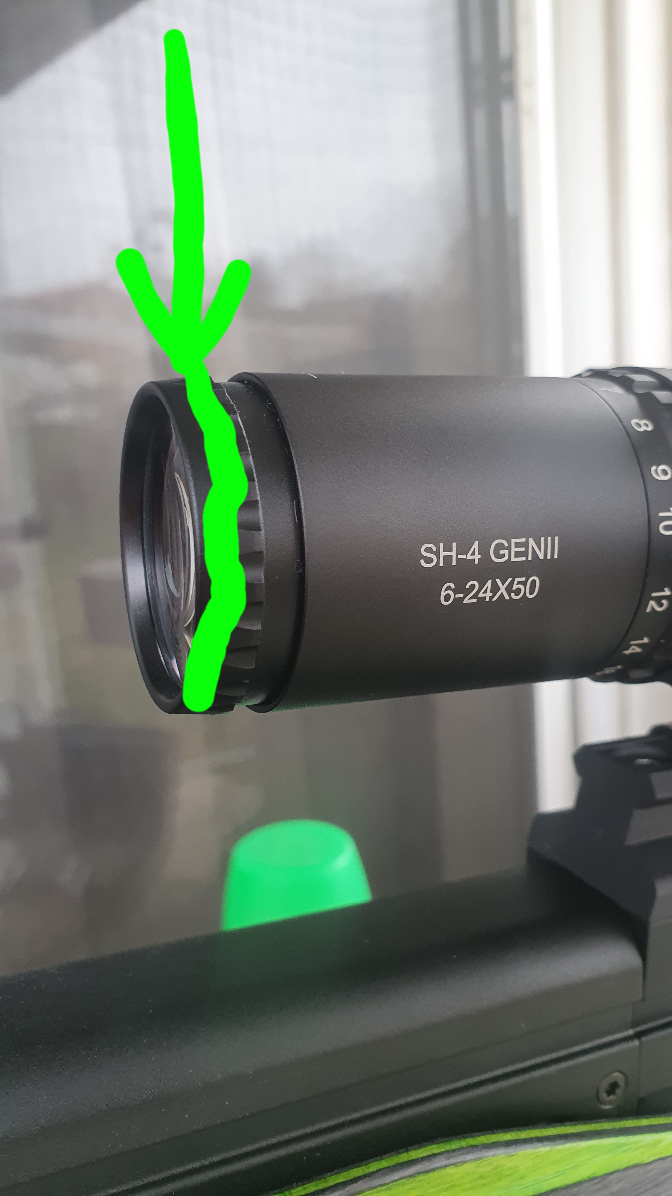

Have same problem, cause for me is the need to adjust eyepiece far out for a sharp reticle, leaves scope cap little room to grip.
i have that same problem sometimes,
i use electrical tape built up around the part of the occular focus that turns,
instead of the body of the scope.
