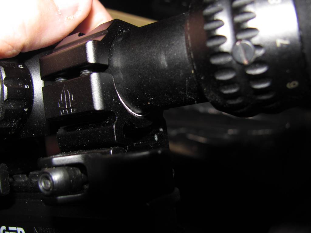

Same issue on my Avenger...ran out of elevation and still was 6" low....A landscaper left a business card so i cut a piece to fit rear ring and that fixed the problem...
others here have stated they found flashing under the rail...I did not want to remove my rail so I resorted to the shim method... I have done this in the past...so no big deal...
You can see the "shim"... white edge....think about .014"...
