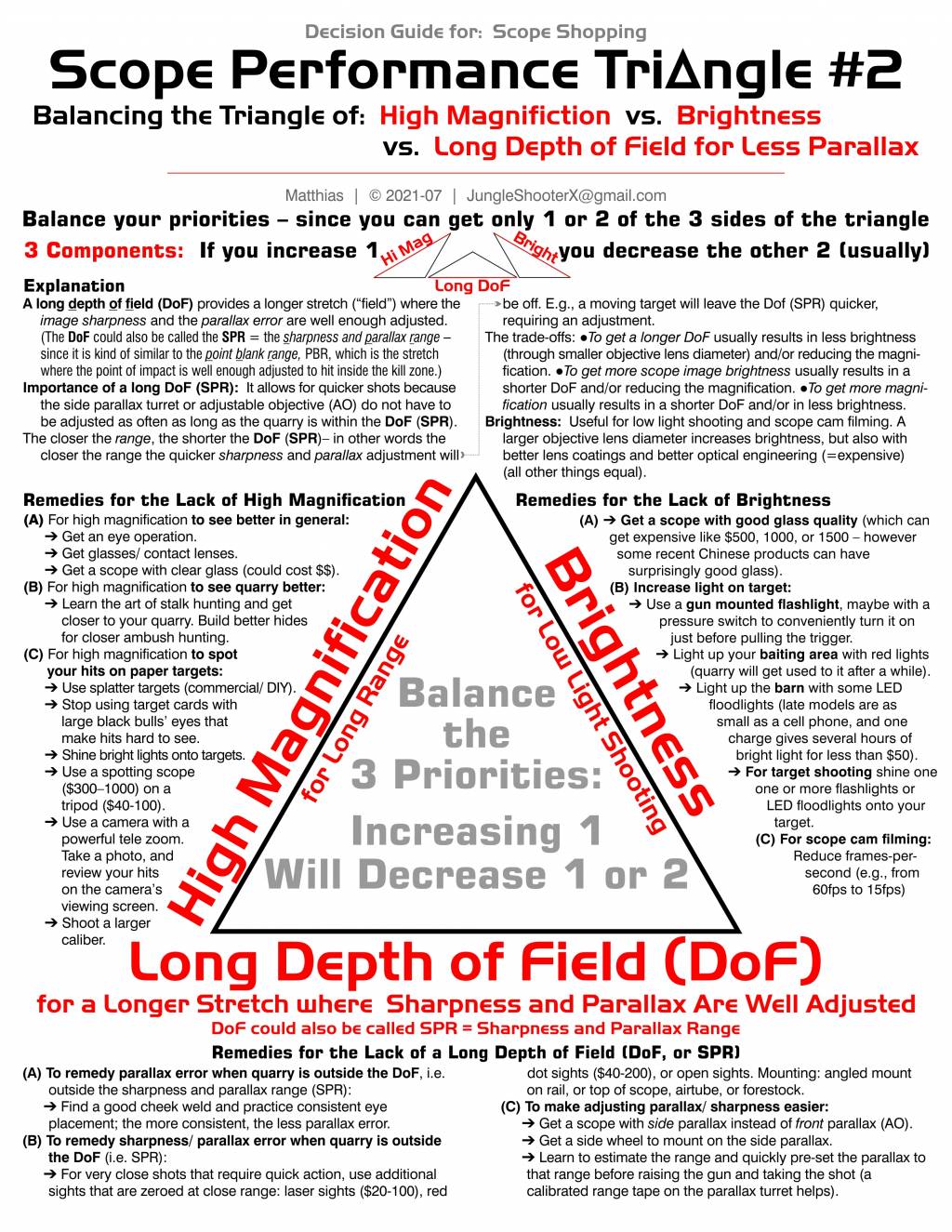

Here's a little diagram to show the problem of a shortdepth of field (DoF) — the shortness of the span where parallax and image sharpness are acceptable.
The DoF trade-offs are with the scope brightness and the magnification.... ➔ see the diagram. (The attached PDF is probably better quality than the image below.)
Matthias
Edit: Improved version, thank you Mark! 👍🏼
❌ Attachments: PDF and JPG of the same file:
SCOPE Triangle #2 — to Balance High Magnification + Depth of Field (for Less Parallax) + Brightnes
View attachment SCOPE Triangle 2 to Balance High Magnification Depth of Field for Less Parallax Brightness....pdf
SCOPE Triangle 2  to Balance High Magnification  Depth of Field for Less Parallax  Brightness....jpg

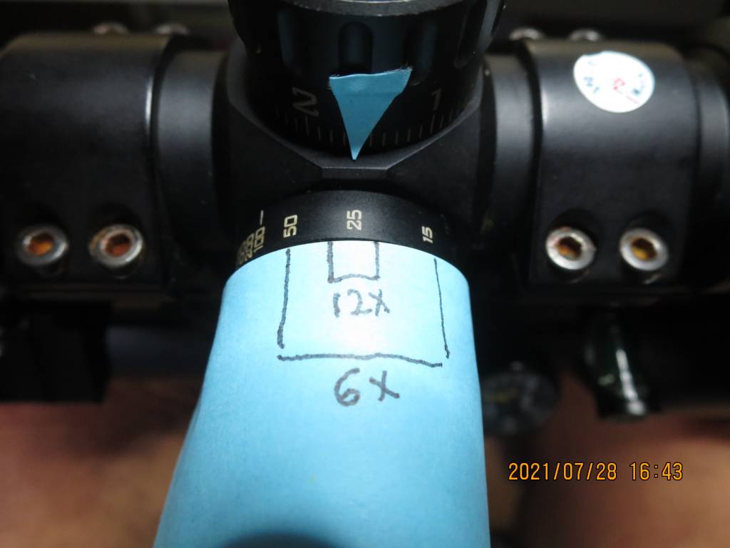

Hey Matthias! My pleasure share this out.
Hope this photo can clarify what I described other day. I hunt in the 20-40 yard ranges, with magnifications 5-6X, so set and forget with my scope is a help, no fiddling. I am using a USO TS-12 MHR FFP for demonstrating here.
Lucky USO provided an easy DOF 1/3's rule for me. Marked ranges are 15YD --> 25YD --> 50YD.
