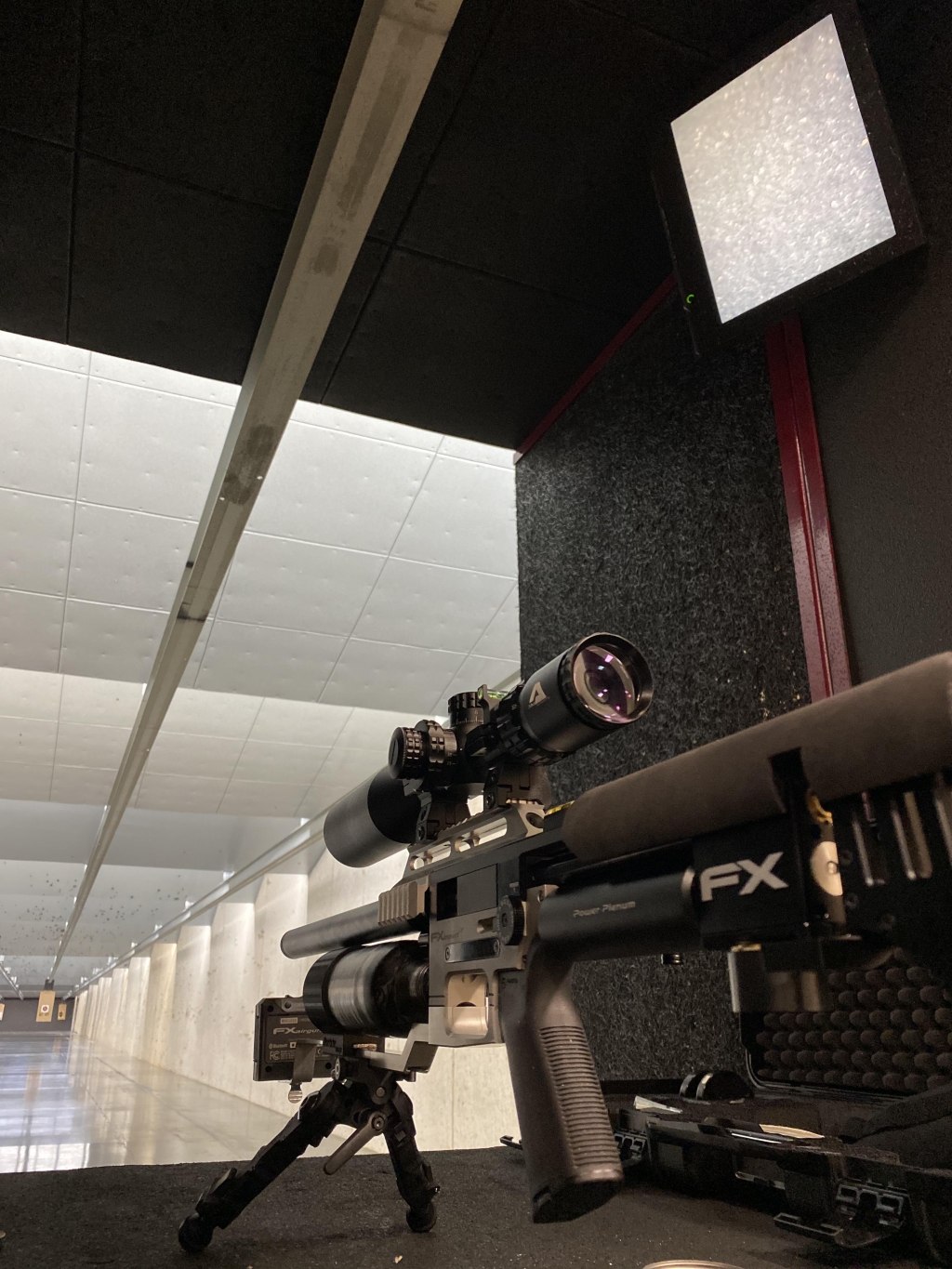

LegIt concerns about the turrets Geoff, and I have yet to give the Alpha a run through to check the repeatability, so the question remains up in the air for now.
IF I get a chance to wring it out, I will update you.
I never actually noticed the stiffness of the side focus turret until you called it out at the range today, now it has me wondering if it needs a little lube on the O ring or something along those lines. It bugs me now that you pointed it out LOL!
