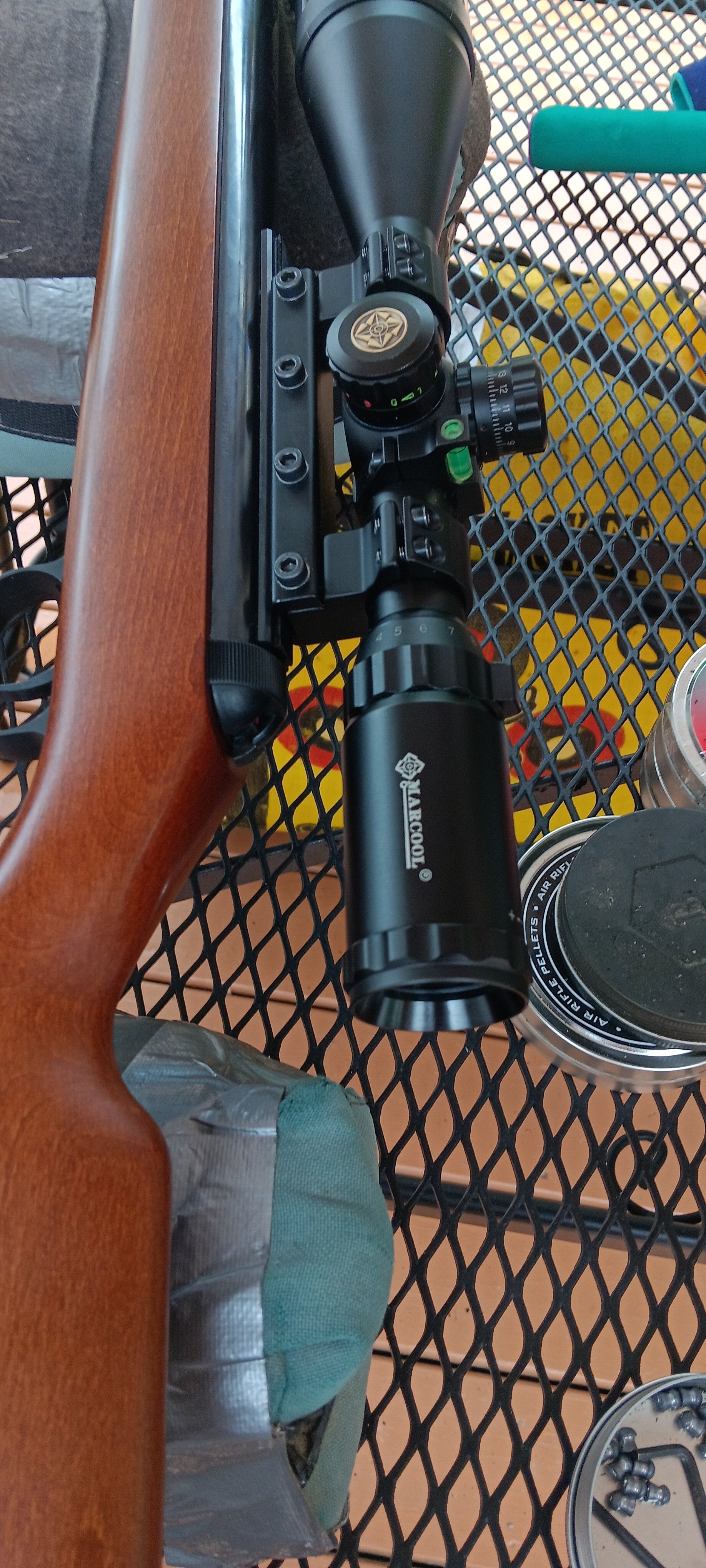

This what I ended up with. I think that 3-9 is enough.View attachment 443081
The scope in the picture doesn't have an adjustable objective. I have that scope with and without AO. Good scopes.
Without AO it's gonna be blurry above 4x at airgun ranges. Mine is still a little blurry at 40 yards at 9x. It has 100 yard parallax setting for centerfire rifles. I have that scope on a 17HMR because it has a 100 yard zero.
The same scope with AO is in focus down to ten yards at 9x. I use that scope to test airguns that I'm working on. I can't kill it. It's been on dozens of springers including three R1s and is still working even after rolling off the work bench on to the concrete floor.

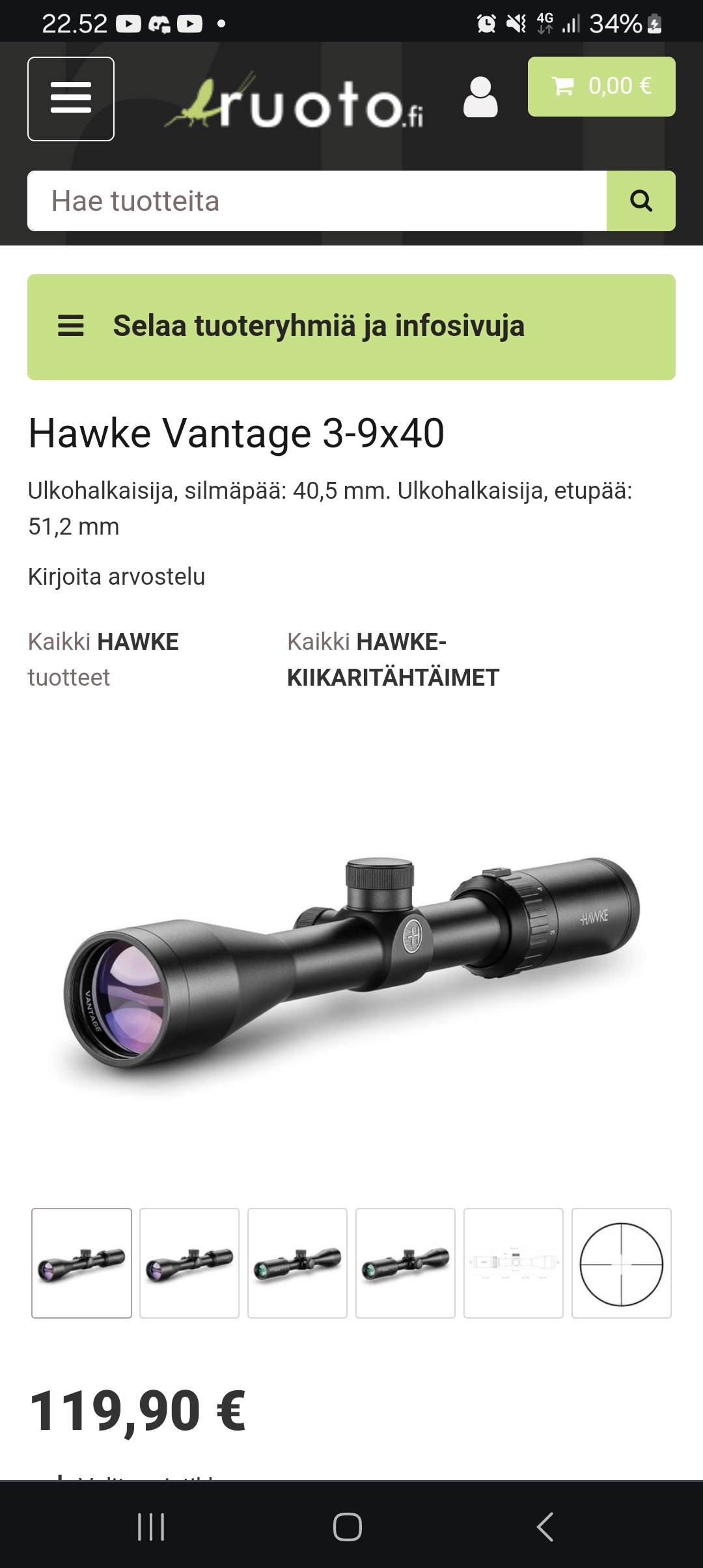

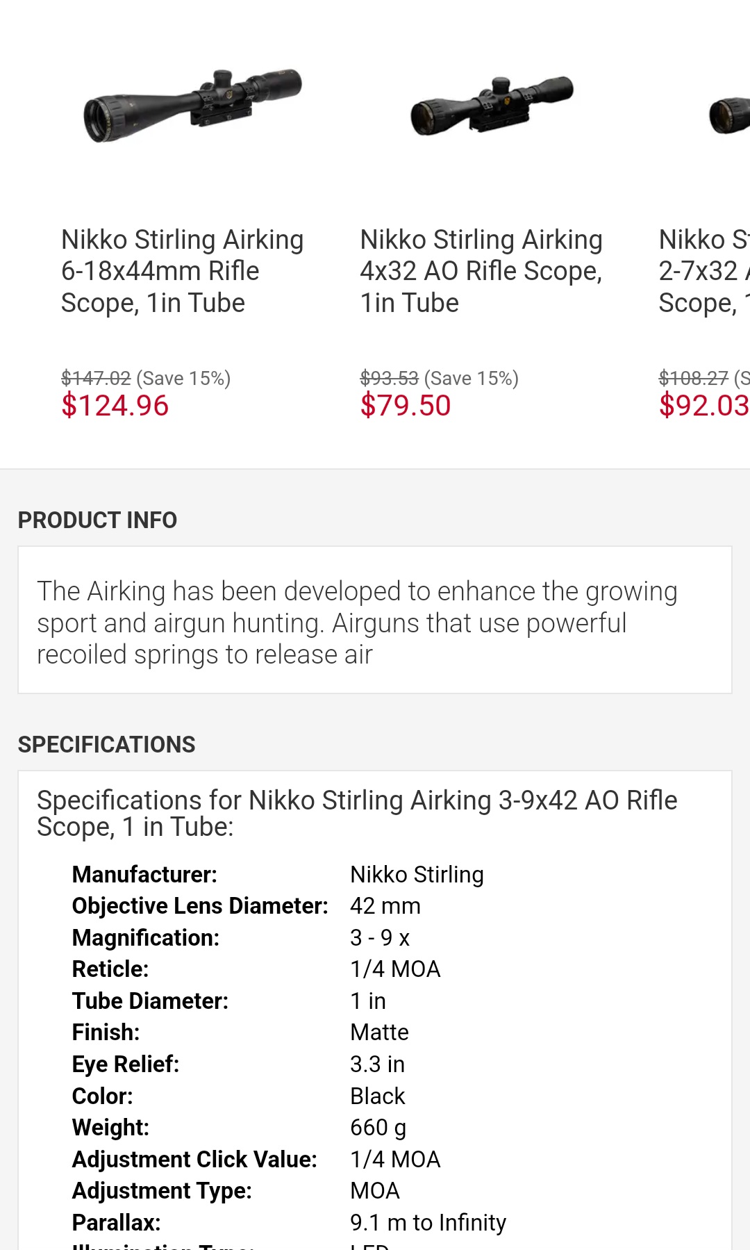

If I'm not too late, my HW90 (lowered to 18 bar pressure, approx 17 fpe) destroyed this Vantage after around 1000 rounds, even with Dampa mounts. Now trying a Nikko Airking with fingers crossed.
The Vantage is rated for 12 fpe springers. I've had good luck with the one I have as a shop mule. In fact two weeks ago it survived another 500 plus shots on a 13 fpe 22 hw50 I did for someone.
