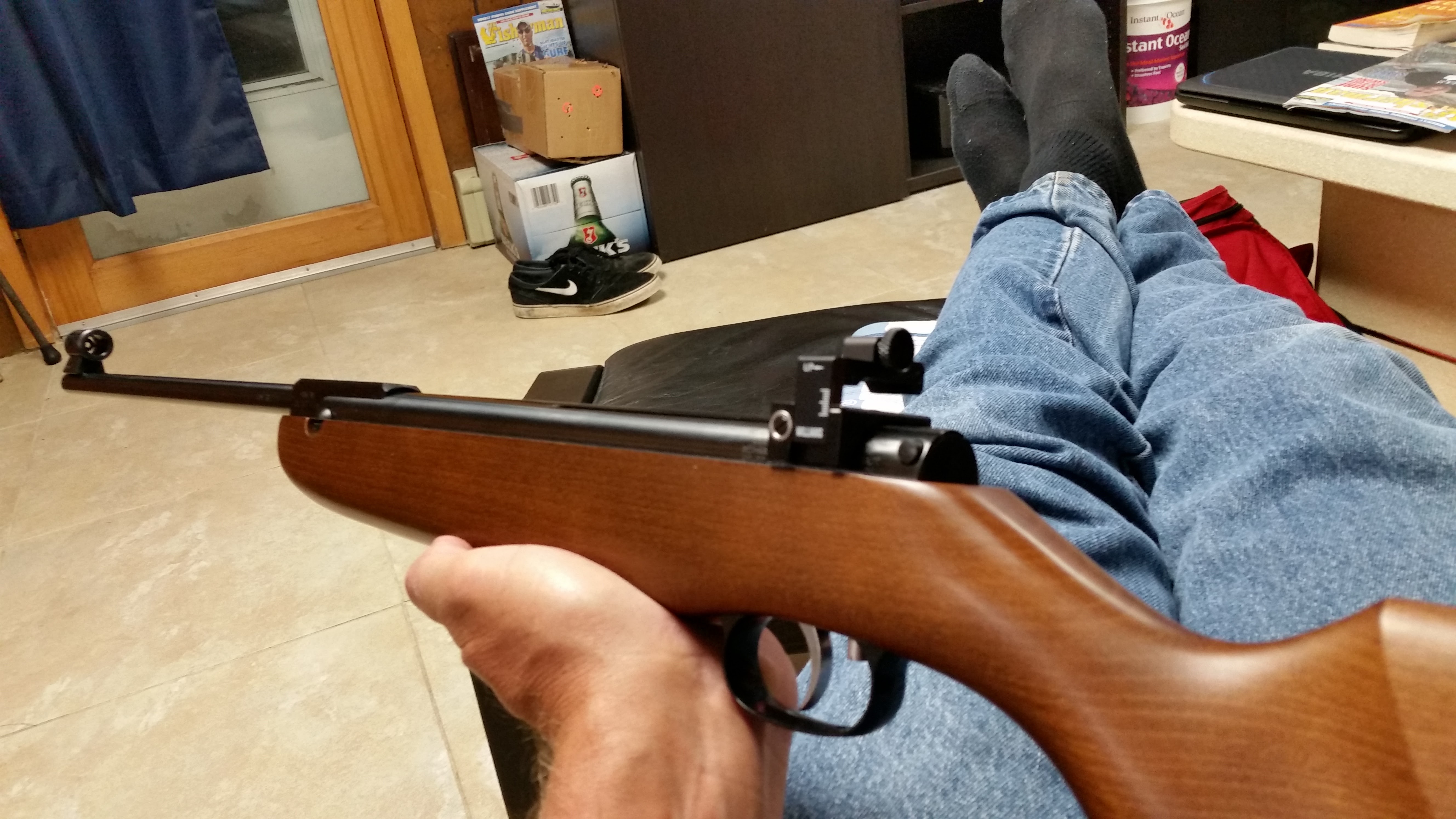

Currently I have a Williams peep sight on my HW30S which I thoroughly enjoy. I'll bet the BugBuster scope would be a slightly better fit on the HW30S over the HW50S due to the HW30S having a shorter length of pull, but the compact size of the HW30S is ideal and I love the handiness of the rifle with just the peep sight. I've just ordered a .050 low-light rear aperture for the Williams sight (included aperture is .093) based on recommendations from AGN users, should be a welcome addition to the sight.

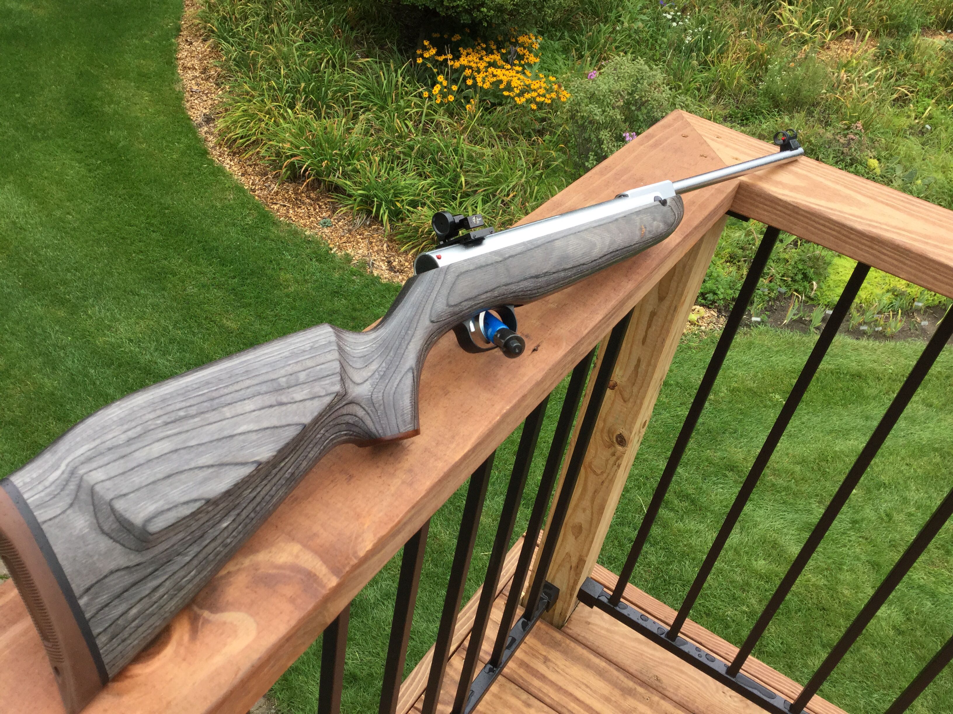

Personally I've moved away from the Williams and went to the Tech Sights. They're much more robust, easier to install and don't interfere with the safety. I also like the look, simplicity and aperture size. Here's a few pictures of the Williams and Tech Sights
Williams.
