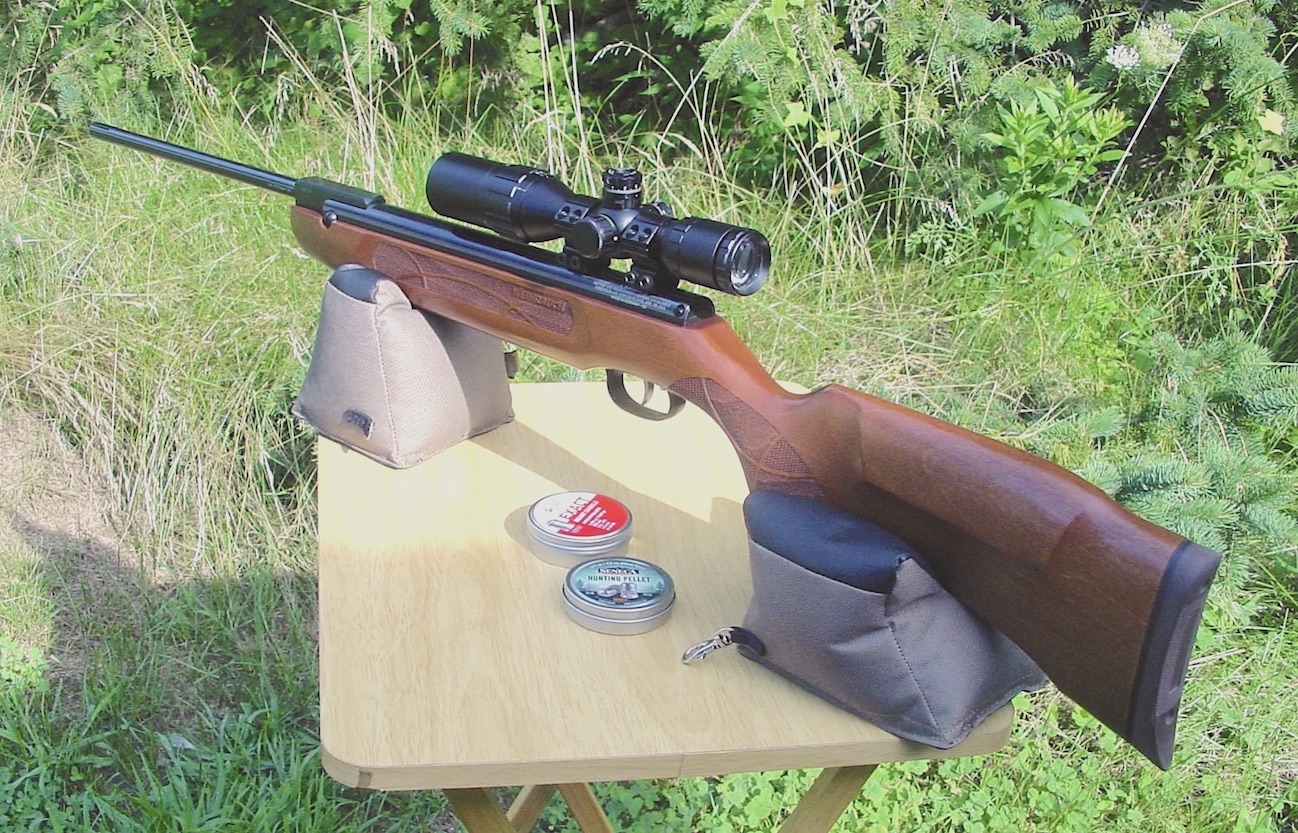

I've been shooting mine with a UTG Bug Buster 3-9x32 AO up top with no problems after 2000 plus rds. With Sportsmatch medium rings it sits good and low, and the recoil stop pin keeps it all in place. Nice and compact even with the sunshade.
