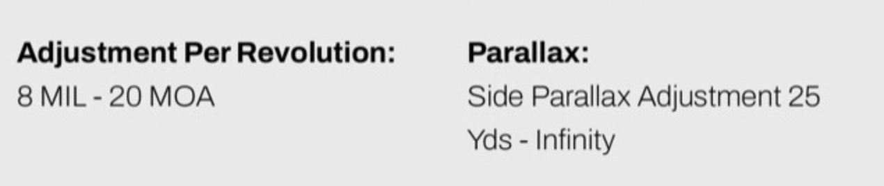

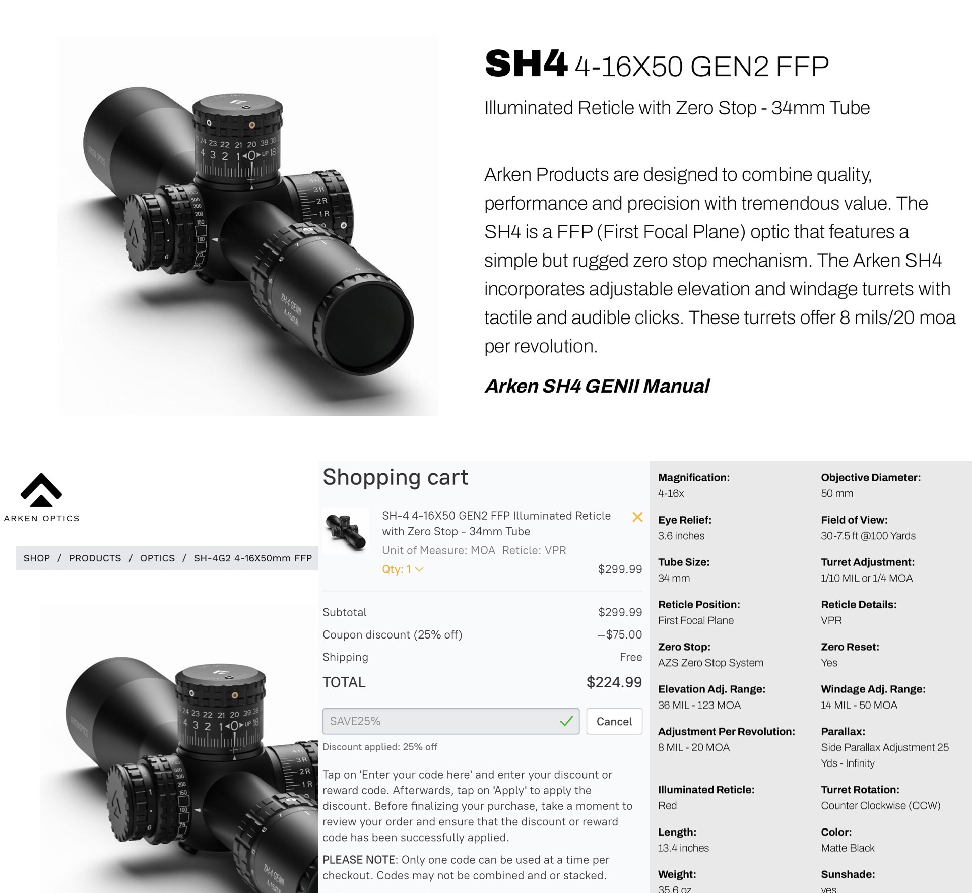

The Arken scopes are really good at a good price. They are large and quite heavy though.View attachment 394743
Hey Bear,
I would love to get an Arken scope, but don't they have a minimum focus of 25 Yards?
This is perfect for shooting at 25 yards +, but pretty limiting unless your a long range shooter ..... only.

Hey Bear,
This is why I posted the specifications. I think a 25 yard parallax is sufficient.

This is why I posted the specifications. I think a 25 yard parallax is sufficient. View attachment 394775
Yeah Bear,
I do most of my shooting in my 13 yd crawl space and need to focus closer than 25 yards. At the range or while camping 25 would probably be fine too.
Hence, I only buy scopes that focus down to 10 yards. I maybe in the minority.....
Reactions: Bear-of-Grayling
