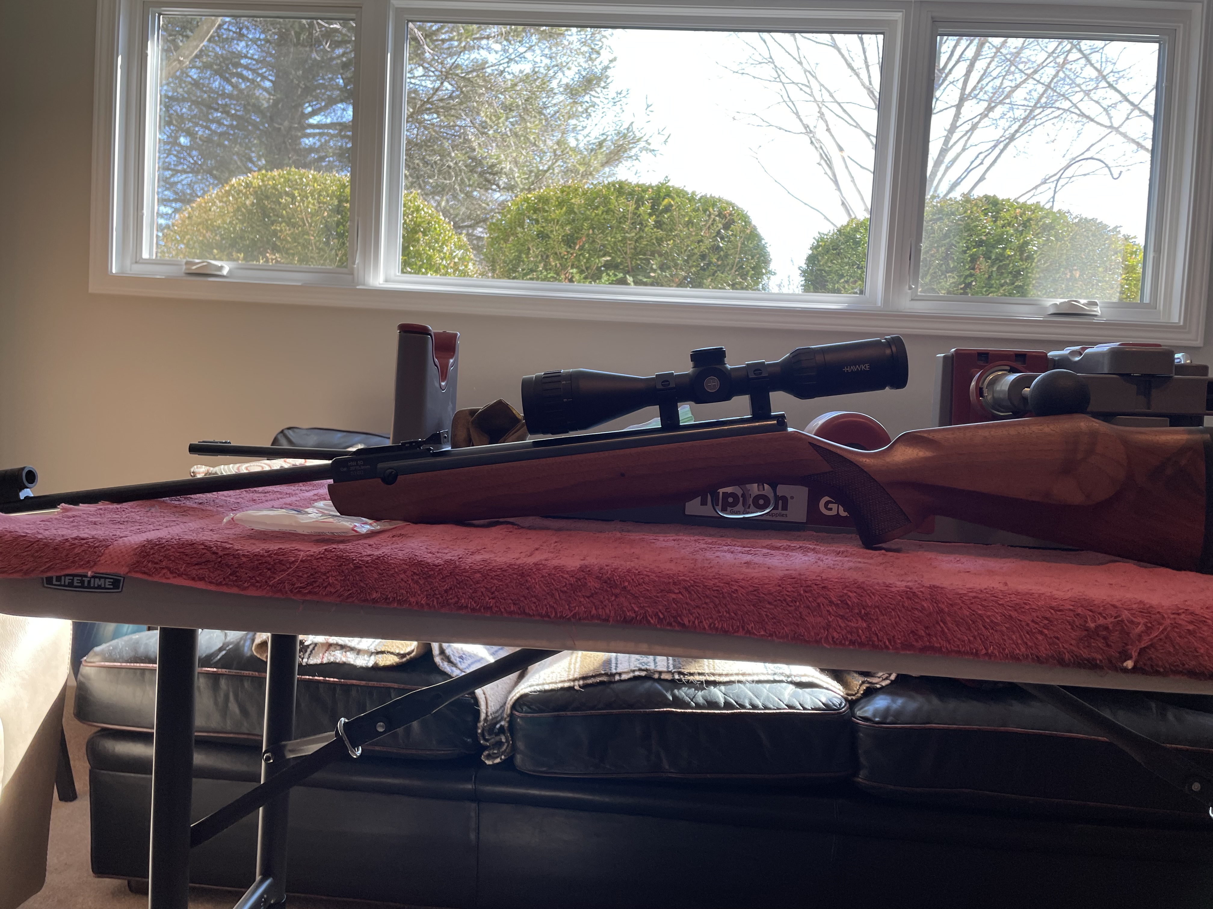

That will be a great scope for that rifle! I love it on mine, let us know what you think. This is mine in Sportsmatch T02C rings, hasnt moved yet. Sorry about the picture, im not very good at it.
