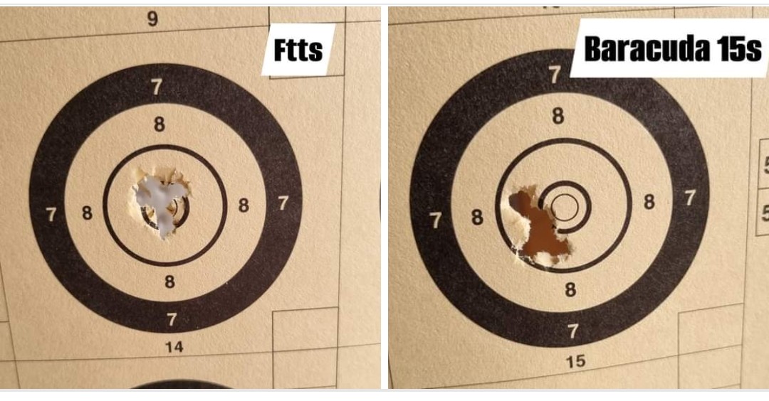

Did some pellet testing over the chronograph today with ftt and baracuda 15s i used the weight on the tins to calculate energy. Ftts were consistent and averaging 643.1 fps 13.47 fpe, The baracuda 15s averaged 580.8 fps 11.92 fpe. But no real POI shift.Every rifle spring is different. It really depends on how oversprung it is to begin with. It could be between 0 and pound and a half. With that pg4 kit I'd guess a little under a pound on the first coil cut.
I just checked my notes. I was wrong earlier about the output of that last 50 I did. It was 12.75 fpe with FTTs and 13.25 with SHPs. Sorry if I mislead you.
5 shot groups @ 25 meters
