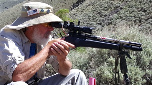

Many of us use the rifle scopes on our pistols with a modified Taco hold.
https://mrcompletely.blogspot.com/2006/06/taco-grip.html
Or we just shoot off of the bench. Either way rifle scopes can be your friend when combined with pistol shooting.

Cuz it's in the context of pistol field target. VERY VERY different shooting position than the normal, pistol at arms length, scenario. Most shots in pistol FT are taken from seated position. Two classes, one sits on a small bean bag and basically uses the knee to kinda help support the gun, no other assist devices. The other class sits on a small stool or bucket and rests the gun on shooting sticks. In either class, the eye relief is much more similar to shooting a rifle than shooting a pistol (in the regular sense of "shooting a pistol").
The above all leads me to the scope that I'm going to try out for the 1720T pistol I'm getting set up for FT: the MTC Viper Connect SL 3-12x32, which has a very short eye relief and a large field of view. It actually has a built in eye cup (of sorts) that can be extended. The eye relief is so short that that eye cup can be rested on the eyebrow, which I understand is allowed as an additional point of contact to aid in stability. The 32mm lens size might make ranging tough though, so we'll see I guess. Which is the other weird aspect of pistol field target: the scopes ability to focus on an object is used as a rangefinding mechanism.

Thank you for explaining it for me. I've looked up the "TACO" hold, that and also Motorheads image, shows exactly what I was missing. As the only scoped pistols I've owned are in .44magnum, .454 Casull, maybe you can imagine my confusion! No way is the taco hold going to work in that case. :)

Nobody I have ever seen shoots pistol the way you are imagining at FT matches, that is, with gun held at arms length, and perhaps with one hand. They sit crosslegged or on a low stool off a bipod, and shoot the same way as the Field Target rifles do, but without the extra aid of a buttstock, its fun, but pretty specialized, with teeny targets that require precision and wind-doping skills.

Ripper, Biohazardman, Franklin,
Learn something new every day.
Back in the Day, I did shoot a Desert Eagle in .357 mag using the “taco hold” and a forward, high mounted red-dot … ok scores, but not so good as my Thompson Center in .32H&R mag. We shot “hunter pistol” NRA Silhouette back then.
Motorhead is not using a “Taco Hold” in that picture. Taco Hold entails holding the gun away from the chest somewhat, with non-trigger hand holding the scope bell from over the top in a sortof cantelever position for the support hand, which does not brace against the body. It keeps barrel heat from the support hand and allows a steady offhand hold. The scope is normally quite high and forward over the barrel, allowing the thumb to wrap under the scope bell. The eyepiece is normally not farther to the rear than the web of the shooter’s grip hand.
Surprisingly, a very tall scope held this way can allow even .44 mags to work ok offhand with the gun that near the face, since the gun is so much lower and the recoil is directed up rather than rearward due to the pivoting at the wrist.
But enough powder burner talk. The same hold can work well with an airpistol if the mount is higher, and it seem sgteadier toi me … but you may need a little built in droop for the mount to ease holder for the very close shots.
