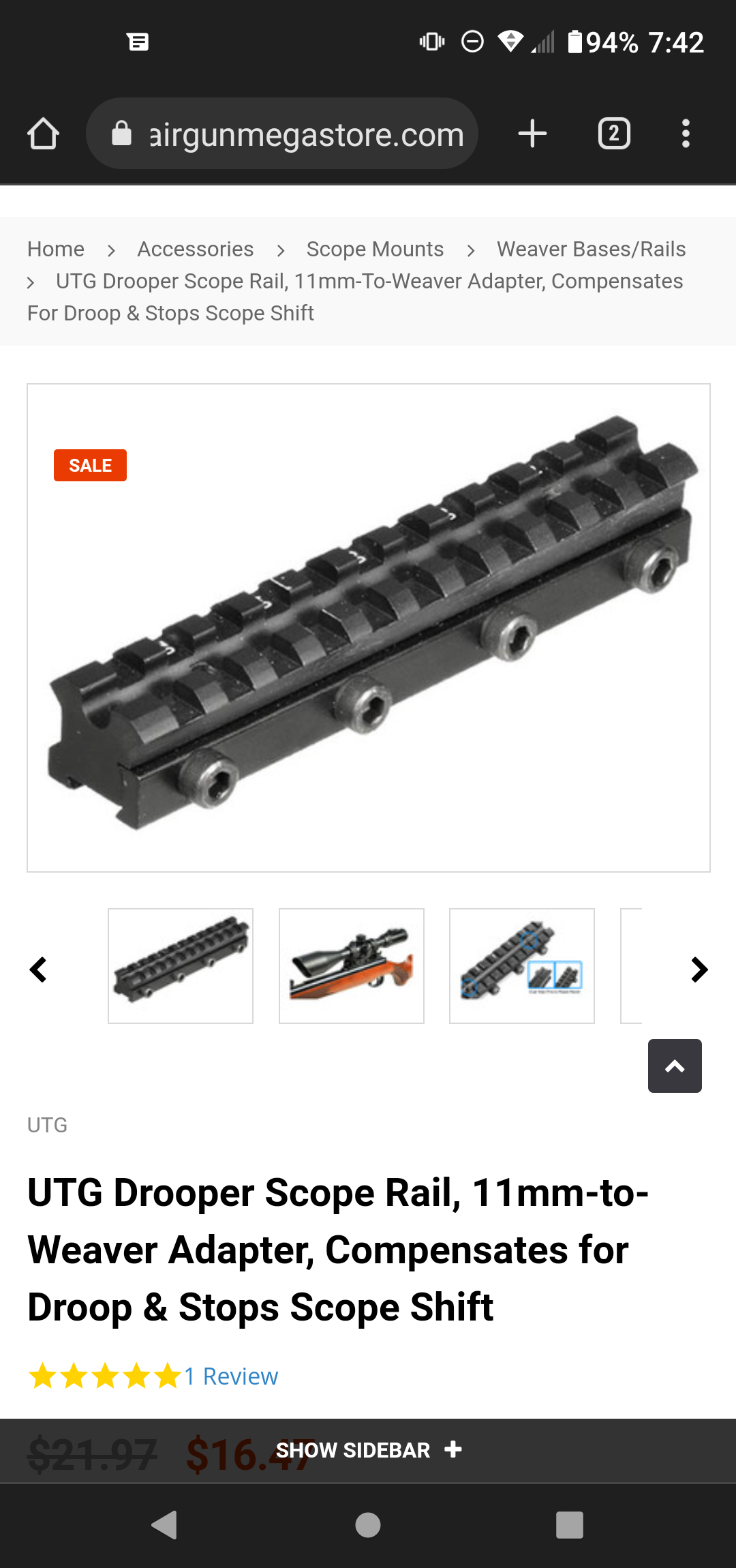

I actually found a slanted dovetail to picatinny rail,(attached picture)
It doesn't give me any real adjustment like adjustable scope rings would, but it would fit the one piece mounting style scope I have now.
I could give it a try, or just get adjustable scope rings ,a better scope and call it a day👍
