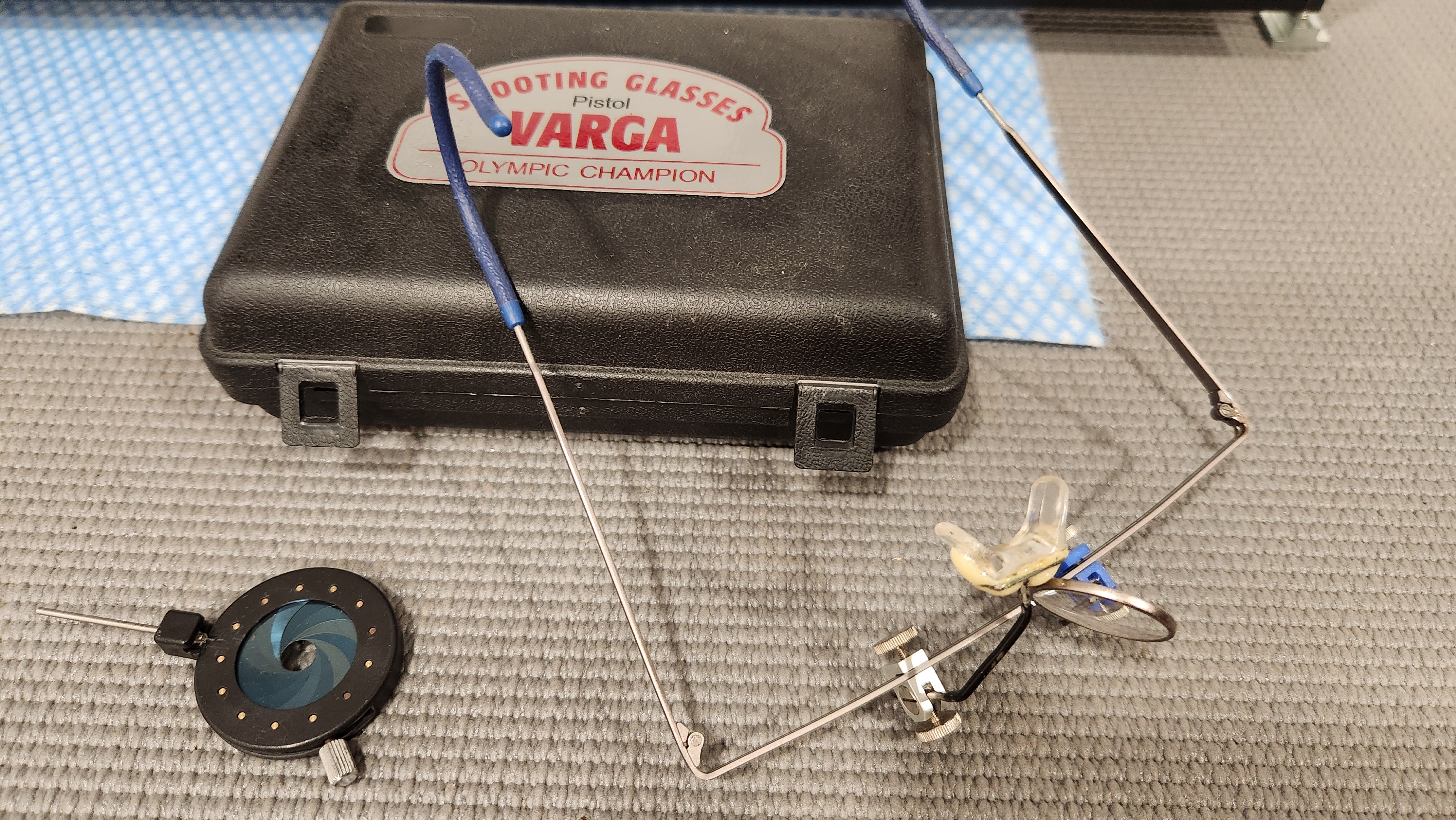

...one eyed glasses ?
You see this is a valid idea.
I was using shooting glasses along my years when I was competing archery. I still have couple deep in my drawers somewhere in the basement.
I will swap sides, I needed earlier in front of right eye to see through a peep, but now I would need in front of left eye to see the bubble.
Edit: I found it
I would need to play with it if I could adjust for both eye view and usable for bubble as well. May work on my L2 for close combat actions ;)

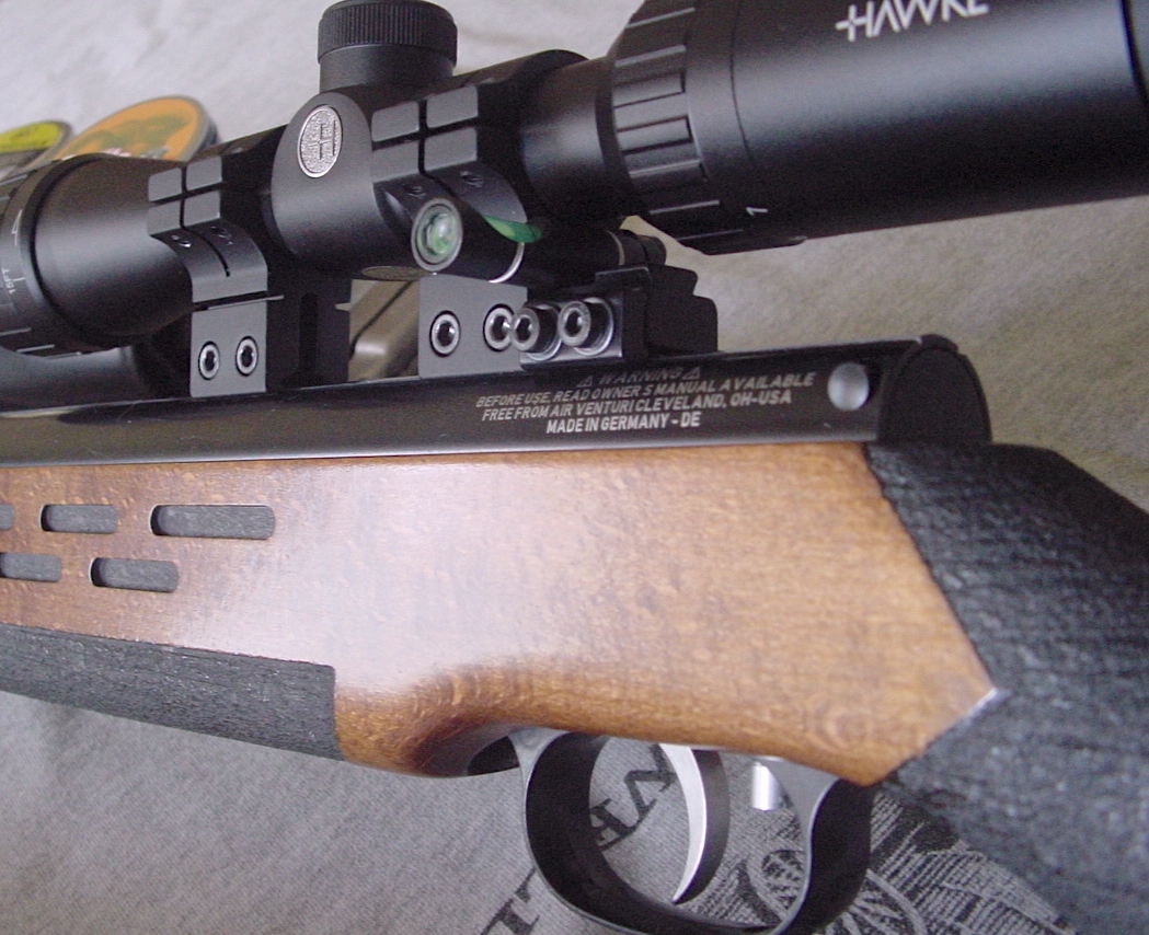

This is an odd combo, but it worked for my application. Cost around $35 total. I mounted a Sportsmatch recoil stop block on my HW98, and clamped a Hawke level on top of it. Fits perfectly under the scope, and I can observe level by opening my non-dominant eye without breaking cheek weld or focus through the scope. The size of the bubble and the milled reference line make it easy to see and adjust accordingly.
