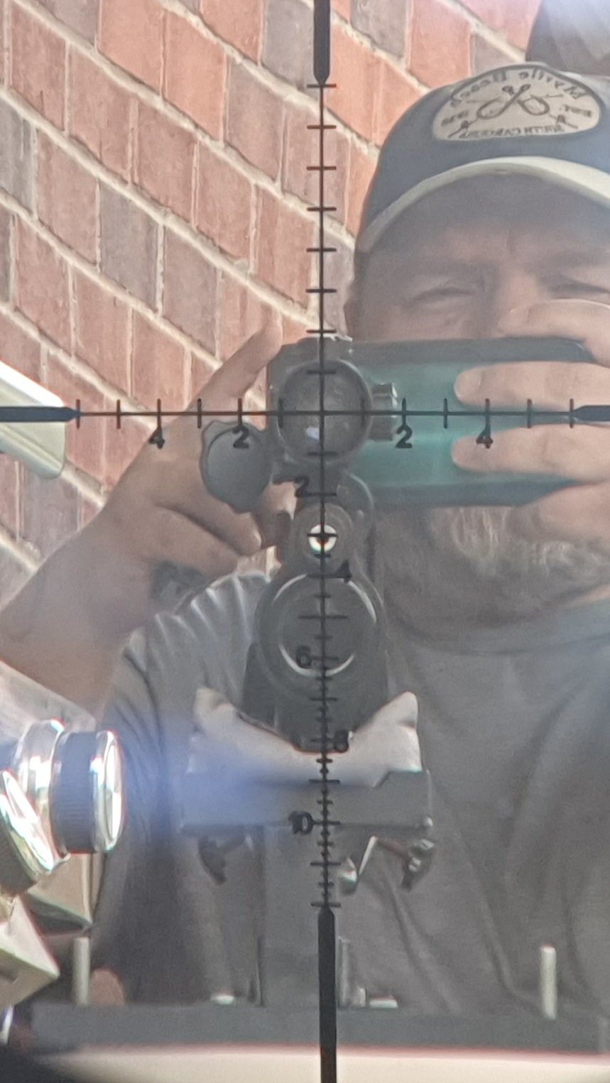

but the mirror method as described above will.

fyi,no levels need to be involved in aligning the crosshairs to the bore.

i say an experiment is in order,
maybe you should take the mirror method test.
its really simple if you do as i mentioned above.
if it doesnt look like this then youre already setup to fix it properly..

Credit to Scott Hull (@Scotchmo) for introducing us to the mirror approach for aligning the reticle to the bore some years ago. It's one of those rare gunsmithing things where you need no special tools to achieve equal or better results than a purchased jig. And you do so by directly viewing the two things that matter--the reticle and the bore.
Having grown up around hunters and sport shooters, countless times I had seen them using levels to install a scope. So imagine my surprise to learn years later that levels are completely unnecessary to install a scope, and in fact will only yield a properly aligned scope if about a dozen assumptions about the perfectness of the gun and rings and scope happen to be true.
I think the common phrase "leveling a scope" is part of the problem. The only leveling we need to do is after the scope is installed and we are actually shooting. When we are installing the scope, what we are really doing is leveling the scope aligning the scope...or more specifically, aligning the reticle to the bore.

The mirror method is the best way to accurately mount a scope that I know of. And once the scope is mounted properly, using a plumb line is an easy and efficient and accurate way to mount a bubble level on that scope.
The problems you had, had nothing to do with the mirror method of mounting a scope or the plumb line method of mounting a level.
